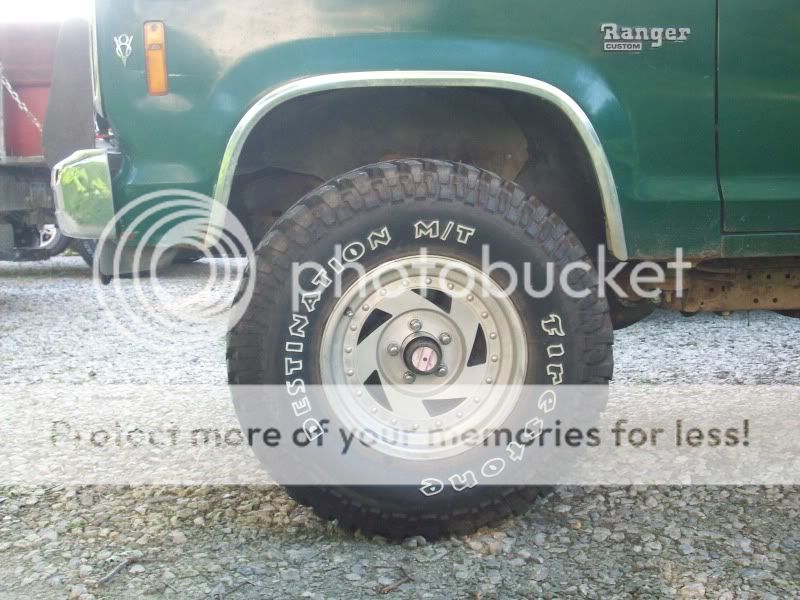

question about my tires

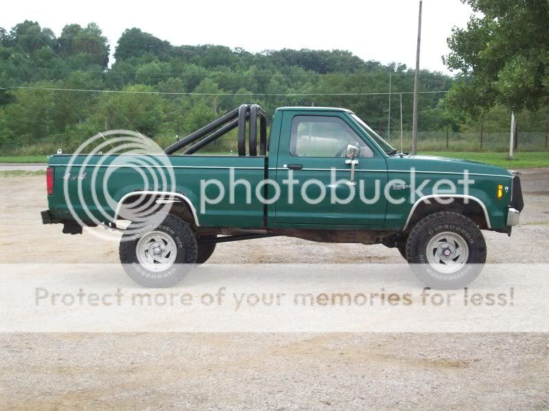

They will not fit on a stock first generation 4wd.
With a 3" bodylift and brand new Explorer front springs mine rubs on the DS over two bumps I have found around town. One is the washed out driveway at work from one direction only and the other was when the city left about a foot of space between their new asphalt and the curb in front of a parts store. Both are exceptionally nasty bumps. Going slowly it will not rub.

The wheel is slightly turned too...

For a stock truck that will stay that way, I recommend 235/75-15's. They fill the wheel wells very nicely.
