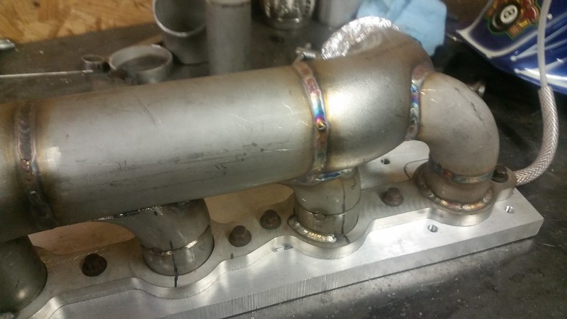

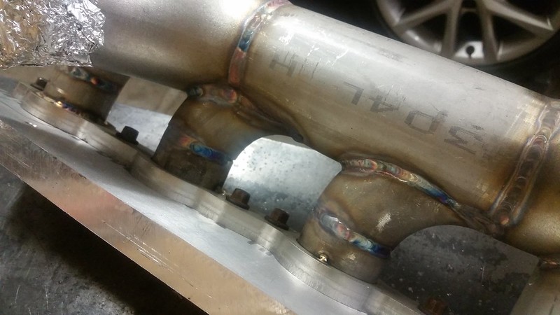

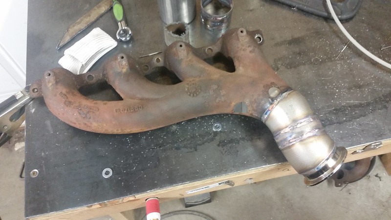

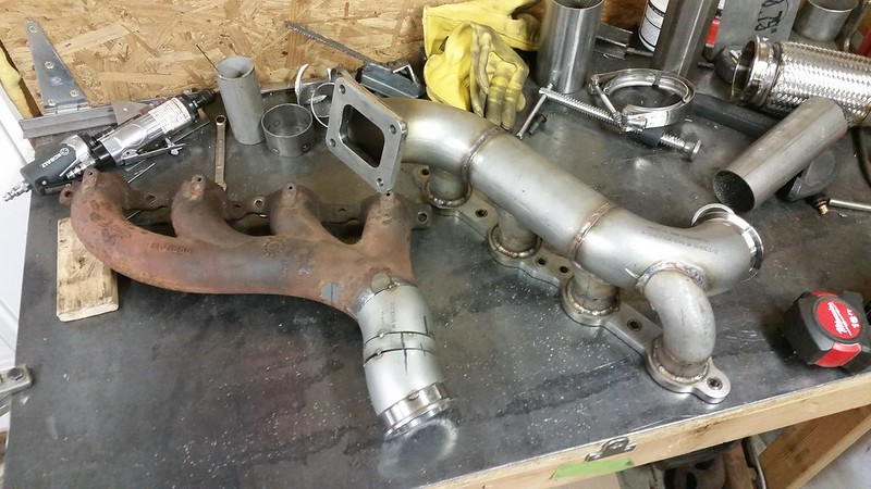

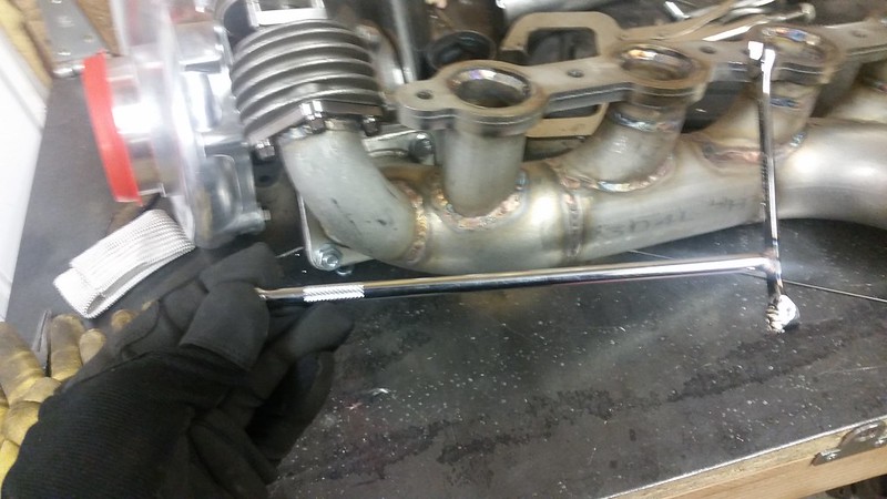

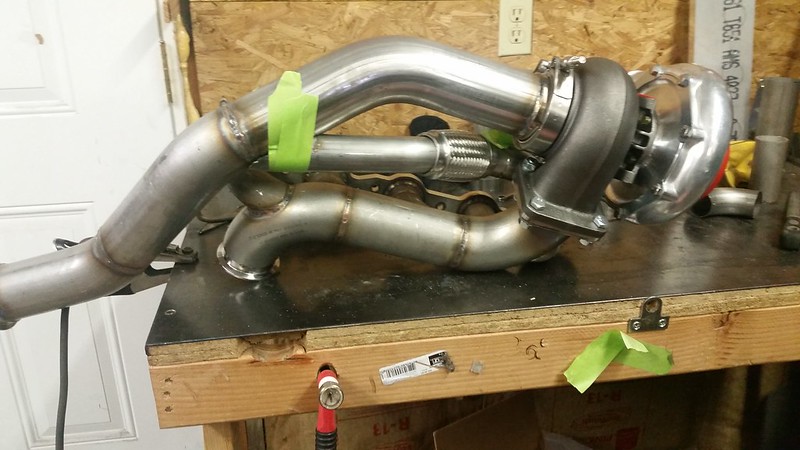

Had a 2 week work thing but now back to the build! Got the manifold weelded up today and with the chill block i made came out pretty damn straight except the t4 flange as i did a bit too much per weld... oh well pretty easier to surface that flange than the header side.
20170813_153100 by Z S, on Flickr
20170813_153114 by Z S, on Flickr

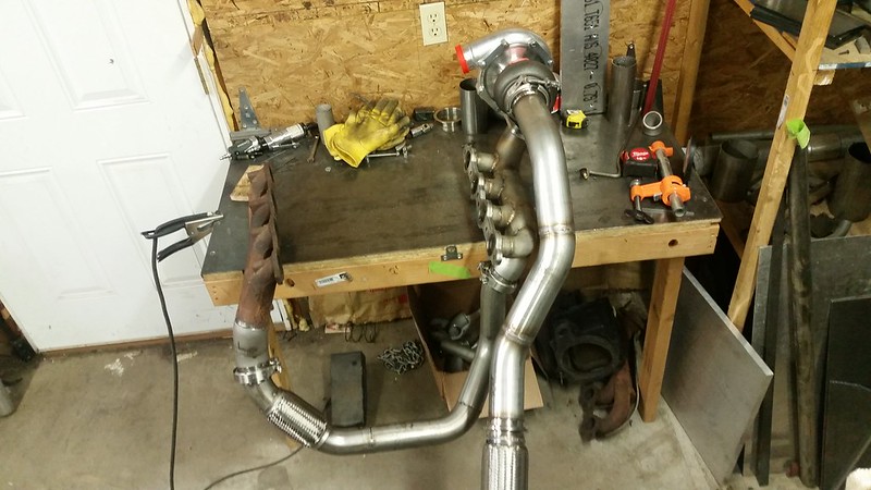

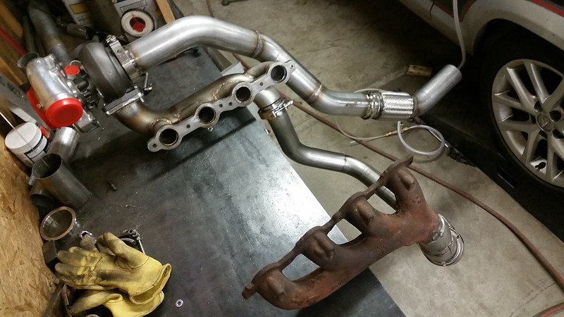

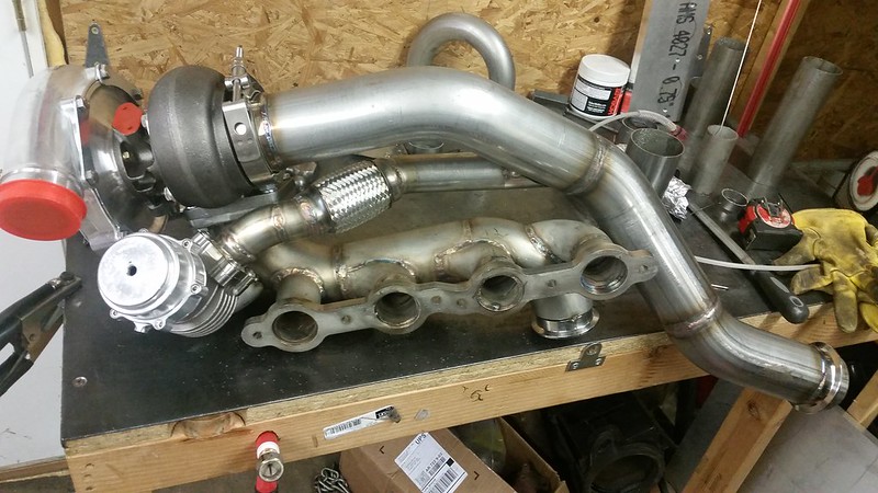

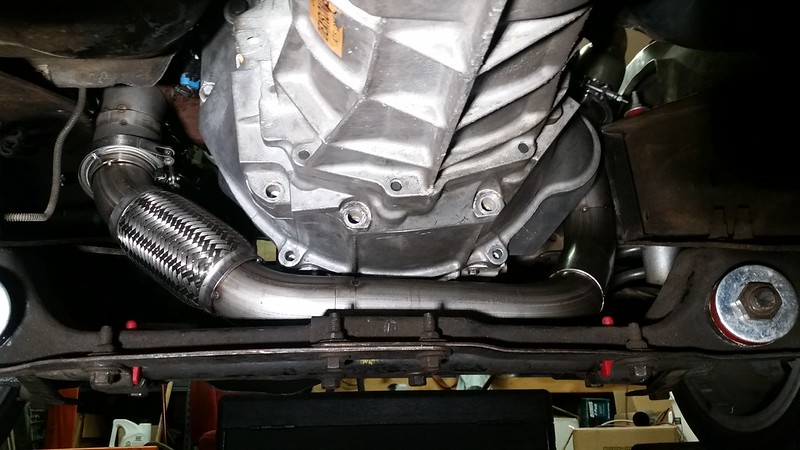

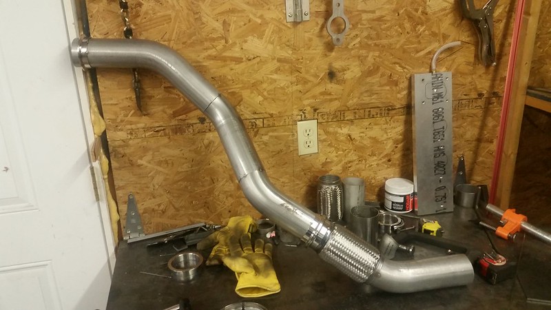

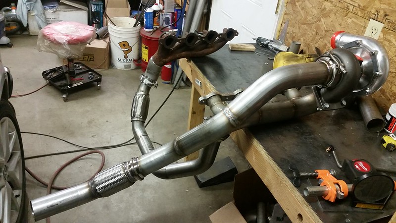

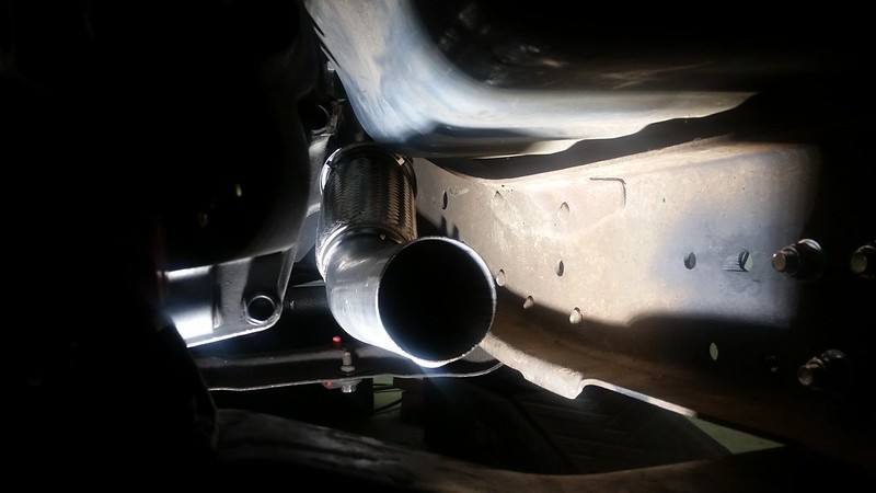

And I had a few extra 3" bends from my last project so went ahead and made the downpipe and front portion of the rest of the exhaust. its just tacked today and i plan to weld it up this week.
20170813_191759 by Z S, on Flickr
20170813_192347 by Z S, on Flickr
20170813_192509 by Z S, on Flickr
20170813_192523 by Z S, on Flickr
20170813_192530 by Z S, on Flickr
20170813_192540 by Z S, on Flickr
20170813_192644 by Z S, on Flickr
Hope to have the crossover pipe made this week and do the cold side next weekend. After that i feel it'll really start coming together. Im sure the wiring and dash will take a bit though too....

And had a mid week day off, so got the passenger side and crossover tacked up and ready for welding.
20170816_213413 by Z S, on Flickr
20170816_214038 by Z S, on Flickr
20170816_214013 by Z S, on Flickr
20170816_213930 by Z S, on Flickr

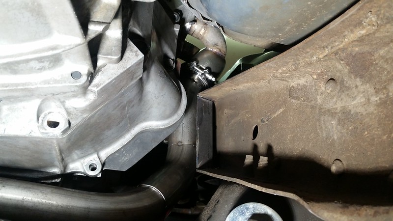

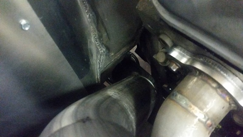

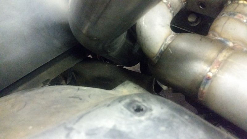

And then the clearance once installed, it isnt much but should be a problem.
20170816_212728 by Z S, on Flickr
20170816_212632 by Z S, on Flickr
20170816_212507 by Z S, on Flickr
Probably weld up the crossover and some other odds and ends tonight and may start the wastegate tomorrow but im still not sure if im going to use what i have or get a different one. I have a 46mm tial 4 bolt flange but V-bands are so easy i may swap to a 44-46 tial or precision gate.

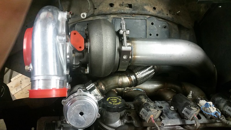

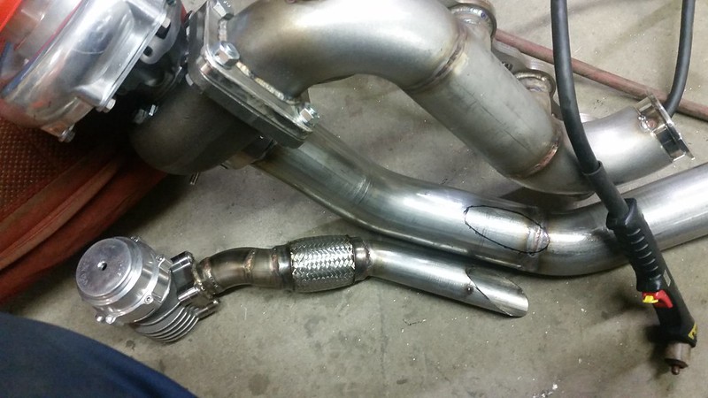

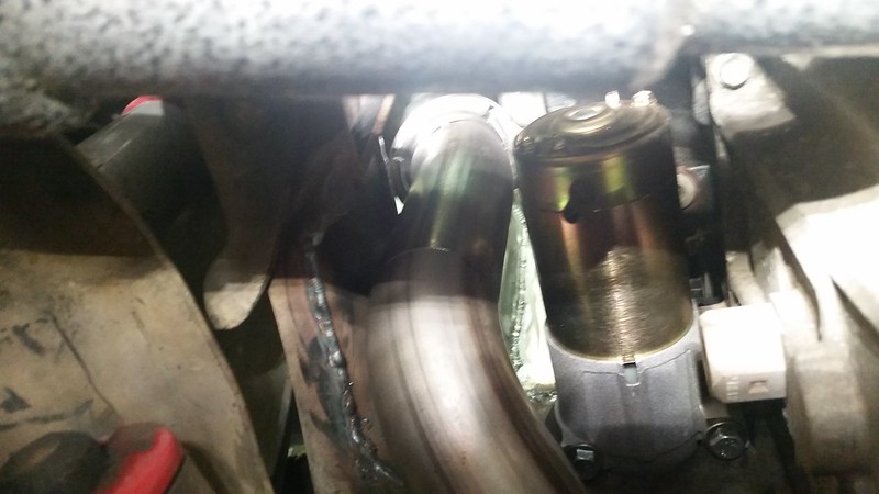

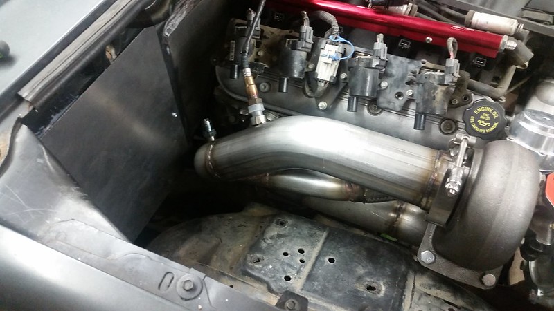

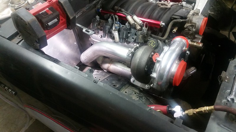

Got the wastegate mocked and welded in. It would have been way easier with a v-band gate but i had this laying around so i need to get a flexible 10mm socket to actually mount the bolts though.
20170820_150409 by Z S, on Flickr
20170820_163239 by Z S, on Flickr
20170820_170906 by Z S, on Flickr

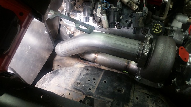

and mounted, its a tight fit but looks like all the lines for the heater core and A/C will all clear without issues too.
20170820_201044 by Z S, on Flickr

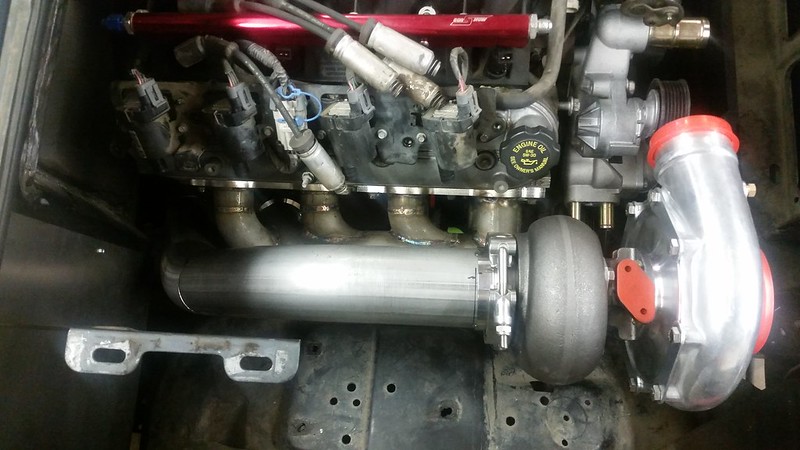

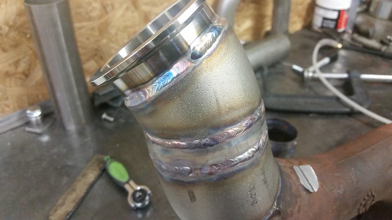

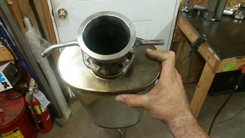

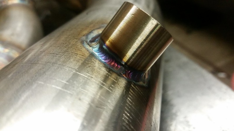

OK small update, Added the wideband and crankcase scavenge bungs to the down pipe and finished welding up the passenger side manifold. Starting to look like i can weld on some of these.
20170822_193429 by Z S, on Flickr
20170822_213226 by Z S, on Flickr
20170827_143816 by Z S, on Flickr
20170827_143919 by Z S, on Flickr

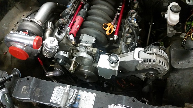

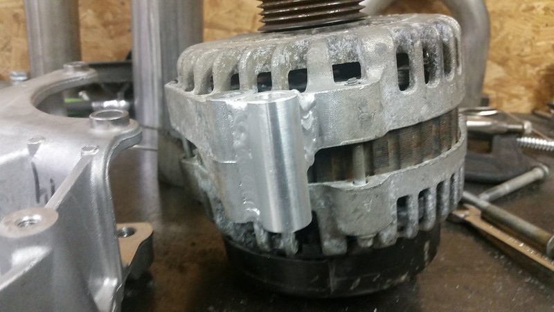

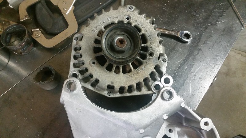

Since i was waiting on the rest of the exhaust parts I moved on to making the truck alternator work with the vette accessories bracket. it was cheaper than buying a new alternator.
20170827_161429 by Z S, on Flickr
20170827_190253 by Z S, on Flickr
20170827_190233 by Z S, on Flickr

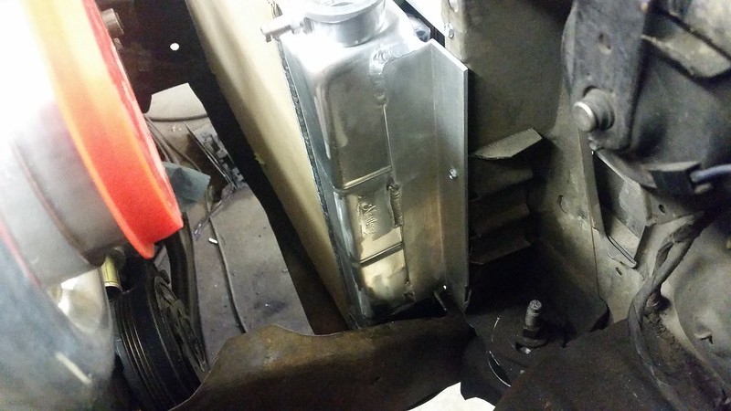

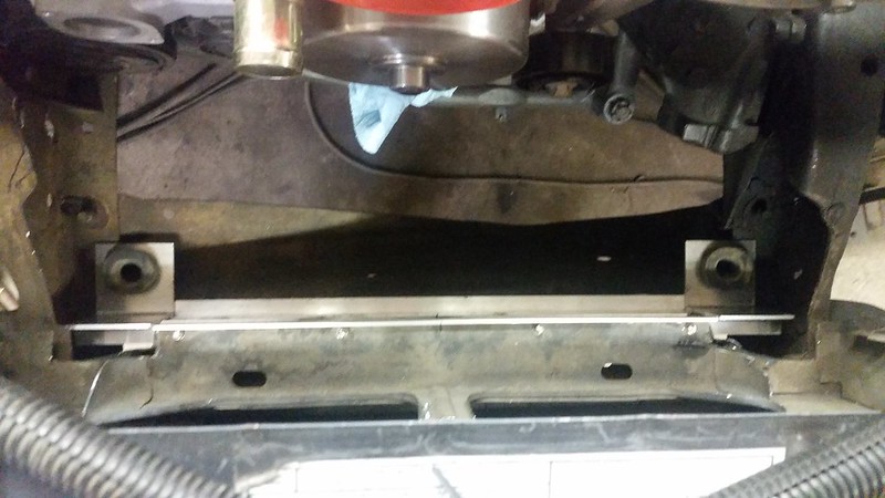

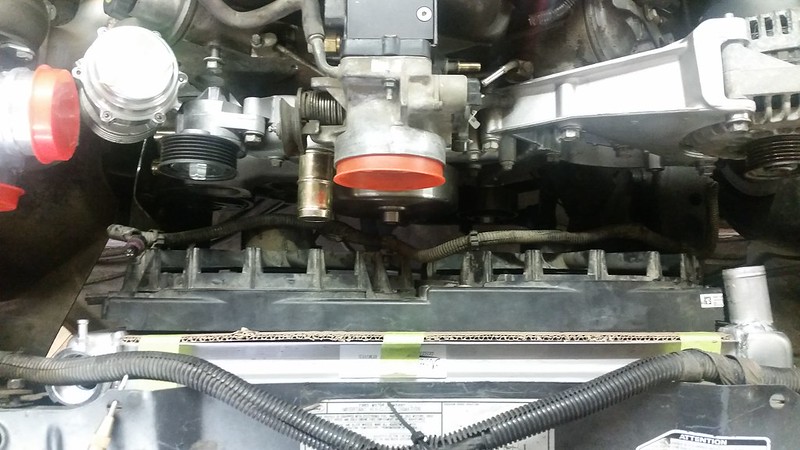

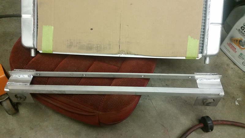

And then on to the radiator, A/C Condenser, Intercooler fitment.
20170828_185939 by Z S, on Flickr
20170901_185347 by Z S, on Flickr
20170901_184506 by Z S, on Flickr
20170902_190012 by Z S, on Flickr
20170901_184125 by Z S, on Flickr

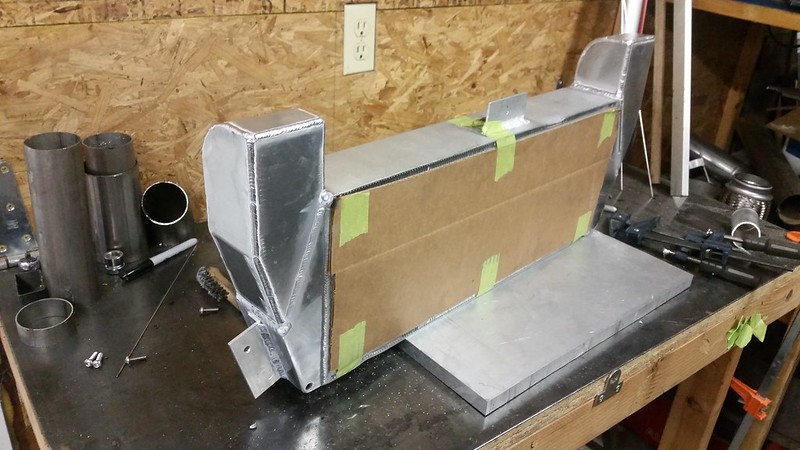

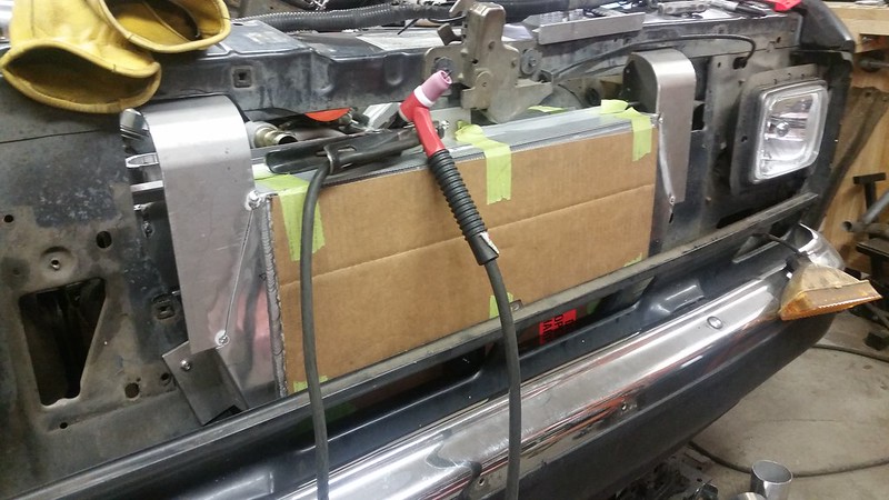

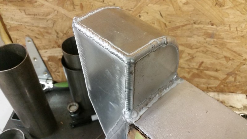

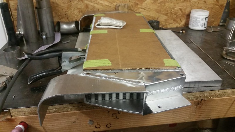

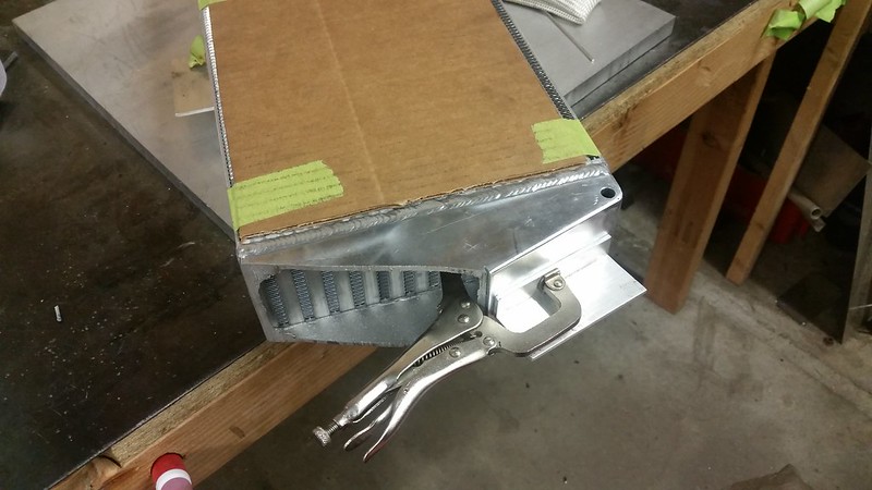

Started on the intercooler as well.
20170903_142931 by Z S, on Flickr
20170903_201310 by Z S, on Flickr
20170903_195818 by Z S, on Flickr
Plenty of work still to do though, starting to get excited as most of the systems are nearing completion ant then itll be on to minor paint and assembly. just need more time to work on it.

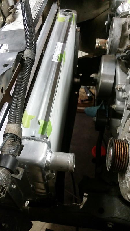

Ok, so got the radiator inlet and outlet relocated so it will all work together. I think the lower rad house may end up going through the frame rail or under it as there is just no more room... we shall see though.

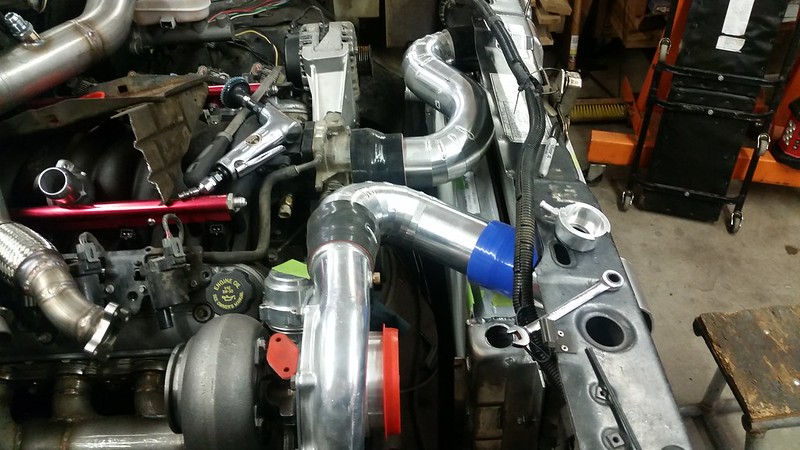

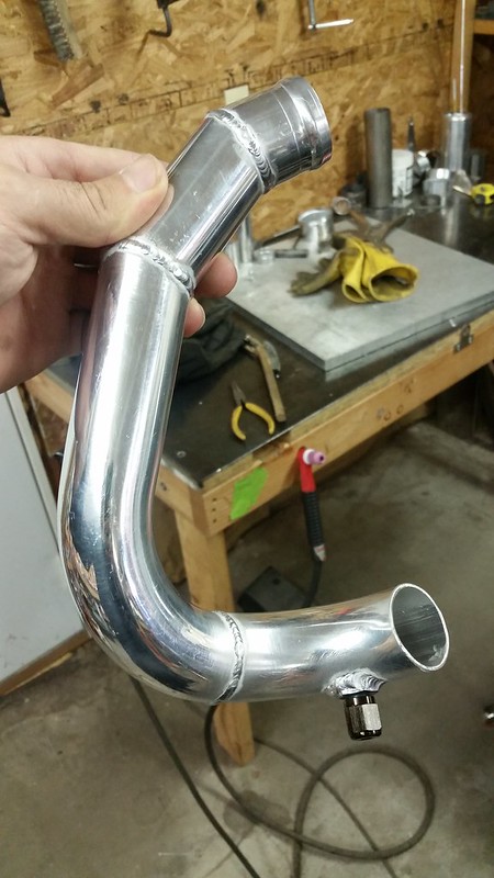

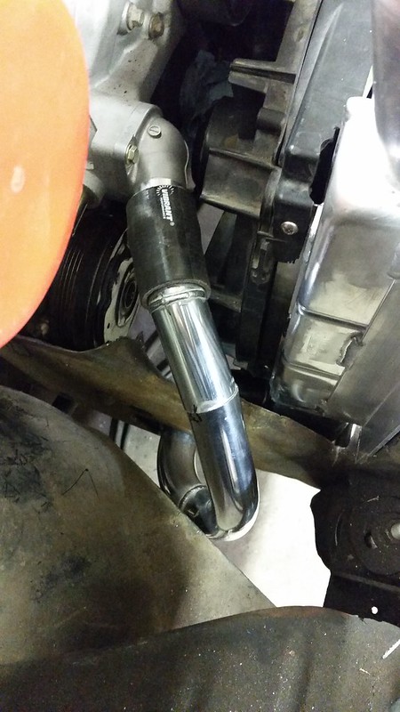

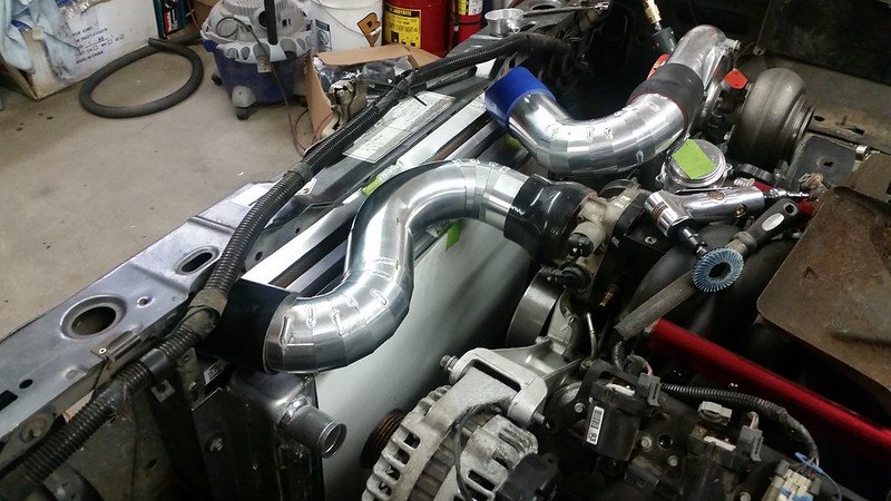

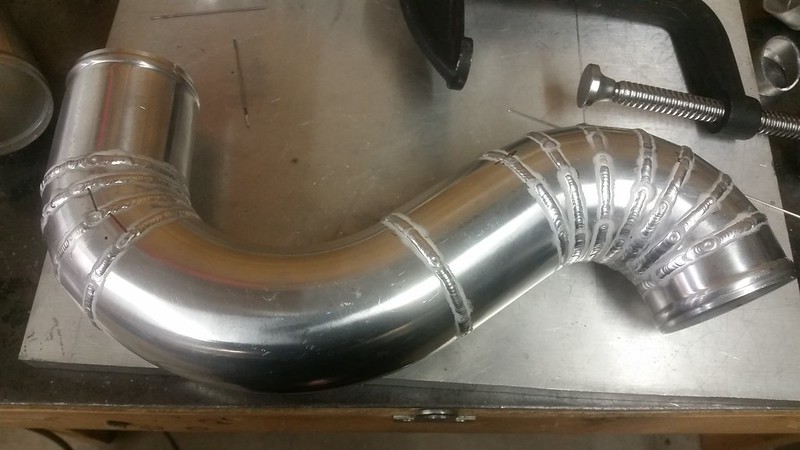

ANd then got back to the intercooler and charge pipes. THey came out pretty good i think.
20170909_180955 by Z S, on Flickr
20170909_181035 by Z S, on Flickr
20170910_151642 by Z S, on Flickr
20170910_151628 by Z S, on Flickr
ANd the overhead shot, still need to weld it all up but after tall the pie and fit i was done for the day. want to do the radiator pipe the same style but ill have to reconvene on that though cause i melted the smaller pipe pretty bad and need a new 1.5" tube to remake one.
20170910_151615 by Z S, on Flickr
Z

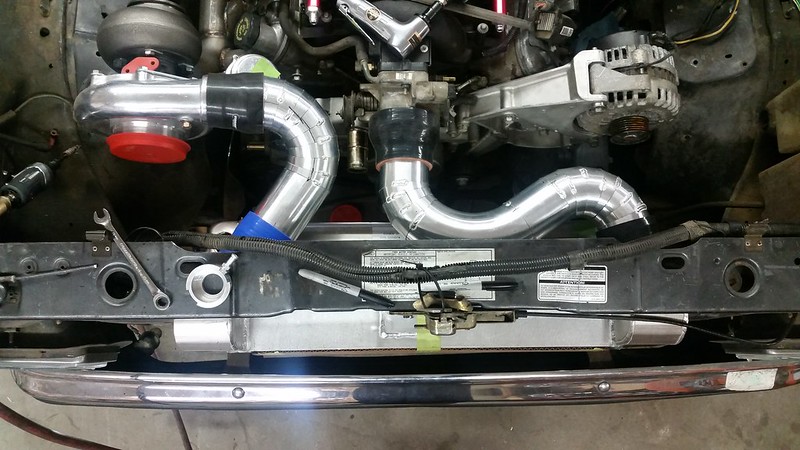

little update.

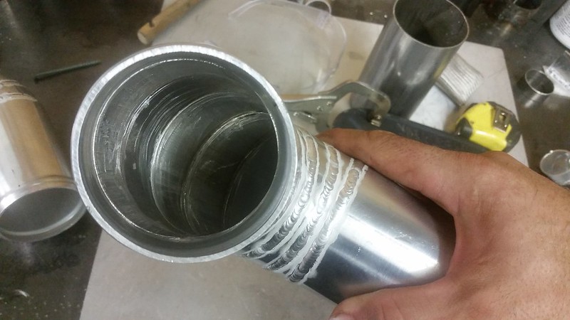

Finished the charge pipes welding. came out pretty decent, think itll look better if i get them powdercoated later.
20170918_194217 by Z S, on Flickr
20170918_194252 by Z S, on Flickr

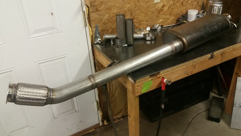

And fabed up most of the rest of the exhaust. currently ends at the back of the cab w/ a V-band. For now ill probably through on a turndown till its operational. After that ill fab up the bedside exit from 3" to dual 2 1/2" out the pass side just before the rear tire out the bed.

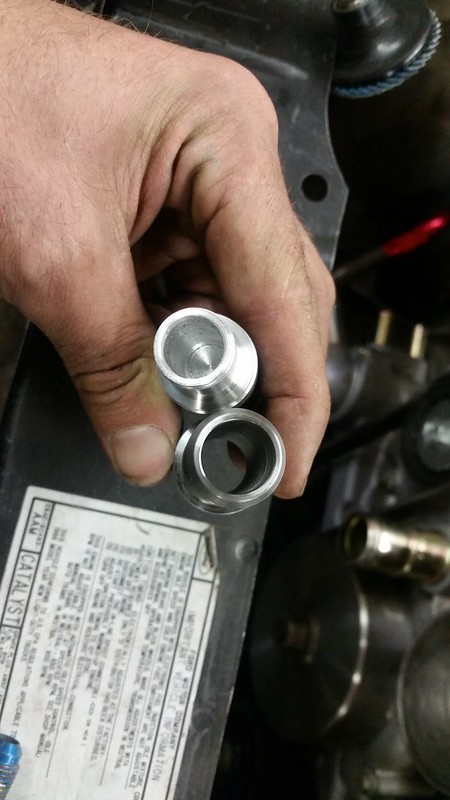

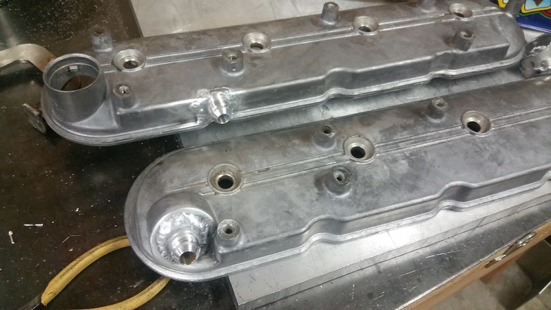

And for crank case evap I will be doing a vibrant exhaust scavange setup through a catch can. So the valve covers got dual -8an. had the wrong settings so its not pretty but they are on there. may redo them later if someone wants some these local to me.
20170920_200504 by Z S, on Flickr

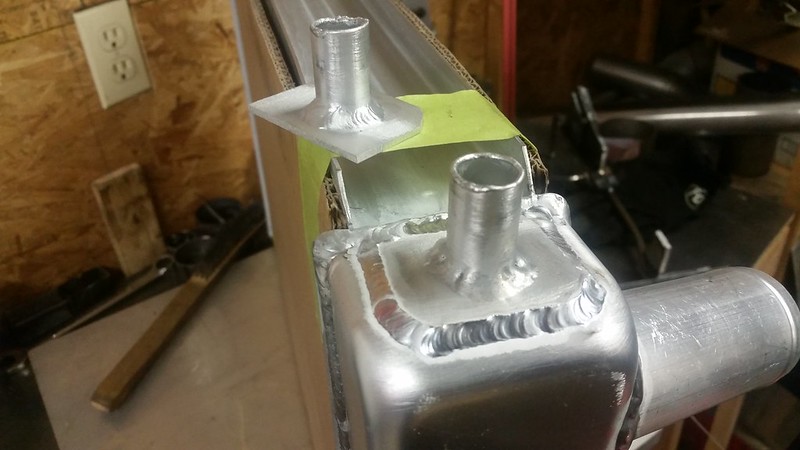

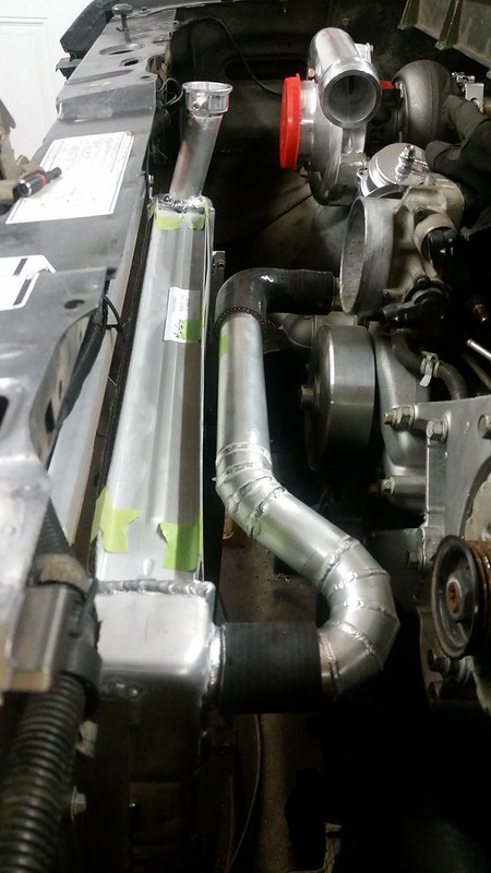

Then to finish the radiator and inlet outlets. Here is the outlet as the LSX is a reverse flow through the stat. Also the final radiator fill.
20170925_200726 by Z S, on Flickr

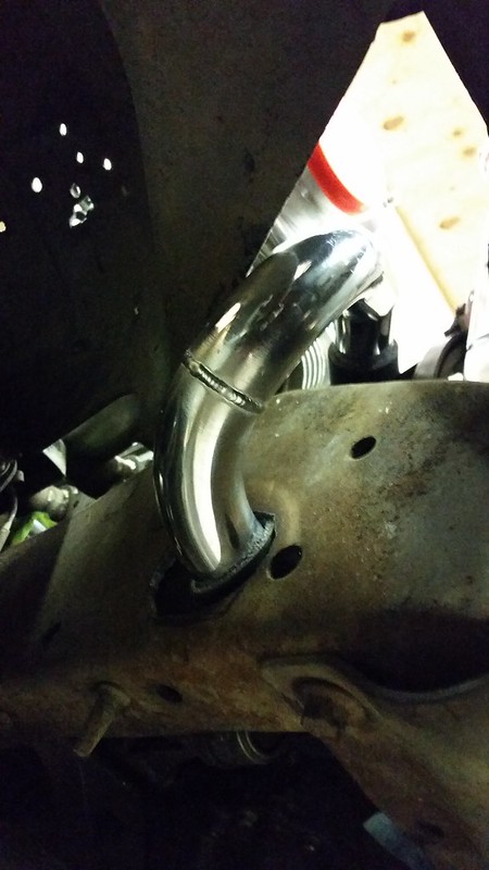

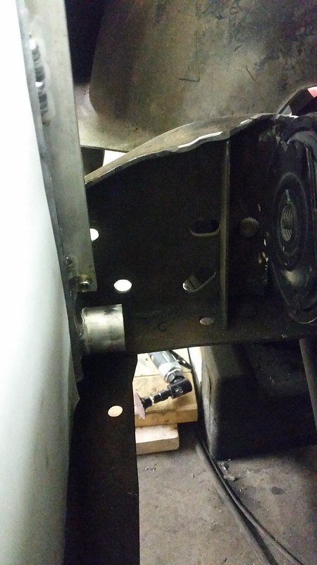

ANd the lower rad pipe which is the inlet. Yes it does go through the frame as there really was no where else with enough room to be able to remove it.
20170926_193919 by Z S, on Flickr
20170926_193946 by Z S, on Flickr

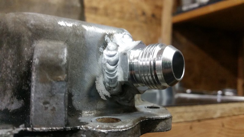

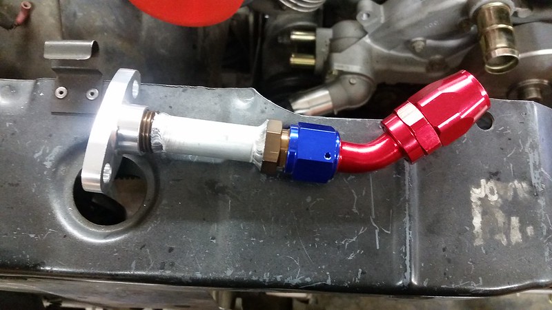

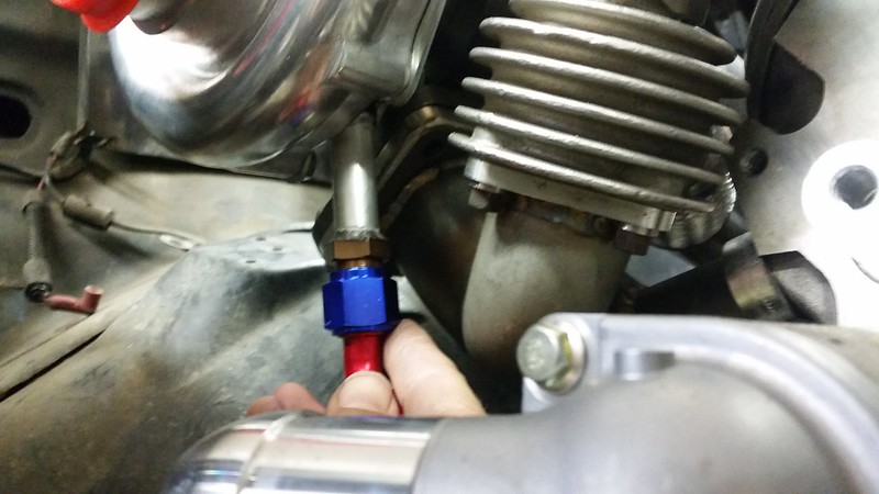

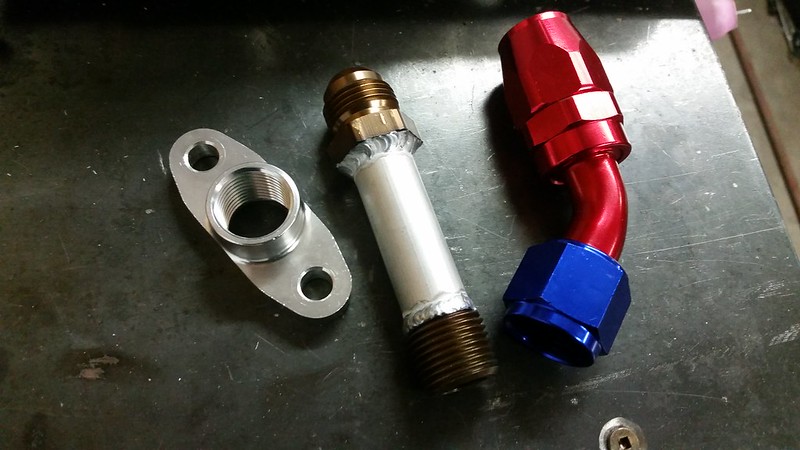

ANd then started on the turbo drain line setup. But the kit it came with didnt allow access to get the -10an fitting so I extended the fitting out a few inches to make it easy to work.
20170930_173824 by Z S, on Flickr
20170930_173950 by Z S, on Flickr
20170930_173937 by Z S, on Flickr

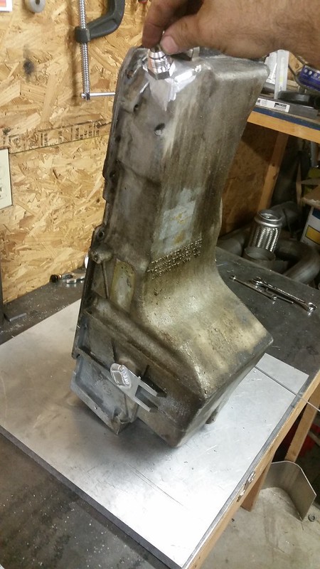

And the oil pan fitting to match. also closed off the oil level sensor since im not using the oem ecu.

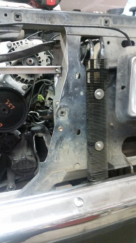

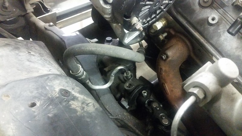

Then on to the power steering setup. Snagged a silverado cooler that i modded the lines and bolts behind the grill. makes running lines super easy.
20171008_150254 by Z S, on Flickr

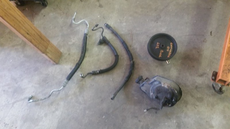

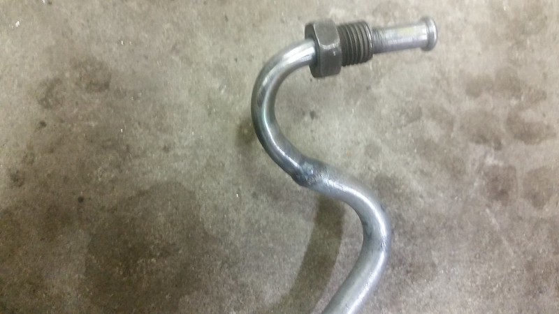

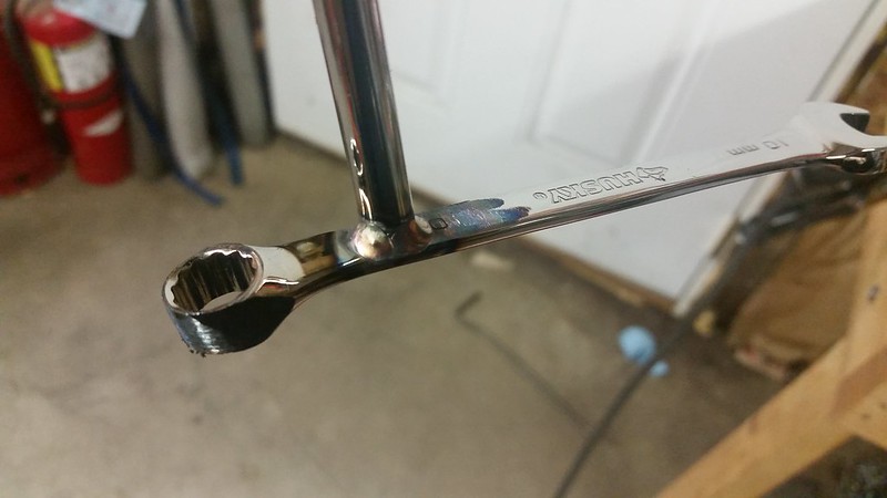

ANd all my JY parts to try to make a GM pump feed a Ford box. I cut and welded the fittings on the pressure line. Think itll hold but just in case Im starting to track down -6an adapter fittings and ill just fab a line if it fails or i just need a better ran setup.
20171001_151518 by Z S, on Flickr
20171001_185630 by Z S, on Flickr
20171001_191044 by Z S, on Flickr

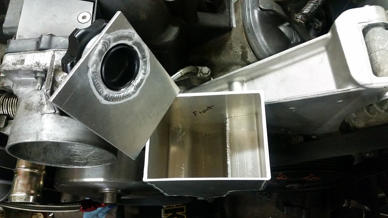

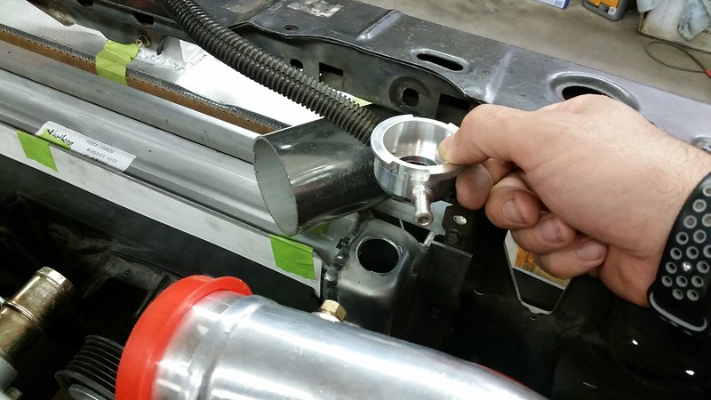

And along with the lines and retrofit coolers i didnt have a res for the corvette pump as its not part of the setup like the truck ones i needed to make a res. so currently inwork is the aluminum res.
20171008_191533 by Z S, on Flickr
20171008_191558 by Z S, on Flickr

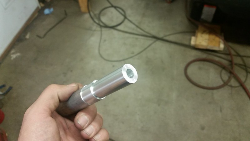

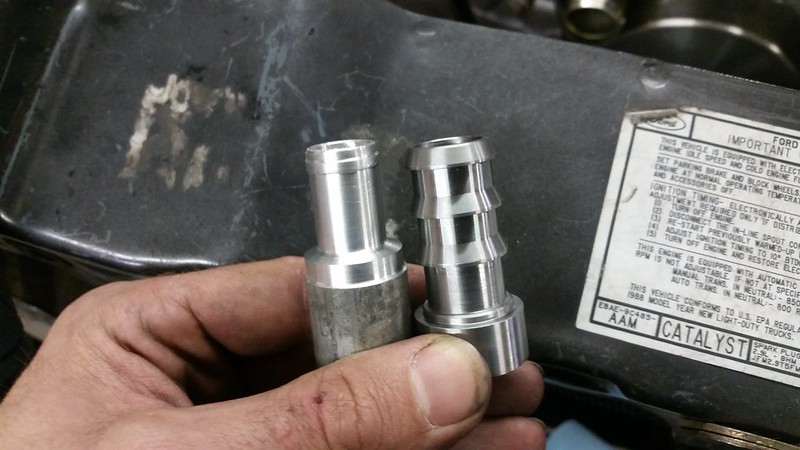

Now ill add a -6an fitting at the top for the return and originally i was going to make it out of the spare steel parts but i like aluminum too much so i this is the result. Now i thought i had the right steel fittings but once they came in i realized 3/4" was too big it was actually a 5/8". so i fabbed up a 5/8" nipple out of aluminum billet i had laying around. I kinda have a tool problem so i have way too many odd tools like a lathe. here it is, and ill be finishing it up and hopefully starting on the catch can today.
20171008_191507 by Z S, on Flickr
20171008_191454 by Z S, on Flickr
