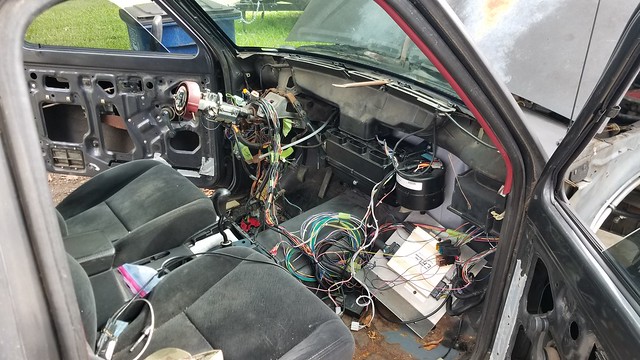

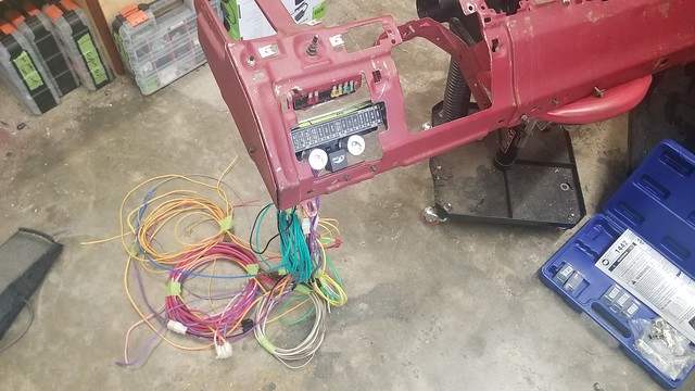

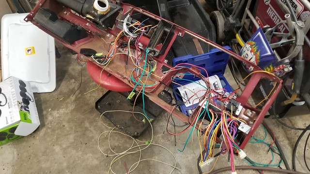

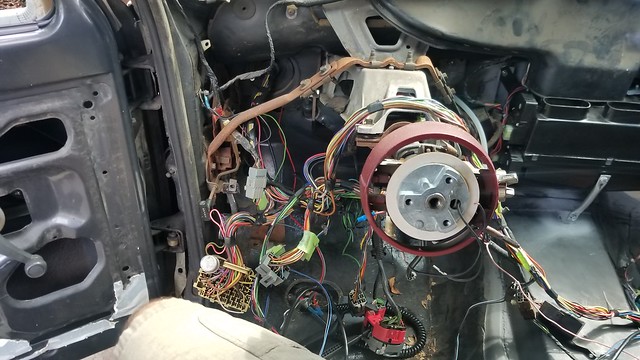

Post dyno I finally found nice enough weather to finish the AC... but turned into a rewire as well with a spare harness i had laying around. The fuse panel from 88 has seen better days. relocated the ECU a little and some additional wiring switches, interior lights etc.

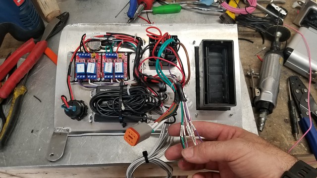

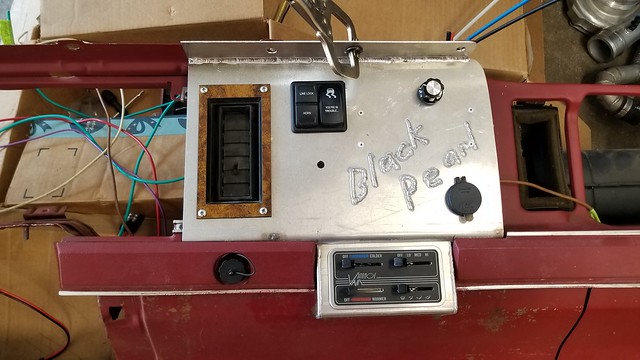

Center dash panel and rear where i added a few relays to run some traction control and line lock inputs to the ecu.

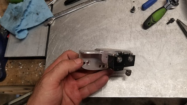

Built an adjustable clutch switch for launch and flat shift when i get around to programming it in to the ecu.

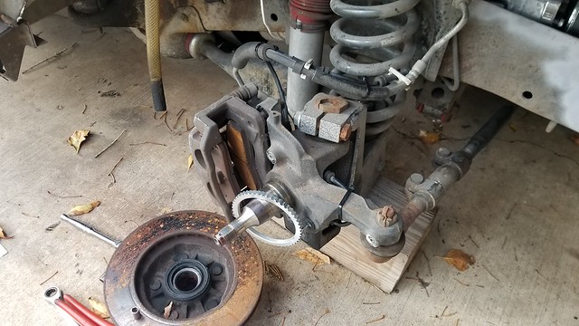

Didnt get a finished pic but was able to add a reluctor ring to the front with a mustang ABS sensor to start playing with traction control.

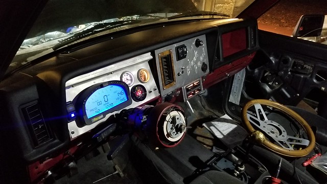

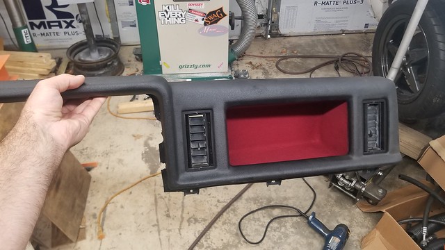

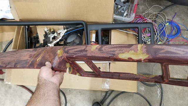

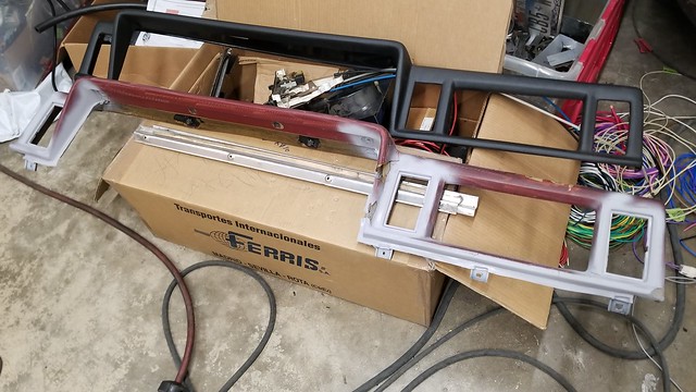

Finally added the LMC dash cover and re flocked the cubby. looks great honestly if you paint the trimmed out areas on the dash prior to install.
20201018_192819 by Z S, on Flickr
20201018_193153 by Z S, on Flickr
20201023_144022 by Z S, on Flickr
Dash installed but still need to redo the gauge panel and then flock it black.

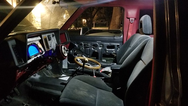

Added LED interior lights... probably the best thing since getting this truck going. You dont realize how much a pain it is till you dont have an interior light at night.

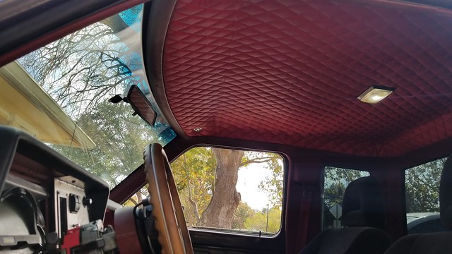

Also recovered the headliner although a little brighter than i wanted i think itll be fine once i do the door cards the same and then black carpet.
20201111_131644 by Z S, on Flickr

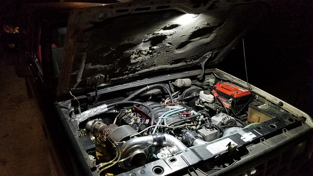

Another nicety, underhood lighting.

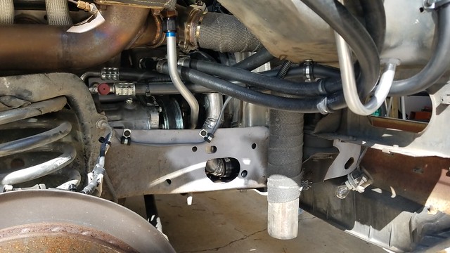

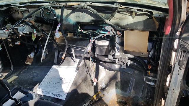

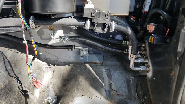

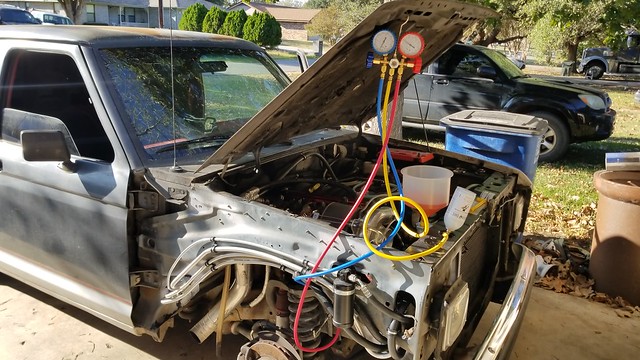

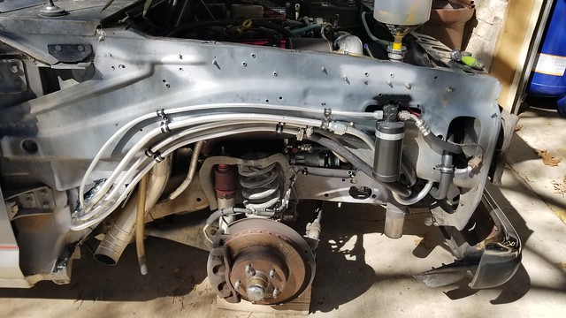

And quick finished up running of the AC/Heat lines, and works pretty good so far. we will see when its 110 out though.
20201101_133951 by Z S, on Flickr
20201101_134009 by Z S, on Flickr
20201101_133959 by Z S, on Flickr
20201101_134027 by Z S, on Flickr

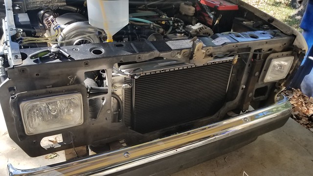

Harnesses all cleaned up and and relocated ecu, sealed up all the firewall holes as well.

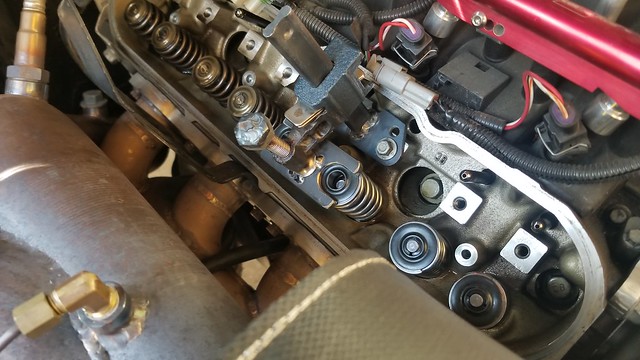

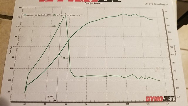

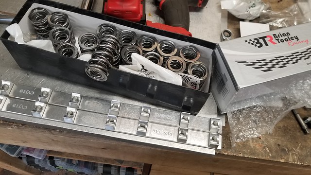

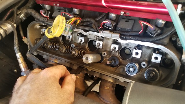

After that and looking at data the last dyno session we floated the valves so installed some billet rocker stands and dual .660 springs.
20201114_110910 by Z S, on Flickr
20201114_143432 by Z S, on Flickr
20201114_143732 by Z S, on Flickr

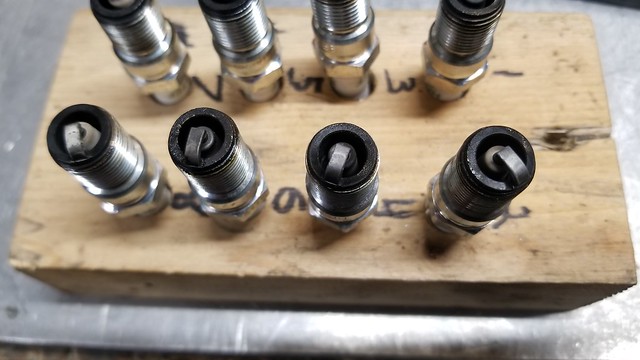

Checked plugs and compression while we did that, still burning about 1qt oil over 1500ish miles... itll work for the JY motor that it is, lol.

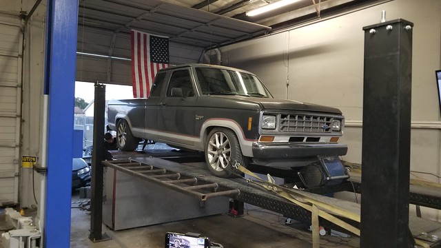

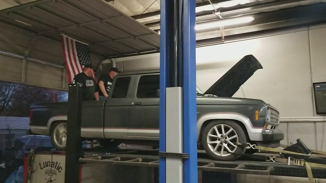

Then we hit up a Toys for Tots dyno day to validate the spring change. 836 wheel at 27# so more power at less boost is a good indication we fixed that problem! now to start dialing in the traction control, launch, flat shift, boost by speed, etc.. maybe even work on the interior a bit more.
