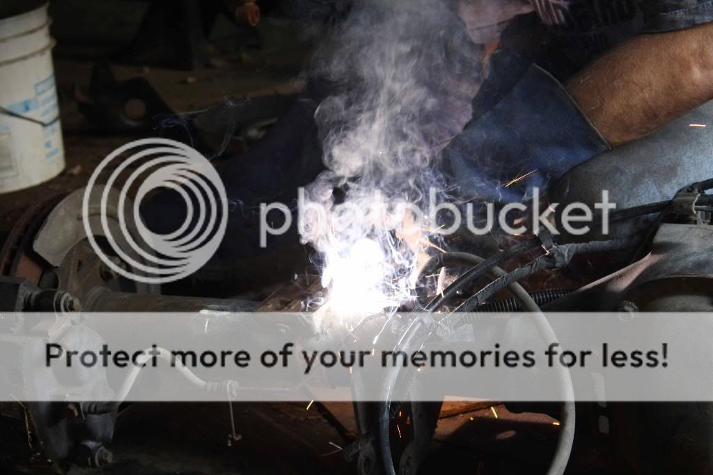

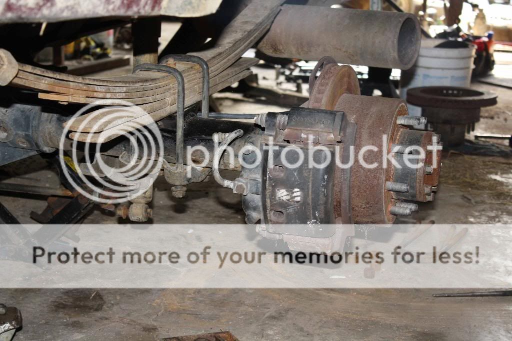

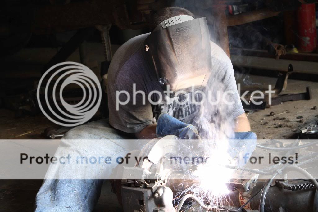

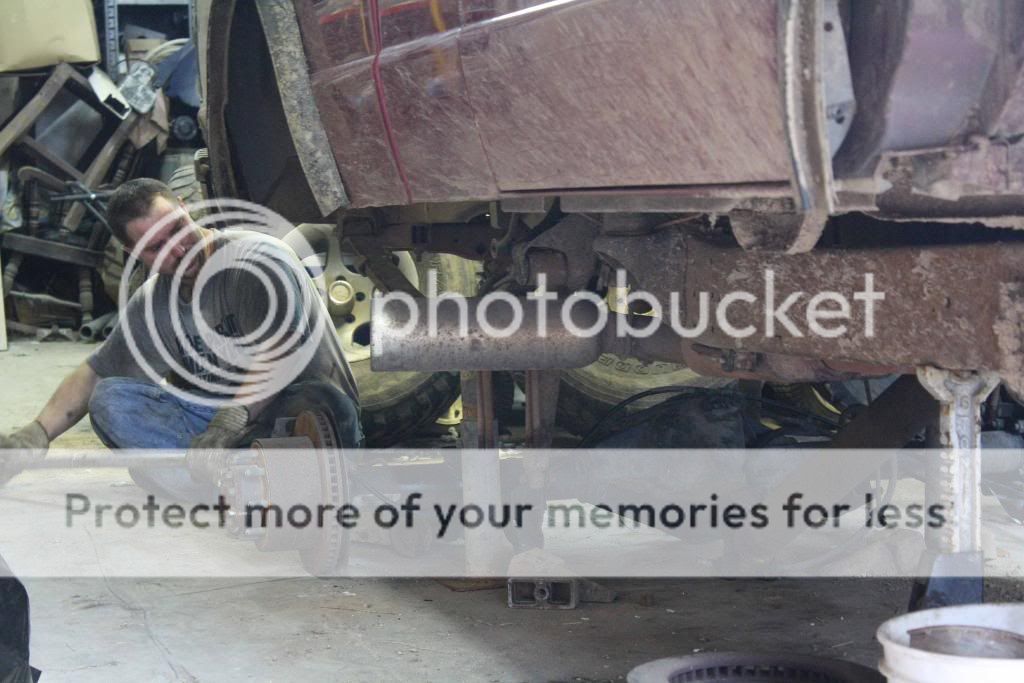

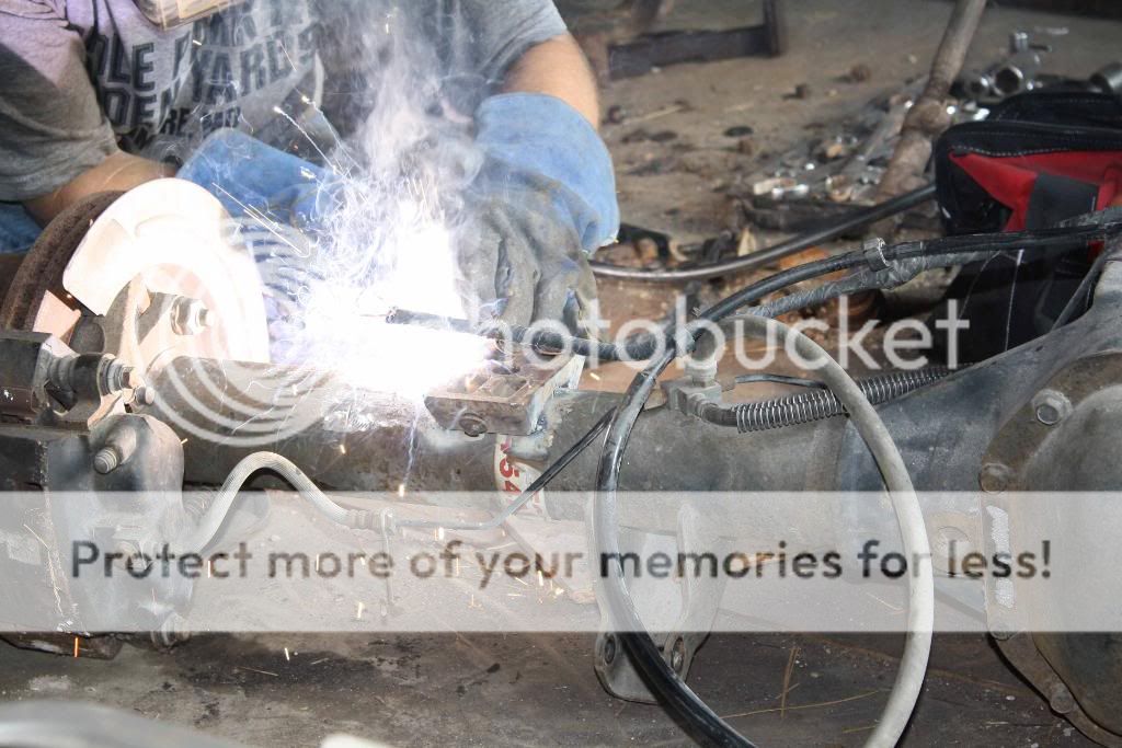

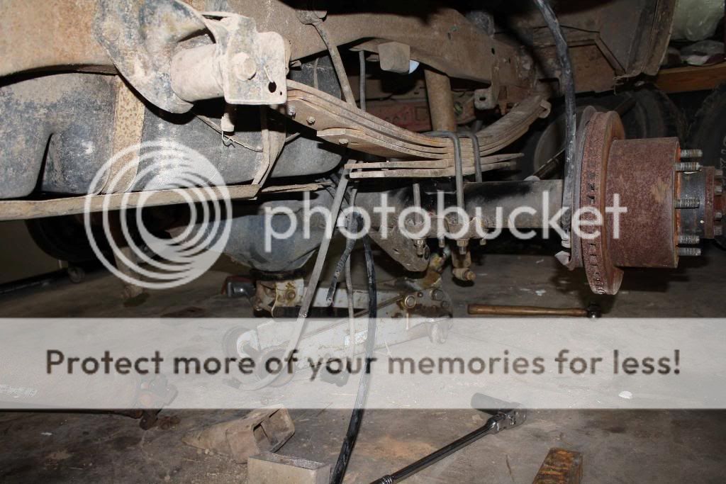

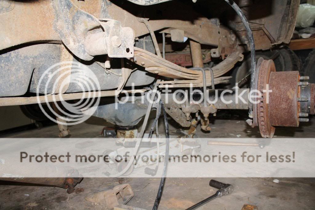

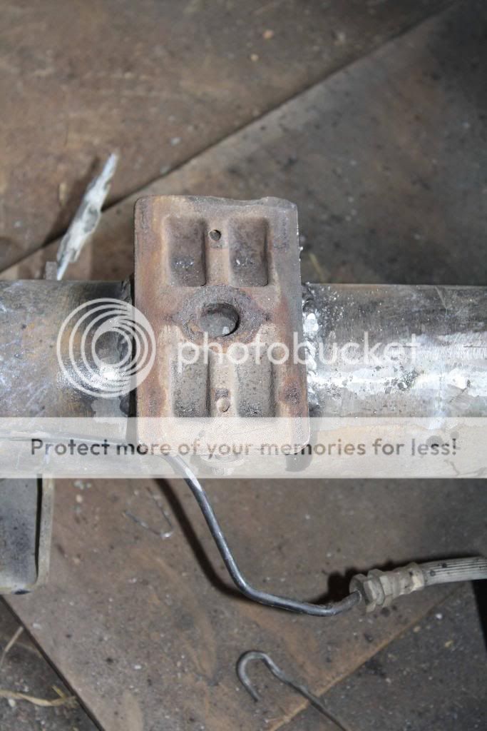

Ok, time for updates...Well, I spent the majority of the day on the front, and its been kicking my a$$ !! When I put the knuckle back on, it turned 4 degrees on me while I pressed it on the tube, and now I'm having a hard time pressing it back off the tube to get it aligned...I don't have a 20 ton shop press, and thats about what its going to take to remove the knuckle. So with the 60 is still the same with very little progress, so no pics of it...
The rear axle I did some research on, and it's a FF60, BOM 606705-1 has 3.55 gears and its open. I was hoping this was a 70, so for now this is staying the width it is and being installed temporarily til I get a 70 or 80. As far as I know its a 30 spline, couldn't find info on the axleshafts. I know the pumpkin is centered, and the fuel tank skidplate don't like that, so I'll be trimming the plate tomorrow. Also, I need to see if the driveshaft will work as the axle yoke is closer to the trans than the ranger/explorer 8.8...I got the FF60 perches relocated, angle set and burned on, and it's bolted in SVT along with the shocks bolted up. I still need to hook up the brakeline, E-brake cables and ABS/VSS sensor. Right now this is all I'm doing to the FF60 (I may do a gearswap later) as I need to get this rolling ASAP!! Didn't get as much progress as I had hoped, and looks like I might be spending the weekend working on it too...Here are a couple pics from today :icon_thumby:

So your gonna look like a dually? Lol that'll be interesting... Can i ask why not just use the 60? Seems like it'd be more then strong enough or is it the same as that sterling and you cant narrow it?
The FF60 is only a 30 spline, and my front 60 is 35 stock, so right now my front axle is stronger than my rear. In order to run a 35 spline shaft in my FF60, I'd have to ream out the hubs so the shafts will fit. I'm leaving it in stock form and will locate me a 70 or 80 from a 1 ton and narrow that, this way when I'm done I can swap out the rear axles in an afternoon rather than have the truck down for a week or so while I'm building the rear, then when I'm done I'm sure someone will want a factory disc with parking brake FF60 :D As of right now the entire rim sticks out past the body on the rear axle. I can get around driving this way around town, but not on the trails, so it's replacement will be sought after soon...
