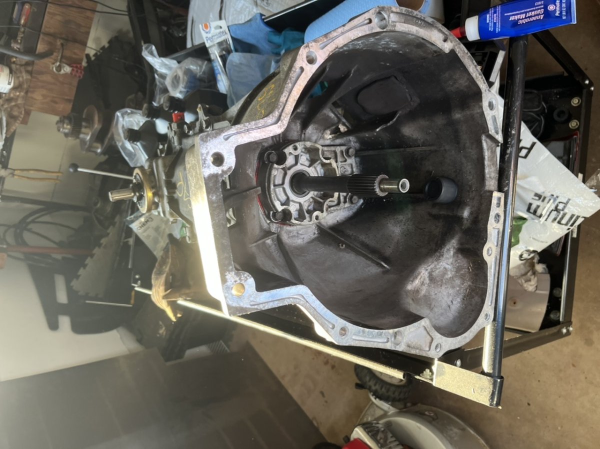

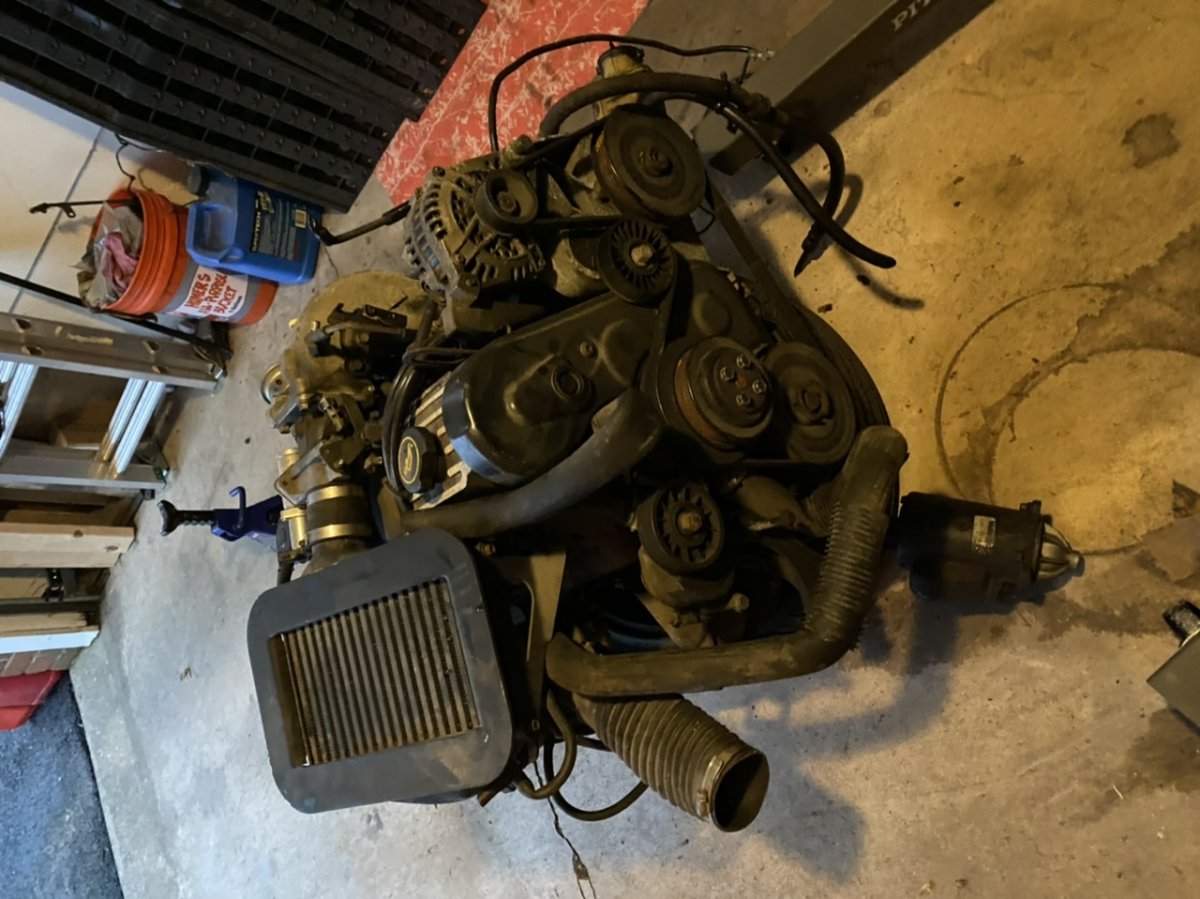

I have the vam ecu and harness from the engine additional accessories as well. My initial thought is what all needs to be removed and replaced during the swap? I know I’ll be removing the dryer and lines corresponding. What else ? Notch the hood? Cowl? Any advice would be appreciated. Thanks. Oh and I’ll be using the m5od.

Yes I snagged the vane air intake and harness wiring included. Think the turbocoupe functional scoop could be modified to work with the ranger hood in some capacity? I have a NOS Hx35 holset I would like to adapt to the motor eventually but not sure I’m ready for that jump yet I’ll need a front mount intercooler etc. i’m reading thru the forum for pinout info using the thunderbird harness and ecm. Guessing I’ll need to use the ranger motor mounts and a good idea to swap the oil pans?

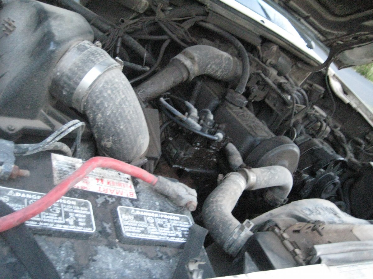

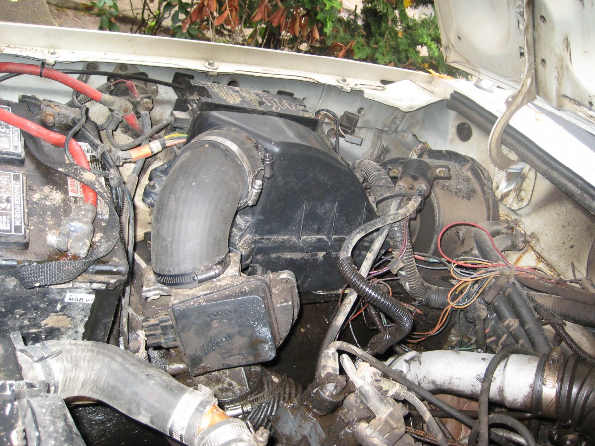

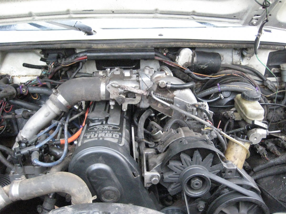

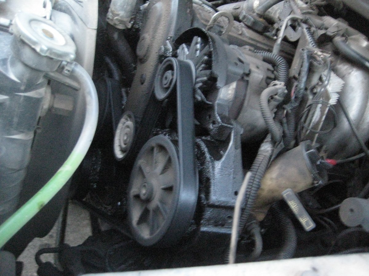

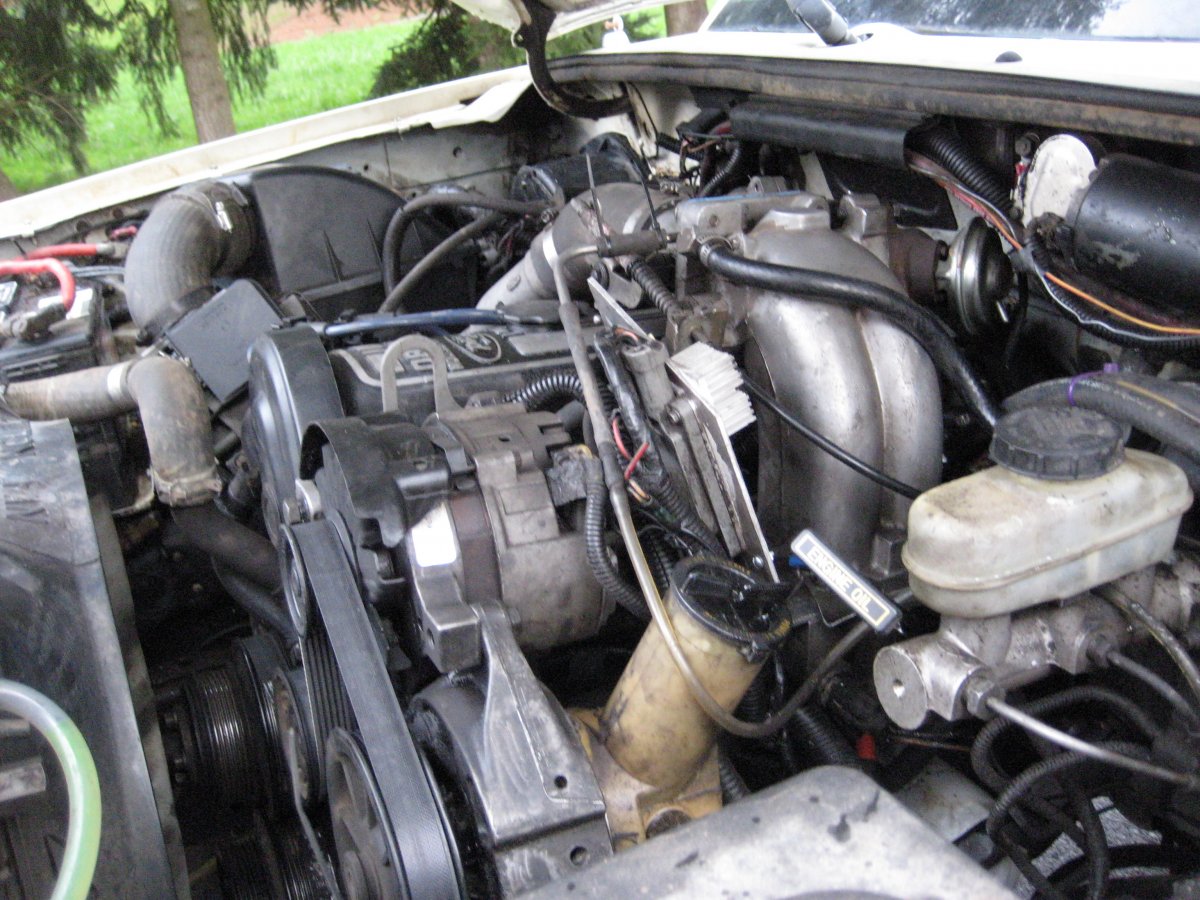

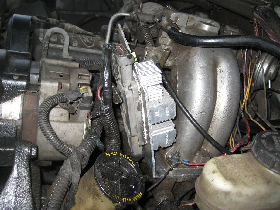

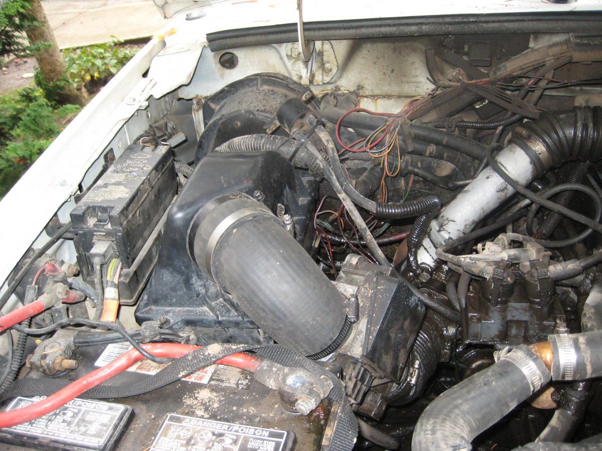

Here's a pic dump of my engine bay, hopefully something helps even though it's slightly different under the hood of a '90 than a '94 (battery on the other side for one, computer in a different location too...). I know it's a disaster oil mess wise, I've spot cleaned a fair amount but I've half assed it too much... the engine needs to come out for a deep clean at some point... I don't remember when any of these pictures were from so things have likely changed... one shows how I mounted the ignition module on a plate sandwiched between the two intake halves, it's still like that, works great... you can also see how I swapped to a V6 radiator on the upper radiator hose, whether it needs it or not I'm not sure I just did it thinking I did... Ok, most of those pics are fairly old, forgot how gross it was at times... it's been pressure washed under there a few times since then...

Definitely is a great point of reference.
noticed you deleted the intercooler, any idea if the functional hood ducting can be easily modified to the ranger from the turbocoupe? The secondary dis ignition was wired to keep the coil pack did you ground out the first or second one or use a resistor in place to fool the ecu?
You could use a couple resistors, I just spliced the secondary into the primary which made the tach work fine, it ran fine with the secondary disconnected but the tach didn't work...
I didn't delete the intercooler (although I have one), I started off with a '85 engine and only the '87-88 had an intercooler, I decided in my application that that location for an intercooler wouldn't work, wouldn't get airflow while offroad (it would, just the wrong way...) and sand would run down the hood and plug it up... on your application the factory intercooler should do something, don't know how it lines up, I put mine up there once to look but don't remember... I have an air to water intercooler I want to throw in with a remote mounted radiator sometime in the future...
Oh, and after I did some of my ugly wiring some of the things I would have done differently is just use the Ranger throttle body and TPS for cleaner wiring and would route wires better... I'm way better at wiring now than I was a decade ago...
I thankfully have the intact engine to swap parts from, on the fence about ditching the original dizzy for the packs. The dual plug head I have is original to the truck and it’s a iffy engine to begin with the original engine has over 200k on it vs my 79k turbo motor. Assuming if I do swap harnesses the thunder coupe harness will be missing a few things I had initially from the rangers system?

Quick update….
And some info assistance, does the ranger harness play well from the 94 with the turbocoupe ecu, when re pinned?
