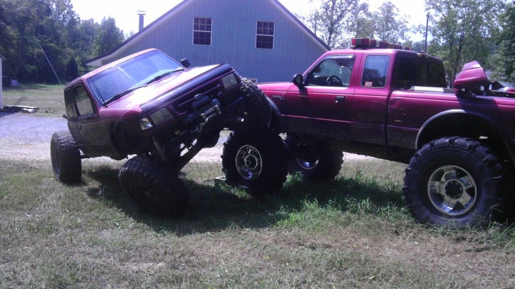

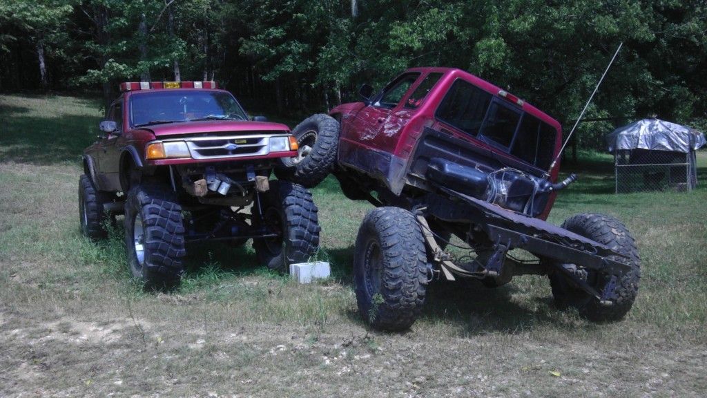

Well, I'm working on the ranger today, but sadly its not, but svt's twin, railmans truck. Some of you know, some don't, but I call it the twin cause SVT and railmans ranger differ by only 3 letters in the vin. Both have same month and year birth date, same paint, same engine, trans, and Tcase option. Different gears is the only difference in the package. Anyways I had to measure for rear shocks. So I used SVT's shoes to measure..
SVT
12" I'm pretty sure
Edit:
Actually I think it was 10 because 12 would make the tires hit the cab
He already shortened it I believe 10", I'm shortening another inch, but with it flexed out the tires still have 10" from the cab, he can actually shorten another 7.5" after what I have done and still be at least an inch from the cab...
