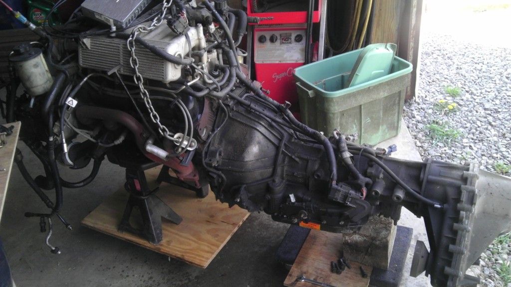

Anyone have a clue what this is, what its for and where it goes :icon_confused: here is the motor and trans on rollaround dollies I picked up...

I'm going to wait til I install the motor and trans in the ST before installing the tcase. It will make installing the motor/trans easier. Since I've found out that the motor will run on the older computer (it will just run pig rich and get shitty mileage) after I get back from a concert saturday night I'll start pulling the motor out of the ST...
