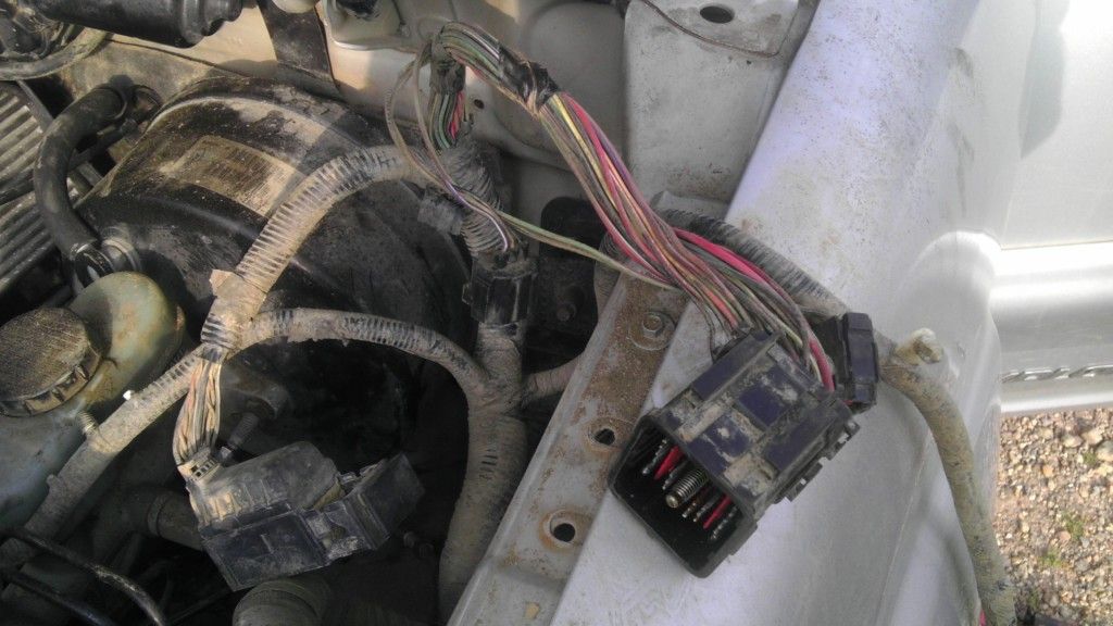

I took a couple shots of the 42 pin harness, and what I needed to do to get some slack in the harness to mate the two plugs together...
Project ST- yet another V8 swap....
Along the fenderwell behind the ABS pump the harness is attached to the inner fender by a bolt. I unbolted the tab securing the harness to give me the needed slack. This was temporary as I had intentions of making an extension plug to give me the necessary slack (More on this later)...

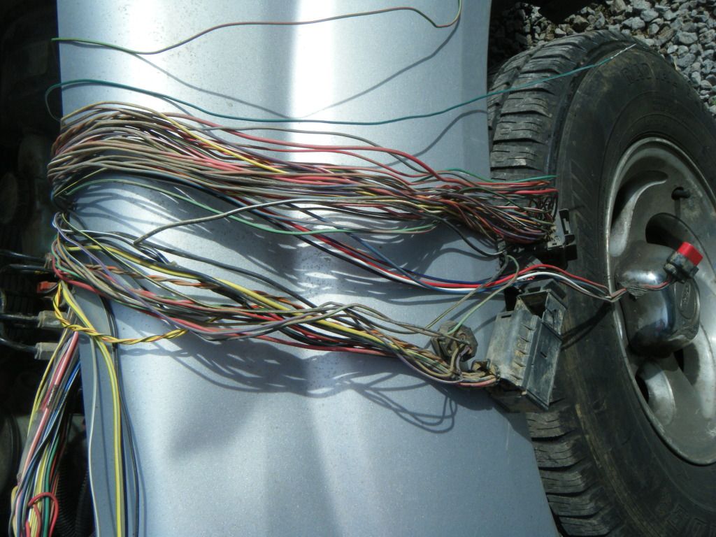

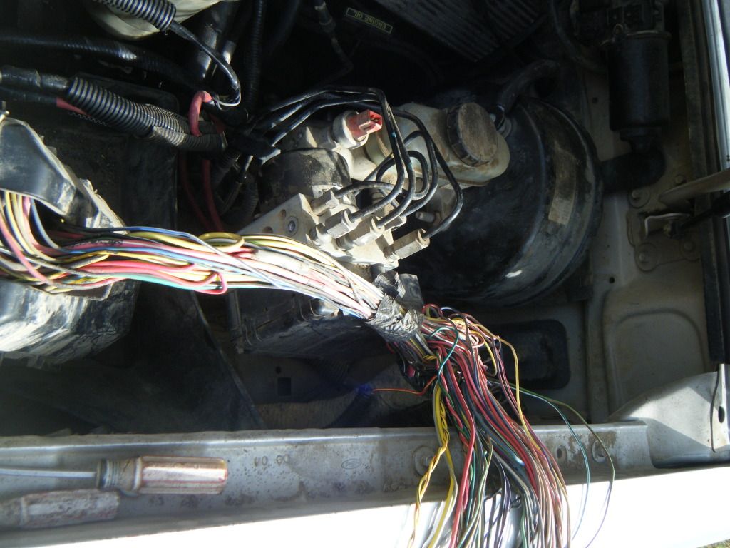

...and pulling the 42 pin harness apart about a foot past the plug...
I now have identified the colors of both the 4.0 and 5.0 vehicle side of the 42 pin plugs. I've found 14 mismatches that are either different color wires on each end, or are blank on one side with a wire on the other. So now I'm needing a 42 pin pinout for both a 99 explorer 5.0 and the 2002 sport trac with a 4.0. Apparently in 2001 Ford switched the wiring around. When I did the V8 swap in SVT, both SVT and the donor was plug and play. I know I can trace the wires down and ID em that way, but I know someone has got to have this info sitting somewhere. So this is where I'm at right now. I figure I have another day or two of ID'ing the pins before I can continue :annoyed: Good thing I know electrical...

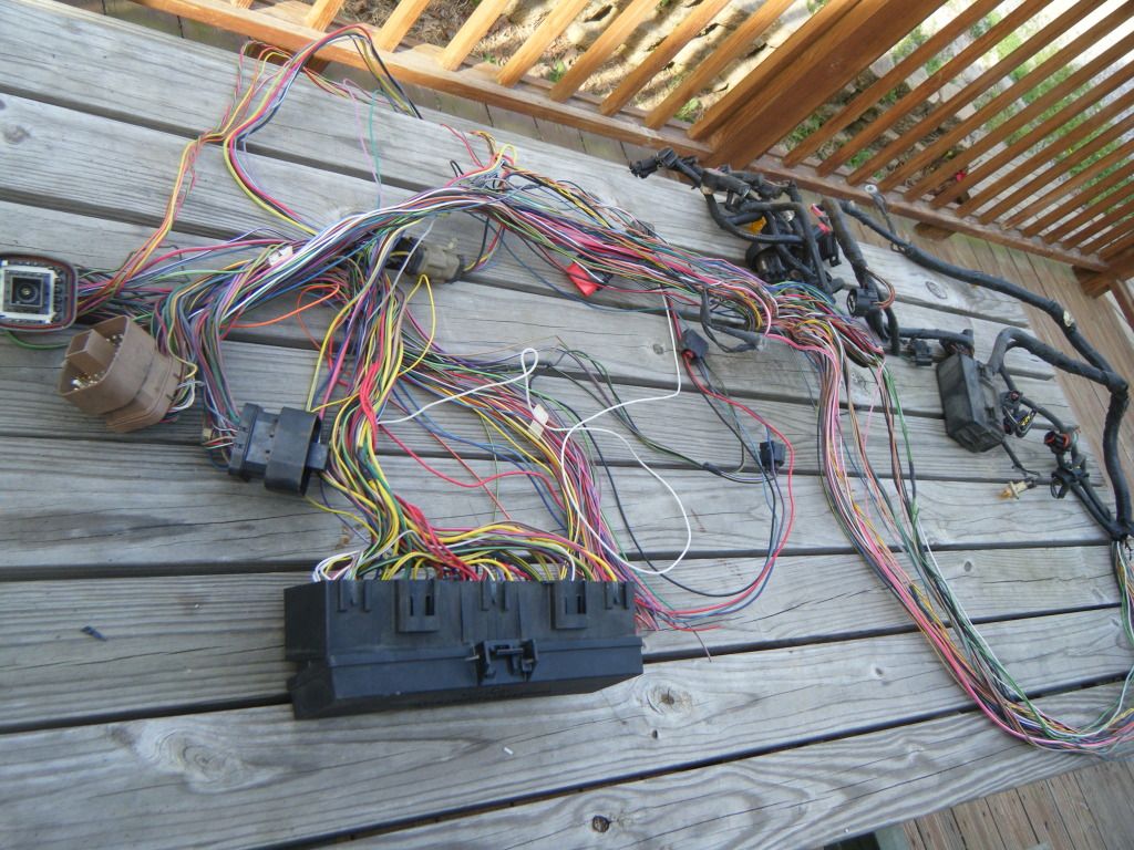

Well, today my day started out looking like this...
...and this...
....And a little of this...

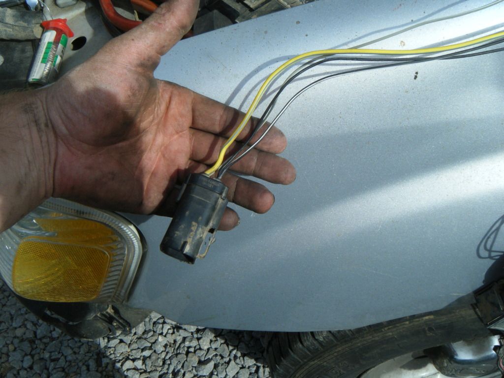

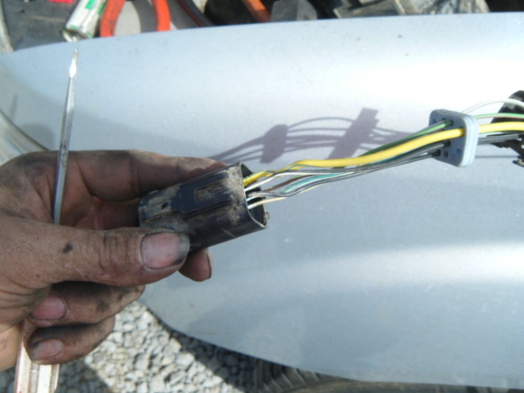

Can you tell I'm doing a little wiring?? So, with the help of a member on EF, He's been getting me diagram after diagram after diagram. I've got about 3/4 figured out, and I'm finished the altenator harness plug. Turns out, the only thing running through that plug now is the AC clutch and Starter solenoid wire. On the 5.0 harness the low oil sensor also runs through this plug, but I'm not running that circuit, so I pulled the pins from the engine side the harness. I also had to pull the pins for the oil pressure gauge, and the altenator output to dash gauge wire out of the altenator plug to be installed in the 42 pin plug. Here I am pulling the pins out of the altenator plug..
Putting the plug back together after re-pinning...
Here is the plug re-pinned and finished.....

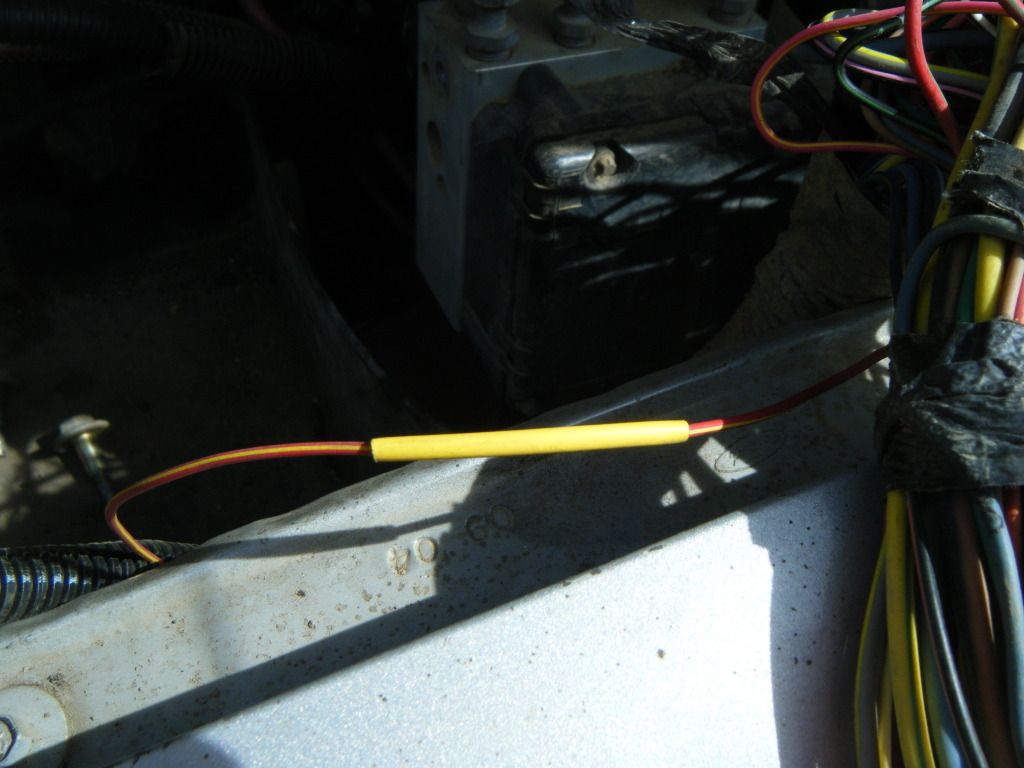

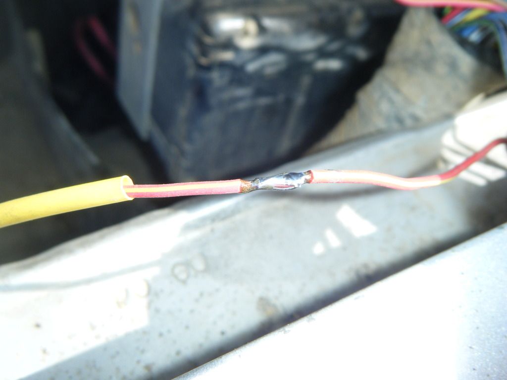

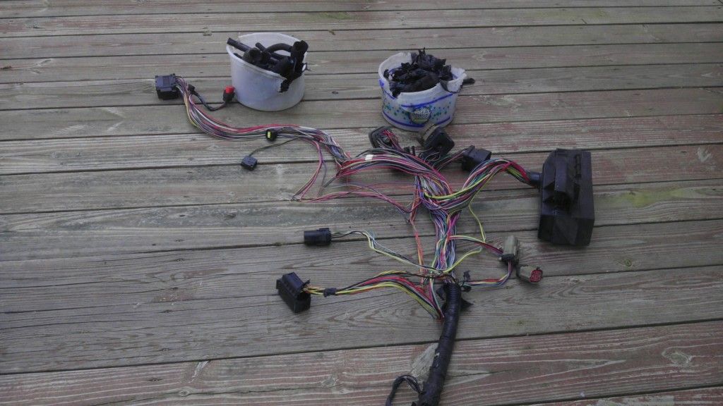

I have about 14 wires to re-pin on the 42 pin plug, and I have about 40 wires to cut and lengthen (I'm extending the 42 pin plug to reach the engine harness, running the harness the way it was run in the explorer. I also got the AC high pressure switch wired....
