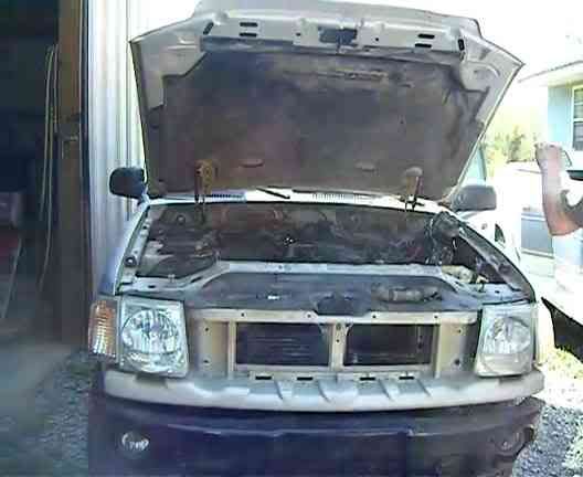

Okay, so as ya'll know, its running. But lets take a look at what it took to get there. Since I like detail, here is how to take a plug apart to release the pins for removing/installing pins. First, take the cap off. There are clips on each corner...

Here I am about 2.5 hours into extending my harness, about half way done...
And here is the harness completely extended...
Here is the original 42 pin harness plug with about 10" of wire left. Since I had the 5.0 donor's plug, I cut off the plug with about 20" of pigtail. In doing this, instead of cutting and adding wire to an existing circuit and having two solder joints, I cut the original harness at 10" long, leaving me 10" of additional wire, thereby extending my harness by 10"...
I've got most of the harness wrapped back up in the original wire loom. Tomorrow it will be done, hopefully by noon. After I get everything back in place, I need to check for leaks and fluid levels. Here is where I called it a day. The sun went down and the mosquitos starting coming early (At least something finds me sweet :D)

Swap is now officially complete. I'd say it took me maybe 1.5 to 2 hours today to finish, if only those damn mosquitos would have stayed away...Oh well. Here is the engine bay with the harness finished and in place...

After reviewing this swap, it took me 7 days, but I know I could have shaved 2 days off for the weather, and possibly another day had I done more research, or had the EVTM's for both vehicles (took me 3 days to get the info I needed). Realistically, I could have done it on a long weekend. I have found a V8 swap done in a sport trac or two, but none have done it with the year donor I have, or in as short of time as I have. The swaps I've seen have used the return style fuel system to work around the PATS and the Speedo issues. I didn't find any sport trac owners wanting to tackle this swap with the year that I did. As of right now, I'm using a 97 ECU. While this return fuel style ECU will run my setup, it does it running pig rich as it doesn't regulate the fuel pressure. Also, the VSS runs through the ECU for the speedo to operate. In 99 is when this changed, so right now I don't have a working speedo. My SCT will be here tuesday and I will be heading to the shop next weekend to get a custom tune to delete the PATS and rear O2 sensors to allow me to run without the cats. I'll change to my 99 ECU at this time so I can adjust my FPR as well as get my speedo working again...
