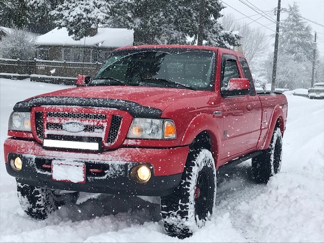

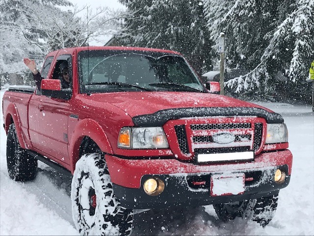

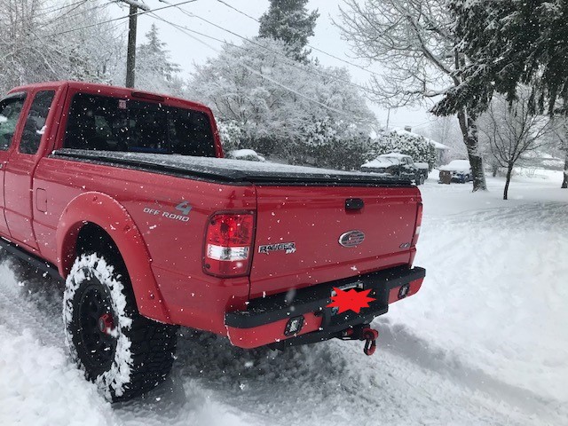

Not today ! ! ! About 10" in Tacoma, so took the Ranger out for a bit of a spin to check it's snow performance. Nothing extreme, just checking traction with the rear LS and Cepek tires. Had two 80lb. dumbbells and some recovery gear in the bed, handled like a champion.
Been working for the last few months on the "new-to-me" trail rig (also RBV: 1st Gen Explorer Sport), but the Ranger always a workhorse for projects and stuff.
Been working for the last few months on the "new-to-me" trail rig (also RBV: 1st Gen Explorer Sport), but the Ranger always a workhorse for projects and stuff.View attachment 55545

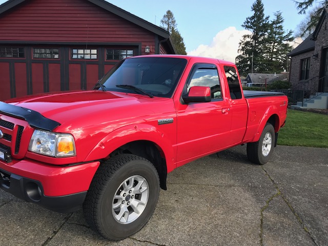

Purchased my lower mileage (65,000 M) Ranger in 2018, it was the FX4 with manual transmission, Rancho 5000 shocks, 4.10 gearing with a limited slip, and had a factory tonneau cover. Previous owner installed a Magnaflow cat-back exhaust and K&N air filter kit.
Here it is when I brought it home:
