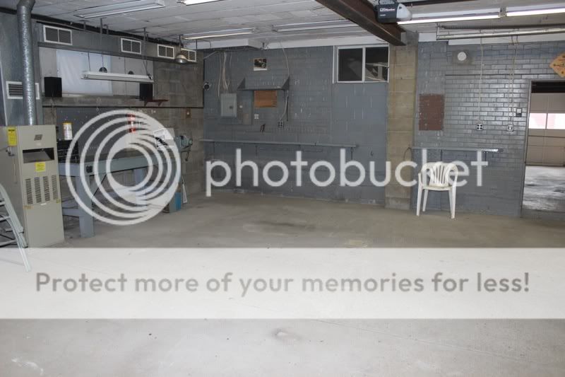

On another note, my girlfriend and I went looking at houses today amd our top pick so far has a 2 car workshop built onto the house and a 1 car garage under the house. It has a 100 amp circuit and at least 20 outlets just for the garage. It is air conditioned and heated and comes with two large work benches and some other odds and ends. I'll post a few pictures of it later on. The house is really nice too. And the best part is that it is under $100k! :yahoo: I really hope it is our top pick and it doesn't sell in the near future. We still have several others to look at in the coming weeks though. Only time will tell if it is the right pick, but at the moment it is looking promising.

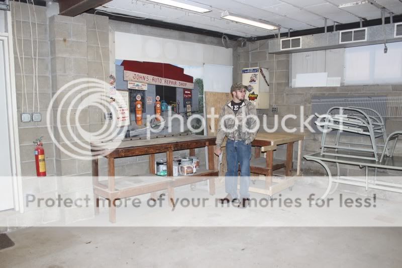

So these are the two pictures of the garage in the house we are looking at. The garage comes with everything in it, has A/C, a huge heater, and it is on a separate 100A circuit from the house. And the house only has a 150A...
Excuse my dumb-founded look in the picture... I was unaware it was being taken... :icon_rofl:
