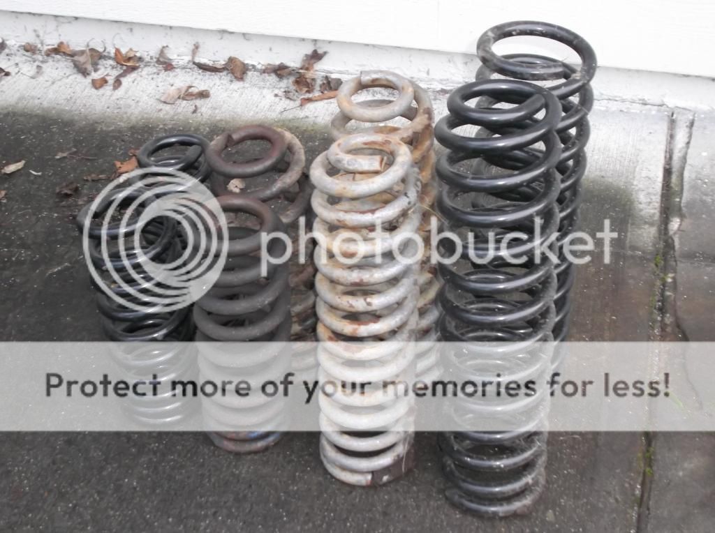

Haven't got much done on this lately. Its just rained all the time and I refuse to work on this in the rain. With a short break today I hauled out my collection of coil springs for RBV's.
By using my calibrated eyeball technique I've determined the 3" James Duff springs have sagged a fair amount.
From left to right:
Short black pair: Moog replacement 87 STX coils (supposed to be an inch or so taller than stock.)
Rusty filthy blue pair: James Duff 3" coils.
Rusty grey-ish pair. Bought used from another Ranger a couple years ago, What exactly, idk.
Tall black pair: 6 1/2" BDS coils for a Jeep XJ. (240 ppi)
Okay, I plan to use this thing as a dd and occasional use 4x4 though I tend to truly kick the sh!t out of my 4 bys off road. Which springs should I choose?

The xj's they'll be a better ride. The ttb could are too stiff.
I think it would flex better with the xj springs but lean like a mother on curves as a dd. I agree the RBV springs are far too stiff and was leaning towards the BDS springs anyway. I wasn't planning on running a swaybar so I guess I'd have to change my driving technique (ie slow down for curves...) a bit.
Second choice would be the grey springs just to maintain altitude since they're pretty heavy duty. As stiff as RBV springs are they do sag over time.
Remember you have different spring rates there, so even though one spring may be higher, it wont support the truck like another, due to the higher spring rate...
SVT
I'm not sure what you might recommend SVT, and would welcome your input.
Should I look at early Bronco coils? Theres a wide gap in spring rates between the 240ppi xj coils and 5 - 600 ppi RBV coils.
:dunno:
There have been a few that have used the light xj coils on the ttb with success. I'm running a 190 ppi coil on my full width sas ranger I'm currently building. Flex should be good...

There have been a few that have used the light xj coils on the ttb with success. I'm running a 190 ppi coil on my full width sas ranger I'm currently building. Flex should be good... SVT
I'm aiming for around 5 to 6" of total suspension lift so the gray springs (I believe to be a 6" Ranger coil of unknown make) and the BDS 6 1/2 xj coils are the only real options among what I have. Coils aren't the hardest things to re & re so my first choice isn't crucial but if both are wrong theres a wide gap between them.
The 6.5 xj's might get you 5" at ride height. They would probably flex more than the travel you have....
SVT
Then thats not a bad place to start. The issues can be addressed over time.

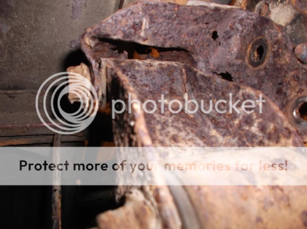

The frame rails look good but spring hangers and shackle mounts are all rusted out. Almost every single bolt is rusted in place so I'll be cutting that crap off in favor of newer parts from my favorite shopping place - the scrapyard.

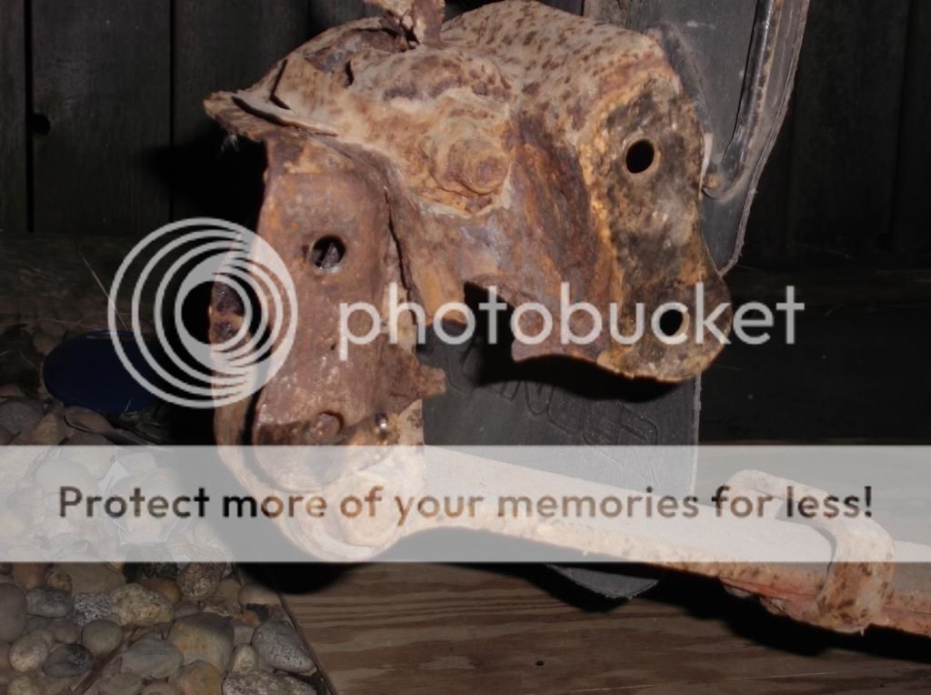

A couple pix of my rustbucket. lol The bolts in the leaves don't budge.
After the pain in the a5s I've endured trying to tear this junk apart I might need to rethink getting some of this stuff from the garbage supermarket.
Its been a slow process so far but the tail of the springs is down. The right spring hanger is hacked apart but the left will be slower for sure. The Bronco will probably be worse, it lived near the ocean.
