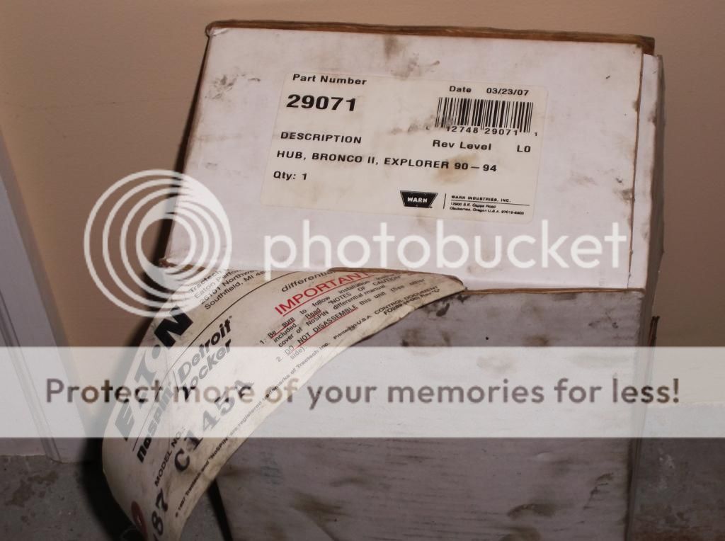

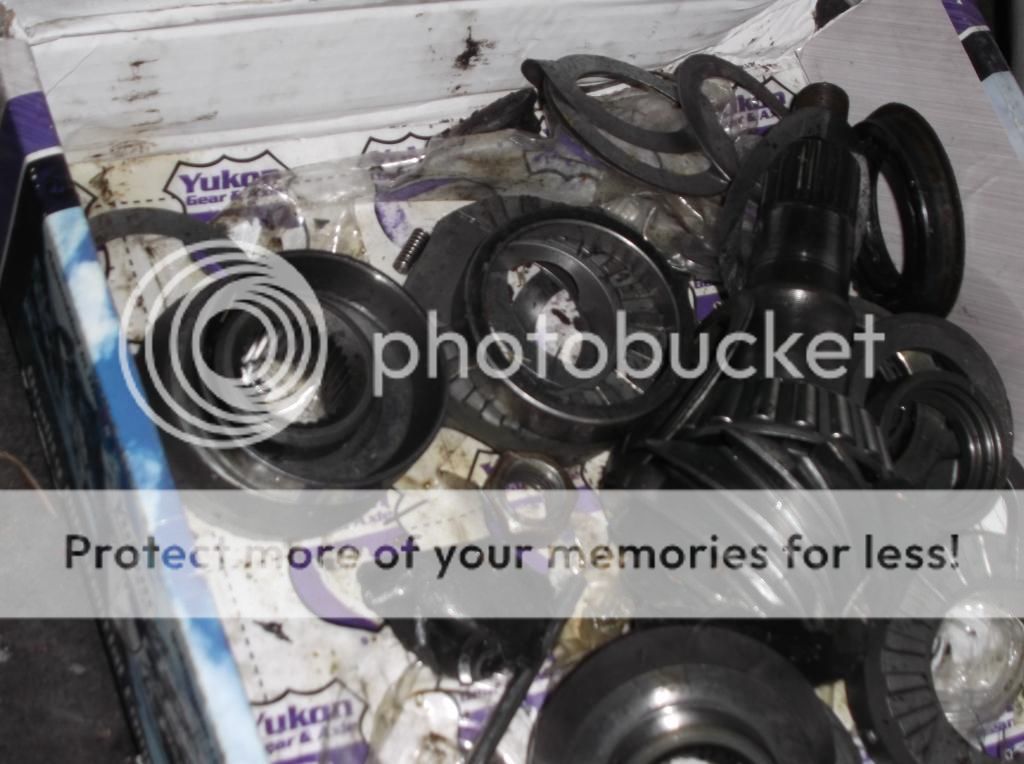

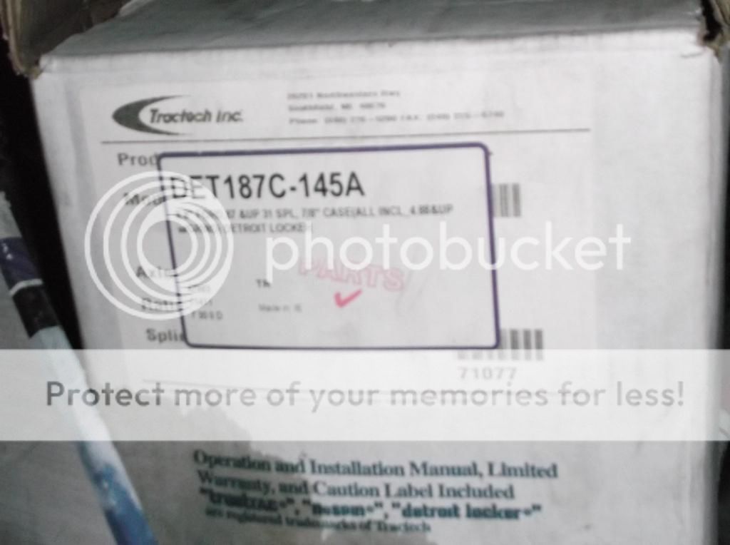

Tonight, doing a little recon in the back of the sploder I found the remains of an open carrier, chewed up ring and pinion and some Lock right parts in two boxes, one a Detroit locker box, the other a Yukon 8.8 overhaul box. Also found the "brand new" hub.
The PO said he blew up a lock right and replaced it with the Detroit and had to replace a broken Warn hub. If theres really a Detroit locker in that thing it might have become the best $450 I ever spent. ( I always take sellers claims with at least a grain of salt.)

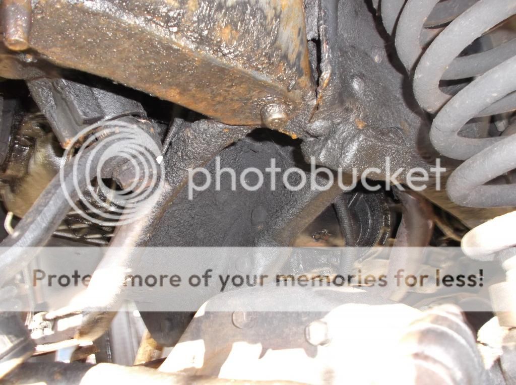

I also get to figure out how to add the D35 beams to the TIB crossmember. Some say to change it out but that sounds really involved and I'd prefer to keep it simple. Don't mind the work but I have little fab skills and fewer tools.
At 1st glance it don't look too bad. The drivers side drop bracket looks to be pretty similar. The pass side...
TIB
vs TTB
Definitely different. (Crappy angle, but still...)
Don't seem to be any way around it. To put the D35TTB in this thing I gotta change crossmembers. Everybody says so.
