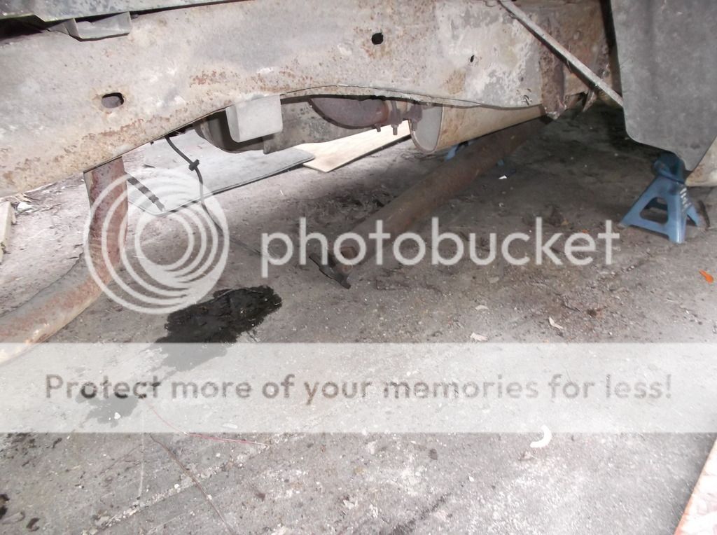

Hey Rowdy, did the chevy leaves move your axle forward? On some other builds I've seen guys say the axle wasn't centered after the chevy swap.
Just trying to figure out if the perches should be adjusted as I go.
Stangman92, for example had his axle move forward. On post 7 of his build: "I decided that since the front was mostly custom, why not do the same for the back, Yep Chevy 63" spings, didnt quite center the rear tire like id hoped they would, After this pic i shimed up the rear a little more. I had to shim them up a little (No stacked blocks) So that it sits exactly level when measured by the fenderwells."
IMG_20140914_112702455_zps111bf184.jpg.html
No mine stayed centered. I think the difference is how far they moved the front hanger. It was exactly 6" that I moved mine.
