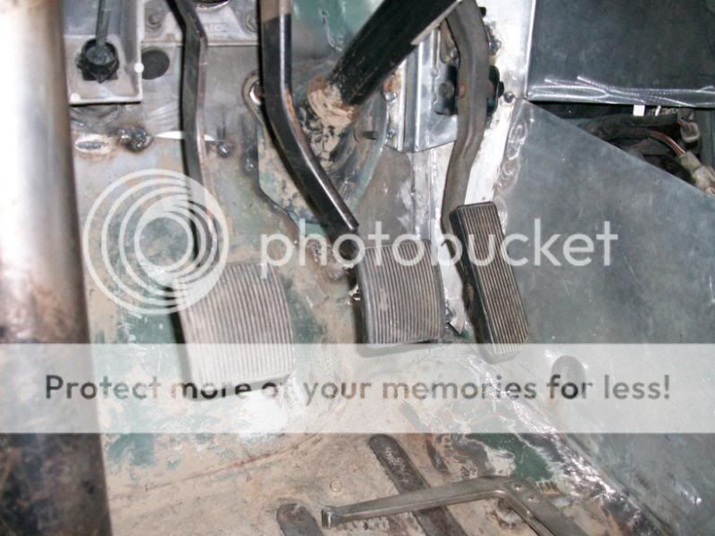

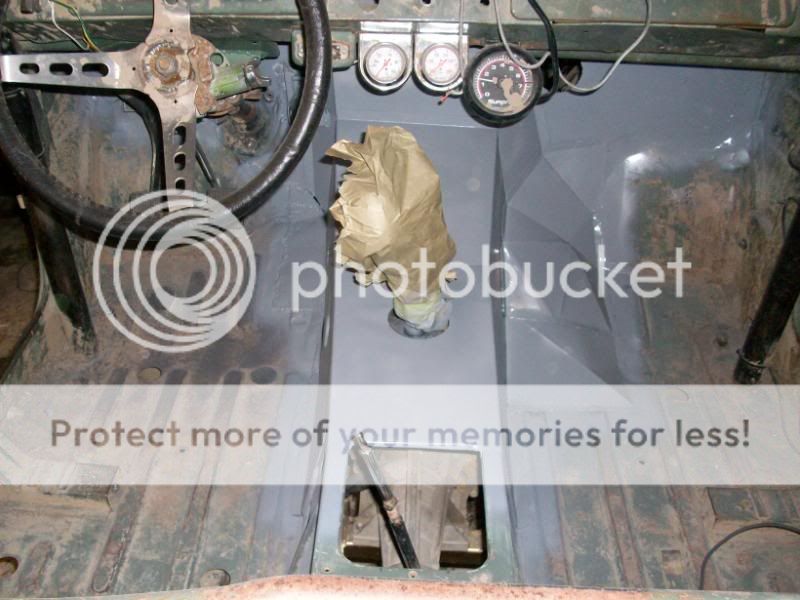

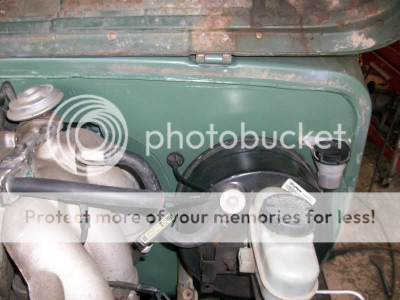

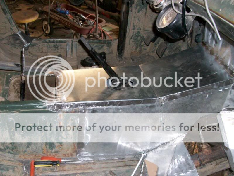

I got two more pieces made and installed on the passenger side. This leaves, I hope, just one more piece to cover the last hole. I also got the gas pedal mounted finally, and the throttle cable hooked up too. Because of the 1/8th inch firewall, I had to shave about an 1/16th off of the tabs that hold it into the firewall, but it snapped right in and holds tight. :icon_thumby:
Project Fordzuki
Project Fordzuki
Got the firewall primed...
Project Fordzuki
And seamsealed...
Project Fordzuki
And painted. :yahoo:
Project Fordzuki
Project Fordzuki

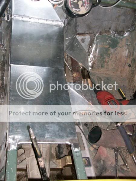

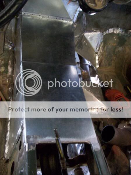

finish passenger side tunnel and top
prime, seamseal, and paint interior

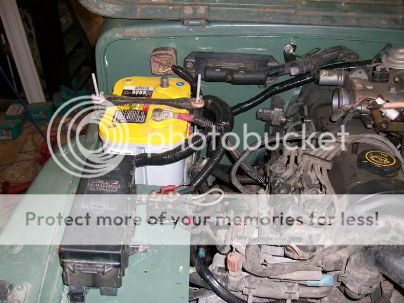

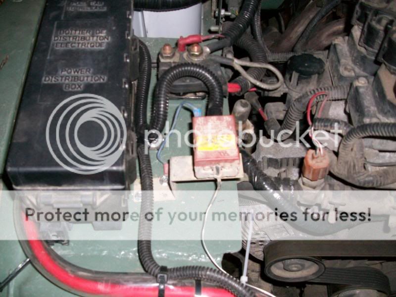

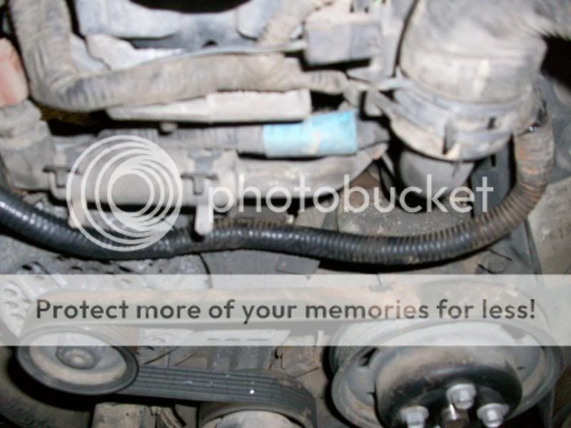

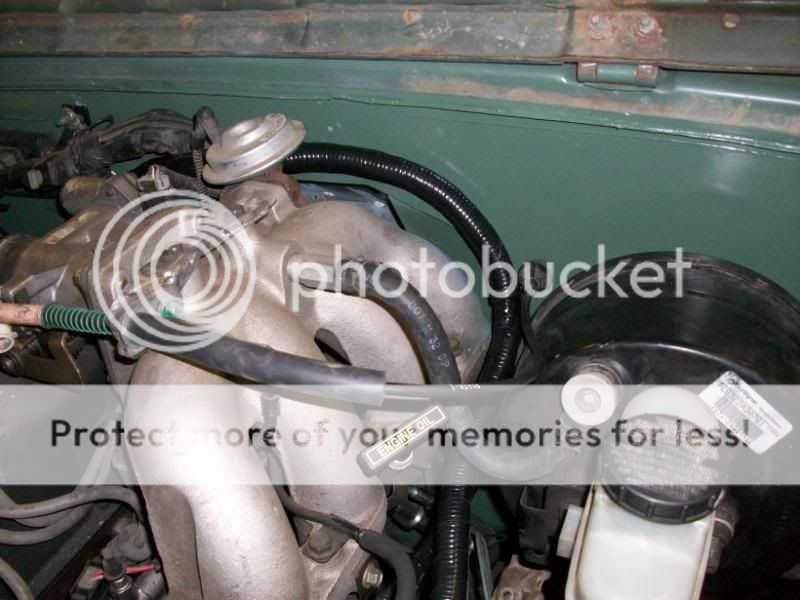

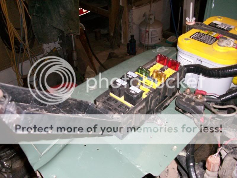

Tonight I got the front clip all bolted on with new fasteners, and got the underhood harness wrapped and routed, I just need to add some routing clips along the way in a few places. I got the distribution block mounted, the relay mounted, and the alternator harness brought around to the passenger side of the motor, and routed and fastened it in place. I need to bring my right angle drill home tomorrow for the last two holes where the connectors are for the alt. harness. I started routing the power cables, they're hooked up at the relay, I just need to do some creative routing to the starter to stay away from the exhaust. I also seem to have misplaced my negative cable somewhere. :icon_confused: But I'll either round it up or snag the one from the pinto motor. I need to change battery terminals anyway, the stock mazda sheetmetal ones don't have provisions for the winch cables. :icon_confused::D
So here's some pics.
Project Fordzuki
Project Fordzuki
Project Fordzuki
Project Fordzuki
Project Fordzuki
Project Fordzuki

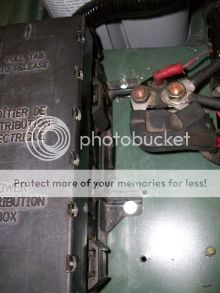

Modified the distribution block bracket a little

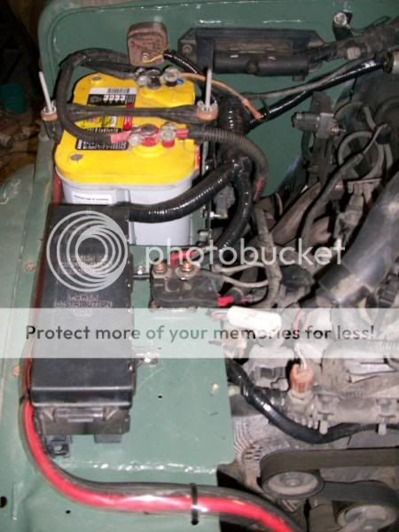

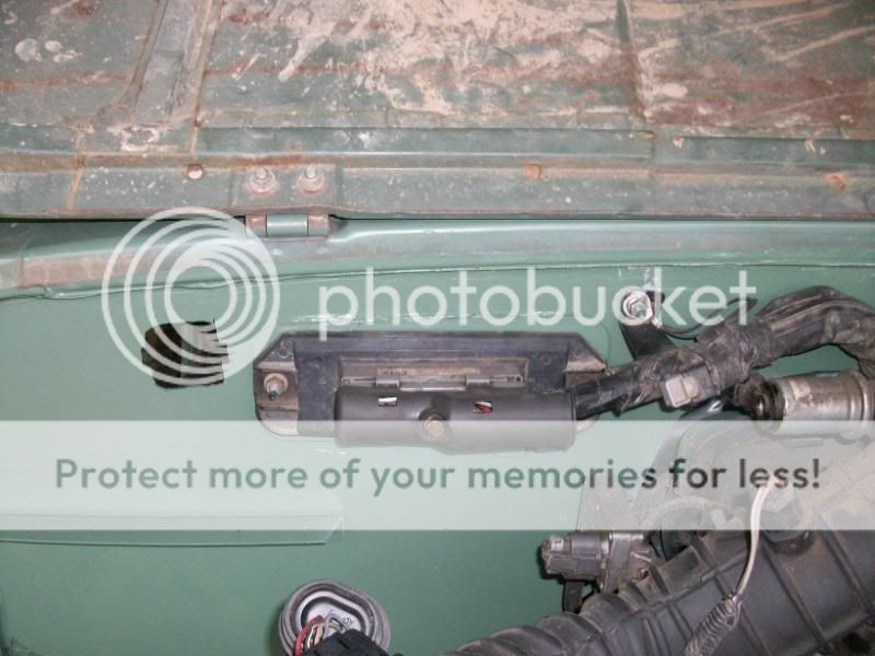

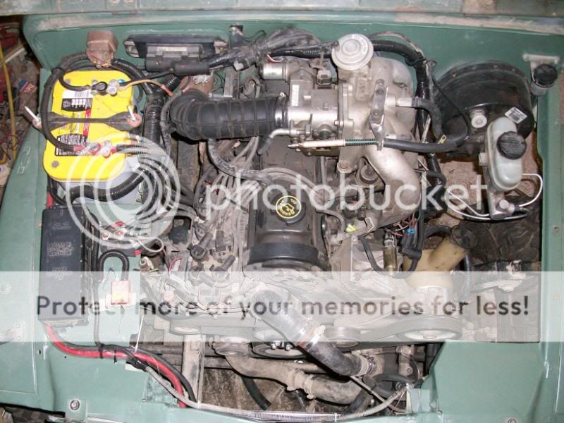

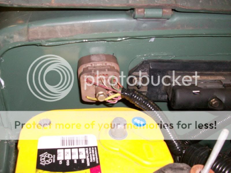

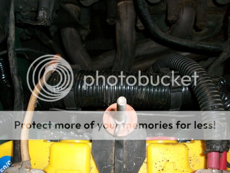

I got the underhood harness all buttoned up, I made a simple plate to mount the harness to next to the battery. (Which I realized when I took this picture that it's in backwards, the rolled edges were supposed to be rolled away from the harness, not towards it)
Project Fordzuki

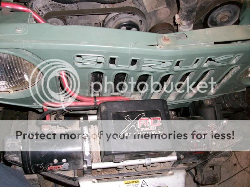

Got the battery cables ran
Project Fordzuki
The winch cables routed and hooked back up.
Project Fordzuki
Project Fordzuki

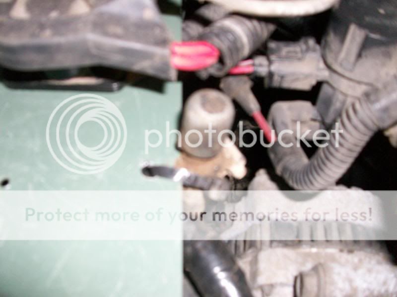

Front diff breather
Project Fordzuki

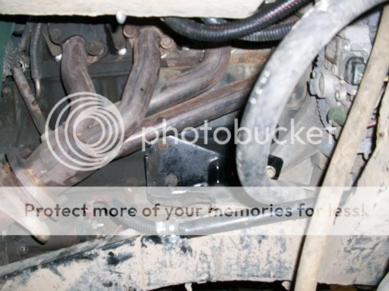

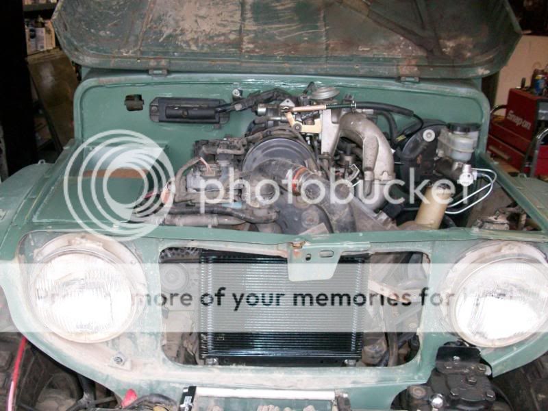

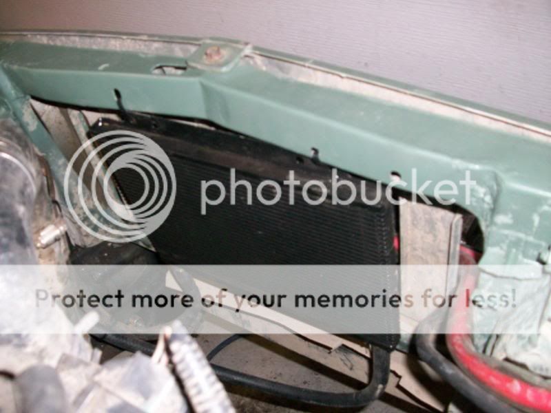

And the P/S cooler mounted. I can't wait for all the remarks out on the trail about how small my radiator is. :D

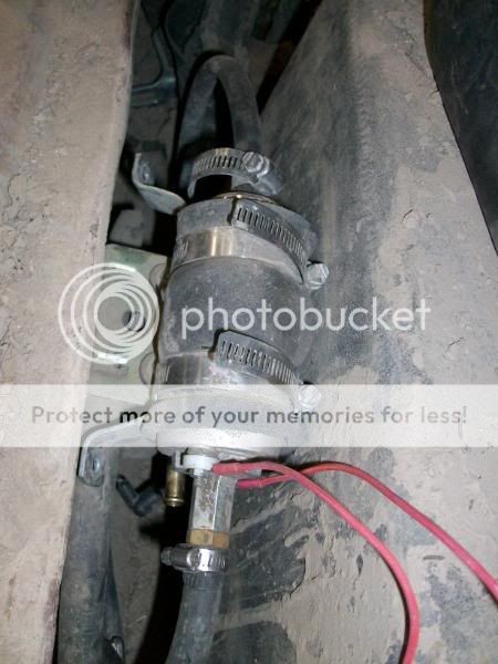

And here's the new fuel pump. It's quiter than the old one, which is a plus. This is just hooked up to make it start, I still need to take the old one out and plumb and wire the new one in right.

finish trans tunnel

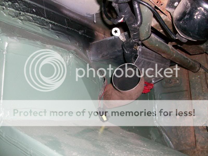

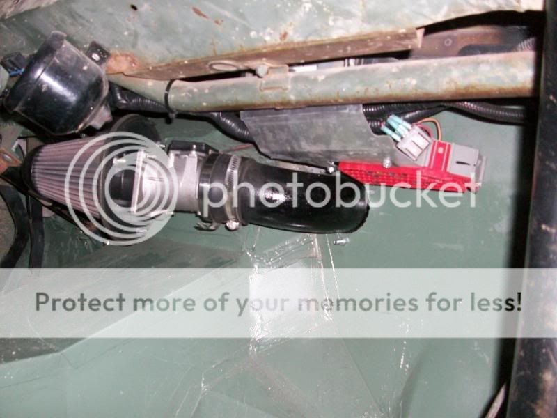

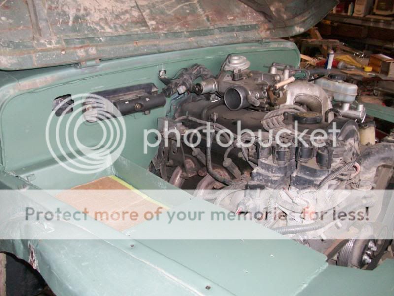

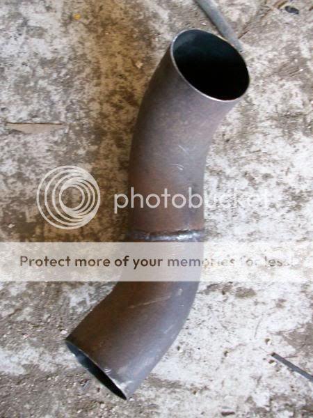

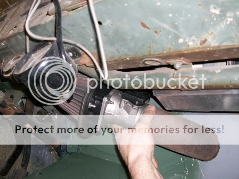

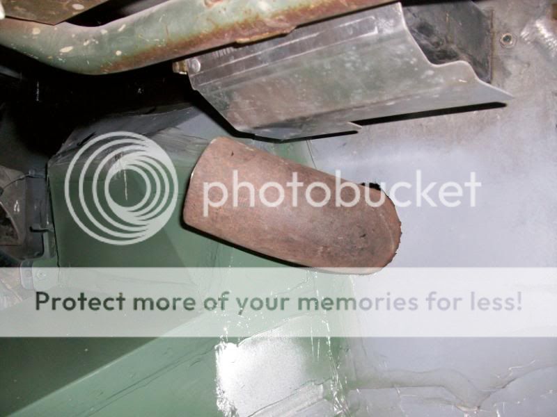

Well, I had a good day of progress today, got the intake all figured out, I'm only short one boot between the intake pipe and the maf. I ended up using 3" stainless exhaust to get through the firewall, tomorrow I need to make a flange to weld to the pipe where it passes through the firewall, so I can seal and mount it. I also need to make a bracket to hold the airfilter/MAF in place under the dash.
Project Fordzuki
Project Fordzuki
Project Fordzuki
Project Fordzuki
Project Fordzuki
I also finished the return line, ended up running hardline along the frame up into the back, then 3/8ths hose to the cell. And took the time to shorty up my shifter, in first gear it was close to the steering wheel.

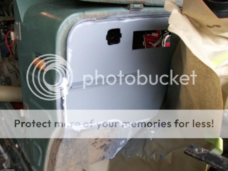

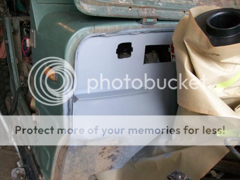

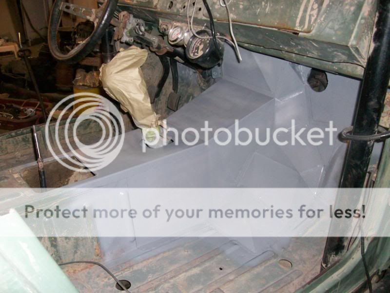

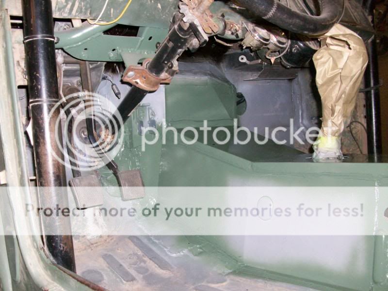

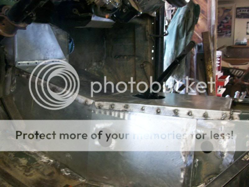

And I finally got the sheetmetal work done. :yahoo:

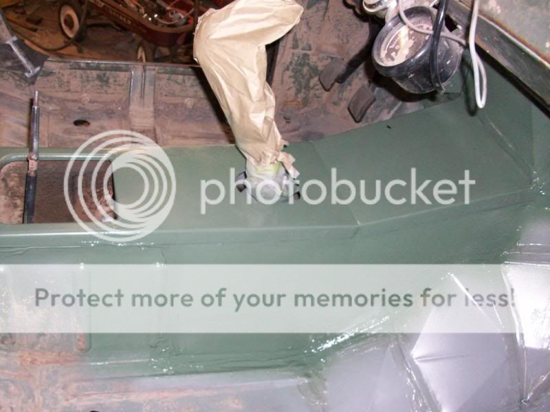

Got it seamsealed, and was able to paint this much before running out of paint. :annoyed:

So I went up to Lowes today and grabbed some more paint. Got the rest of the new sheetmetal painted, but spaced the whole cure time thing, so the new stuff wrinkled on top of the stuff I layed down last night. :annoyed: Good thing it's a wheeler. :icon_thumby:

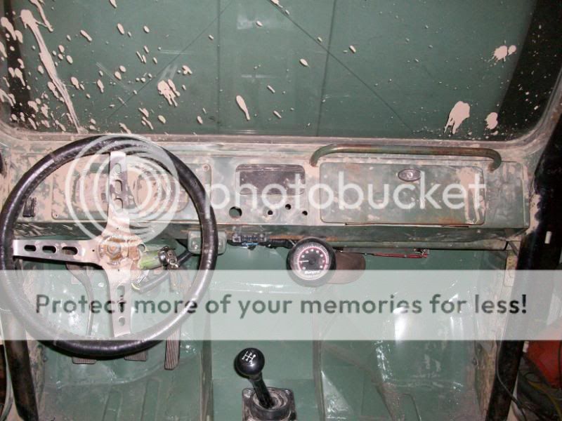

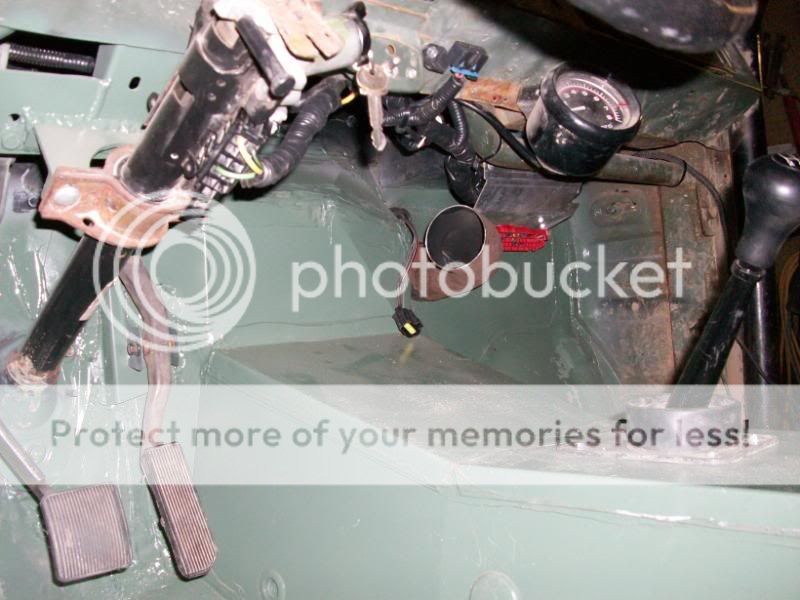

Today was a very productive day. After painting the rest of the sheetmetal, I started in on the body harness. I got the fan wired in, the fuelpump wired in, the headlights and taillights, and tach all wired in. I was able to run everything to the inside fuse block, and only had to run two extra wires to the front, which were the ground for the fan relay, which goes to the thermal switch, then to ground, and the headlamp power wire. I ran these in a seperate loom, and passed it through the firewall with a rubber grommet. I also got the MAF wiring ran through the firewall, it has the rubber plug that is supposed to pass through the airbox, in the firewall. I had no luck finding a boot for the intake, so I'll have to take a gander at work tomorrow and see what I can come up with.
The ignition was a little trickier than I had originally thought, I basically swapped wires over, color for color, but was losing power to the coilpacks when cranking. While testing, I couldn't find ANY pins on the ranger ignition that stayed hot while cranking. :icon_confused: SO, I ended up running the ignition switch from the ranger still, but only for power, then I ran the starter signal to a momentary switch. So it still has a locking steering wheel, and keyed ignition, with a starter switch.

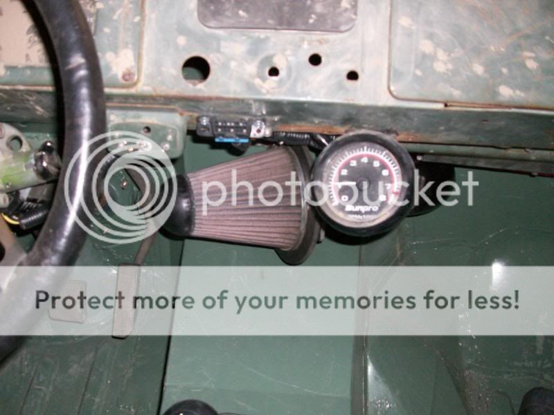

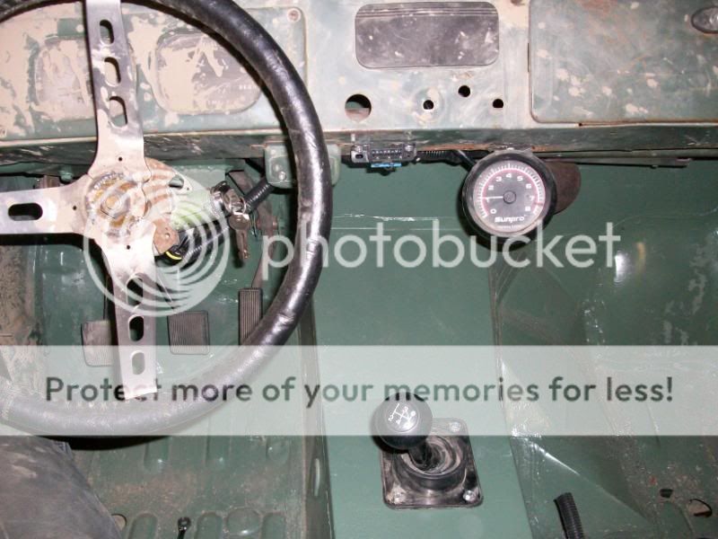

So here's the finished product as far as the dash goes.
Project Fordzuki
Project Fordzuki

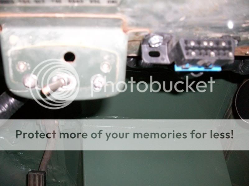

Ignition switch and OBD2 port

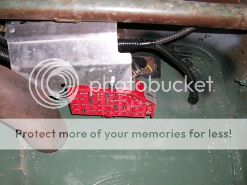

Fuse box

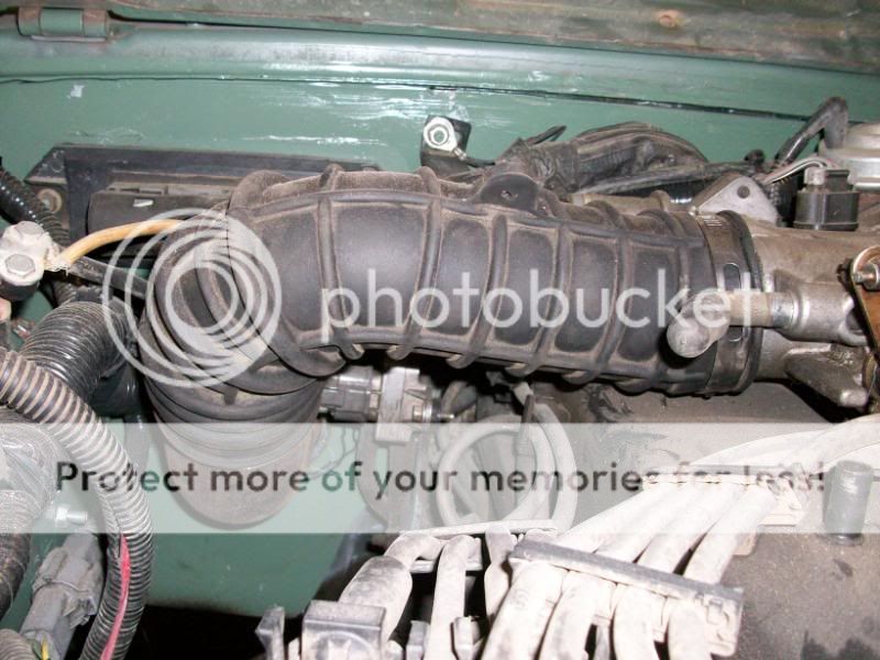

Intake tube and MAF harness
Project Fordzuki

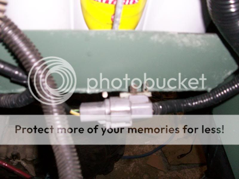

Fan thermal switch.

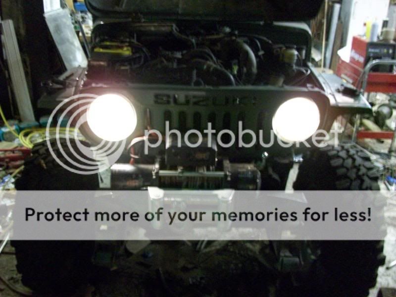

Headlights
Project Fordzuki

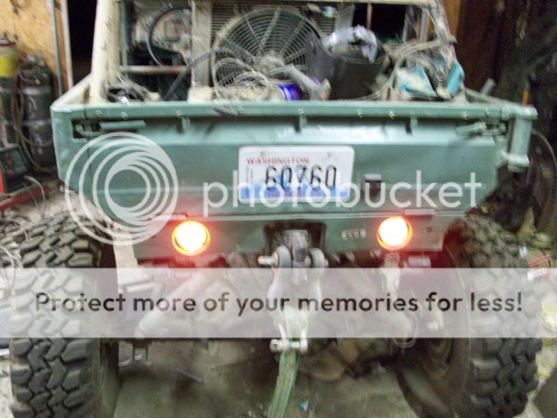

And taillights

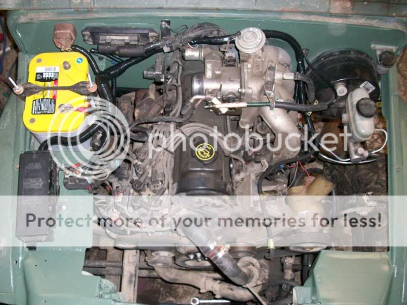

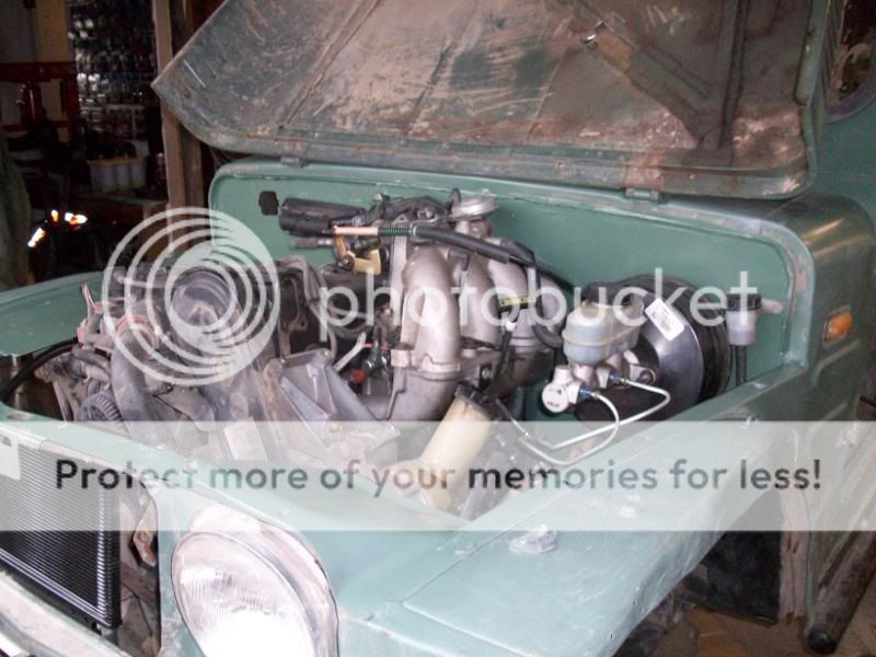

Finished product under the hood.
Project Fordzuki

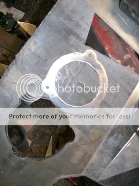

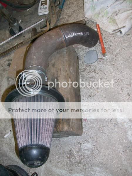

So all that's left now is to finish the intake, I have the flange for the firewall layed out on a piece of 1/8th inch, I just need to cut it out and weld it onto the tube. Then find a boot and make a hanger bracket once the aircleaner is in place.

I got the flange made and welded onto the intake tube, and got it bolted into the firewall.
Project Fordzuki
Project Fordzuki
Found a boot from a broken airbox at work. It was a pain wrestling it on there though, I may get a different one sometime.
Project Fordzuki
Project Fordzuki

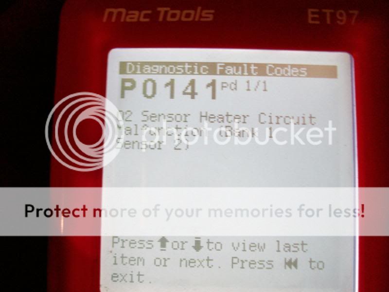

Ran it around out in the field for a bit, and ran codes, this is all it came up with. :headbang:
Project Fordzuki
That's the post cat O2 sensor, which isn't there. :icon_twisted:

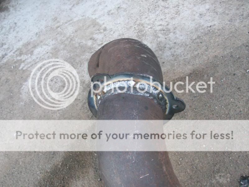

I spent a late night out in the shop last night (1am) and finally got most everything wrapped up. Exhaust done, seats done, new boot on the intake, and I solved my little overheating problem. I thought it was just air in the system, it would get up to 100* C real quick, so I got a flush kit and tried working the air out that way. I finally decided to pull the T-stat, and it was stuck closed. That knocked it down to 50* C, and it actually cools down a couple degrees when I stab the gas. :D

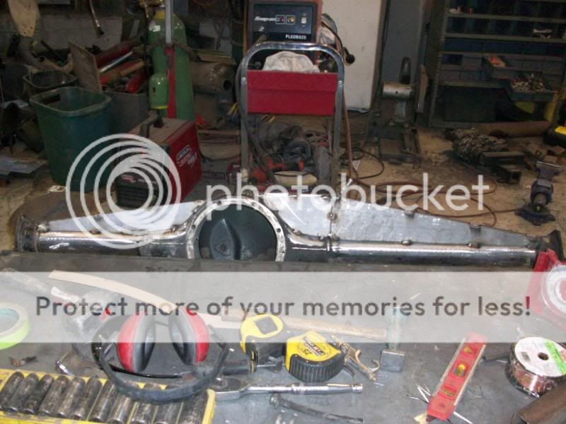

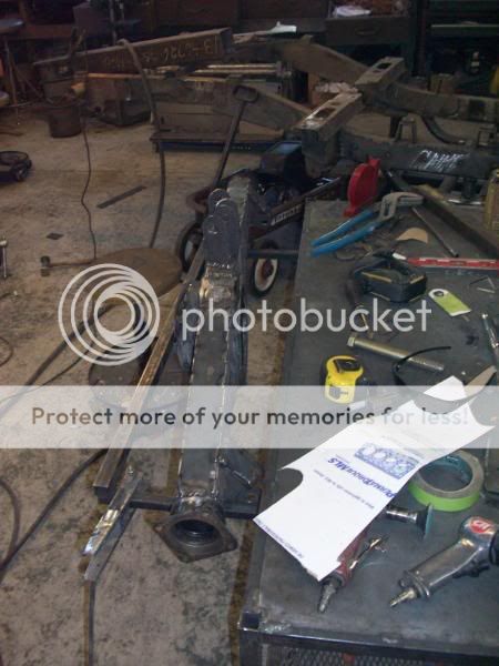

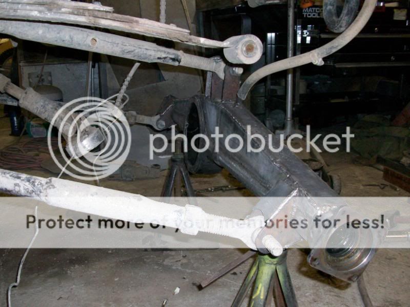

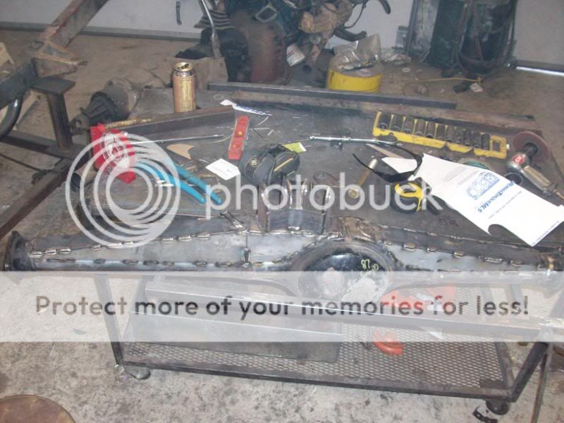

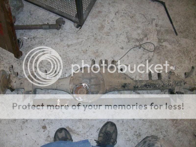

Well, the rear housing has been overdue for quite some time now, so I decided to finally dig in on it.
This was what the old one looked like after this weekend.
Project Fordzuki
Project Fordzuki
So here's the new housing.
Project Fordzuki

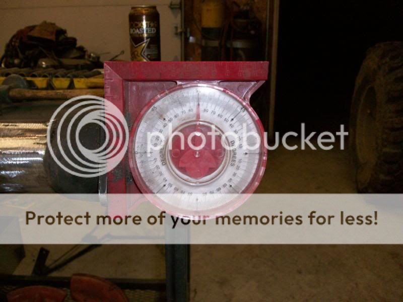

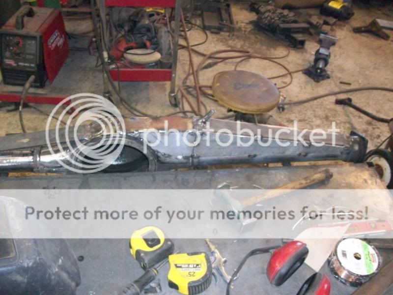

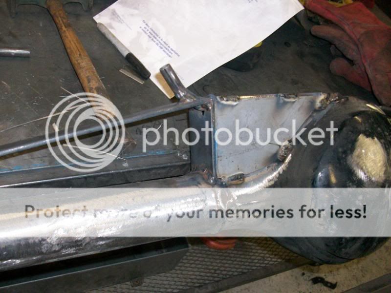

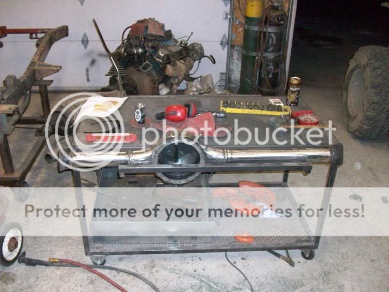

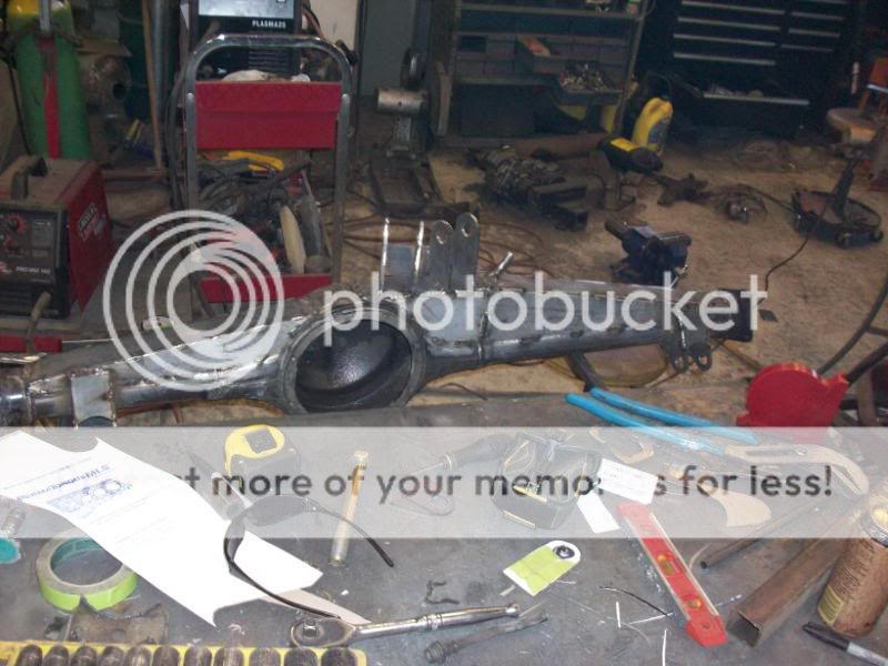

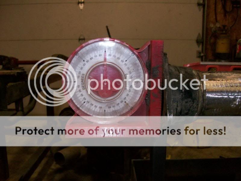

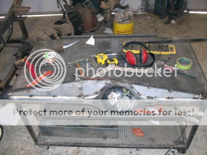

After leveling the housing on the bench, I made sure my ends were square
Project Fordzuki
Project Fordzuki

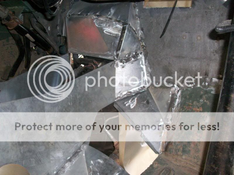

Started the truss with 3/16ths for the top, and 1/8" for the sides.
Project Fordzuki
Got the vent relocated, and a baffle in under the left side of where the upper link mounts will go.
Project Fordzuki
And started boxing it all in.
Project Fordzuki
Project Fordzuki
Project Fordzuki
Project Fordzuki
Taking the rest of the evening off, but I'll get back on it tomorrow night. :D

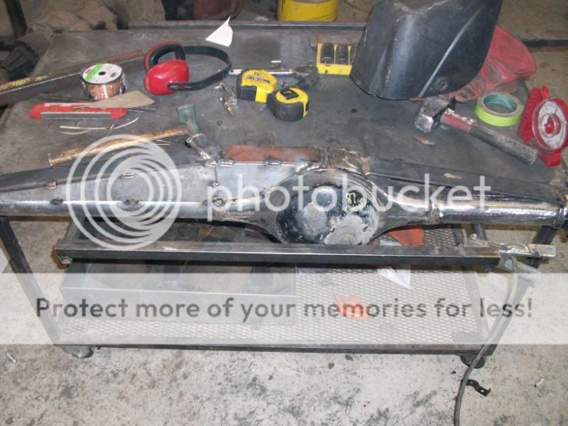

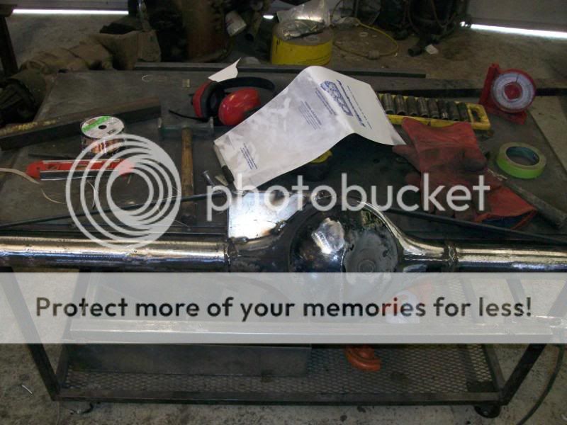

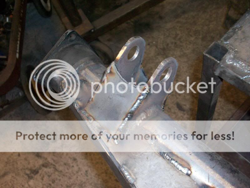

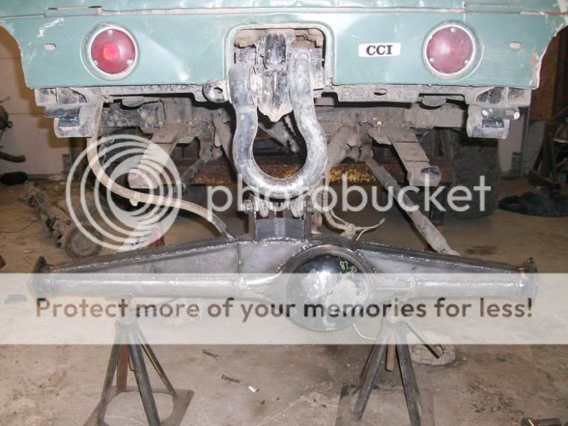

Ok, so I went back out the other night and got the lower link mounts made, then monday night got them welded on and the start of the upper link mounts. Then I ran out of gas for the welder, and the place I usually go was closed yesterday. :annoyed: So the link mounts are all made and tacked on, just need to hopefully get more gas tonight and get back to :icon_welder:

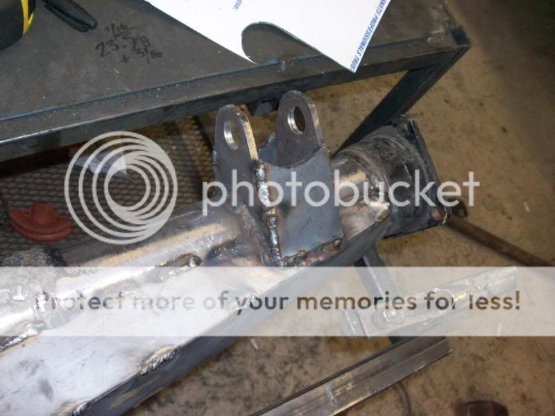

I decided to raise the links on the axle by 2", this will level out the links more, resulting in less flex steer. I'm also hoping that it makes it a little more stable on climbs. It will also give me that extra bit of clearance under the axle, since the old link mounts were under the axle, the new ones are more in front of the axle.
As long as I get some argon today, I'll be finishing up all the welding on the truss and mounts tonight, as well as making the new shackle mounts, and this thing will be done and ready for some abuse. :icon_thumby:
The truss is all welded up, and the link mounts are done. I just need to shorten up the shackles and add mounts for them on the axle, and add some shock mounts.

Threw it under the rig to check for shackle and shock mounts..
Project Fordzuki
Project Fordzuki
Project Fordzuki
And heres the old one with a piece of angle next to it for reference,
