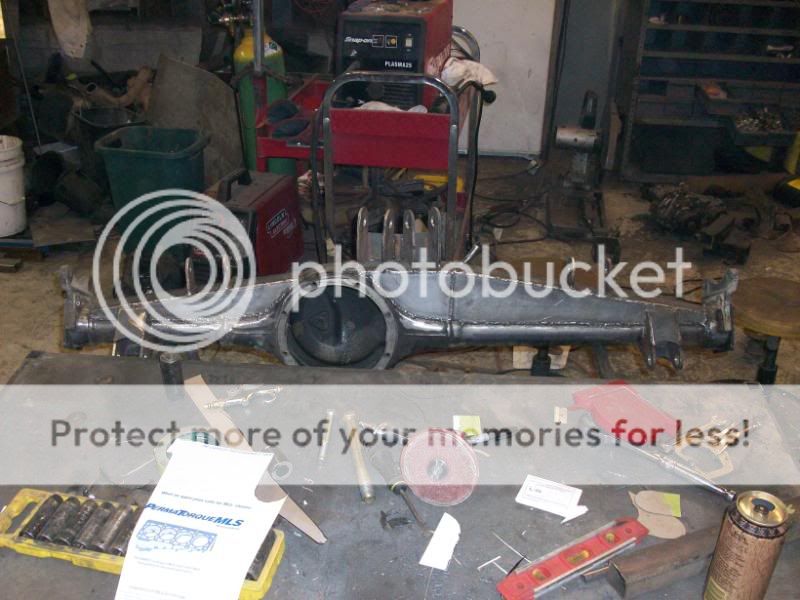

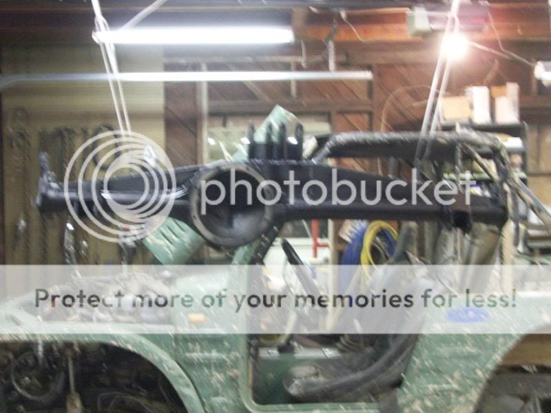

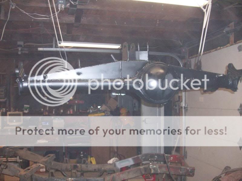

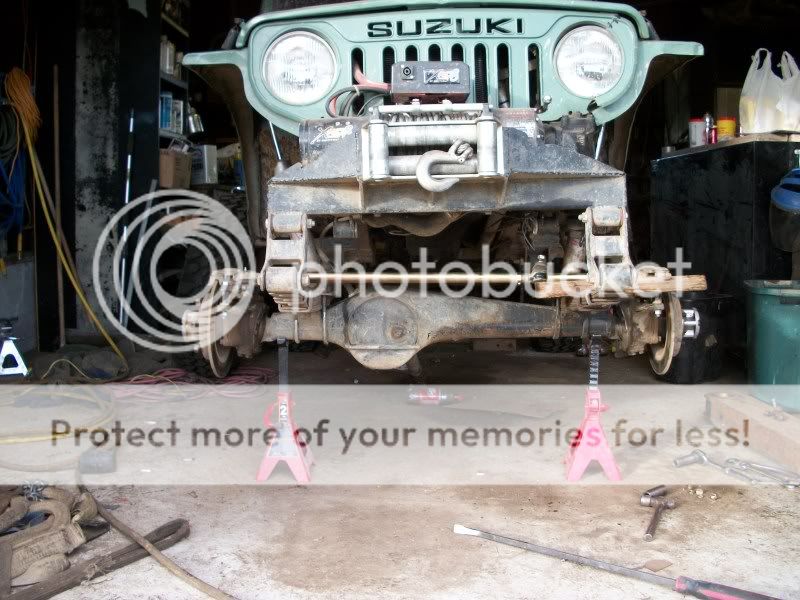

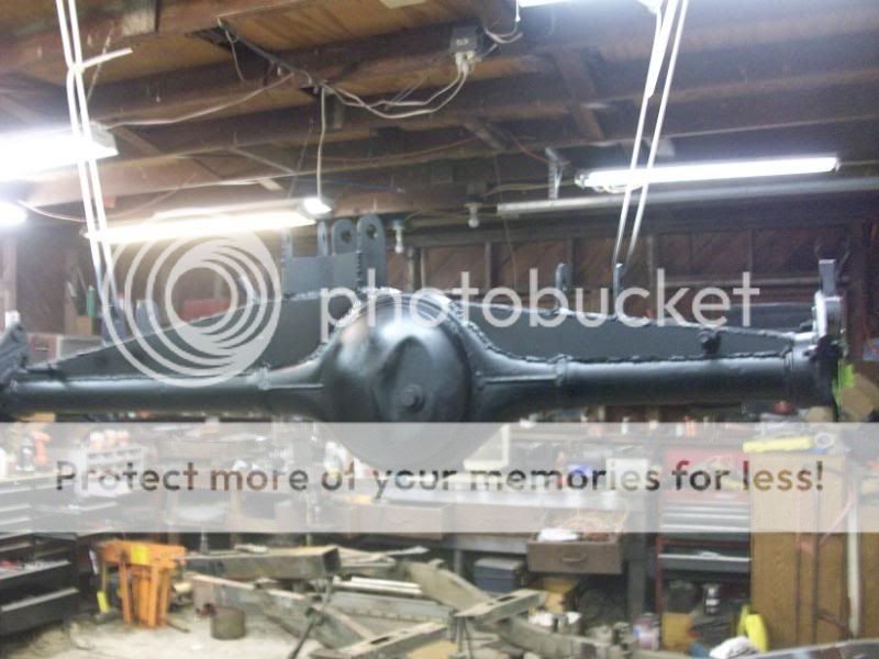

This turds all polished up. :icon_twisted: This is it. If these axles don't last now, I'm upgrading.
But for now....

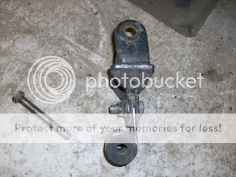

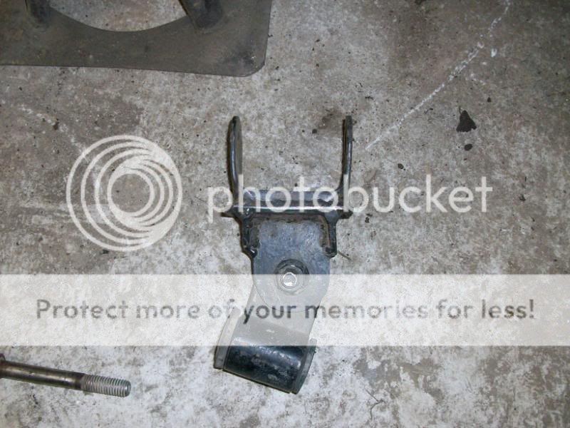

And the new and improved (well, old and improved) shackles.
So tomorrow night I get to swap the third and shafts over, and adjust the lower links a bit to swing the pinion up. Hopefully I can get it all together for the work party up at Elbe saturday. I've also been dealing with a bruised tailbone since yesterday too. :annoyed: Went to crouch down to put the bottom bolts in a fender, and one of my jackstands was behind me. :flipoff:

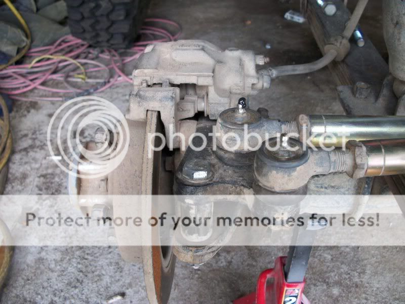

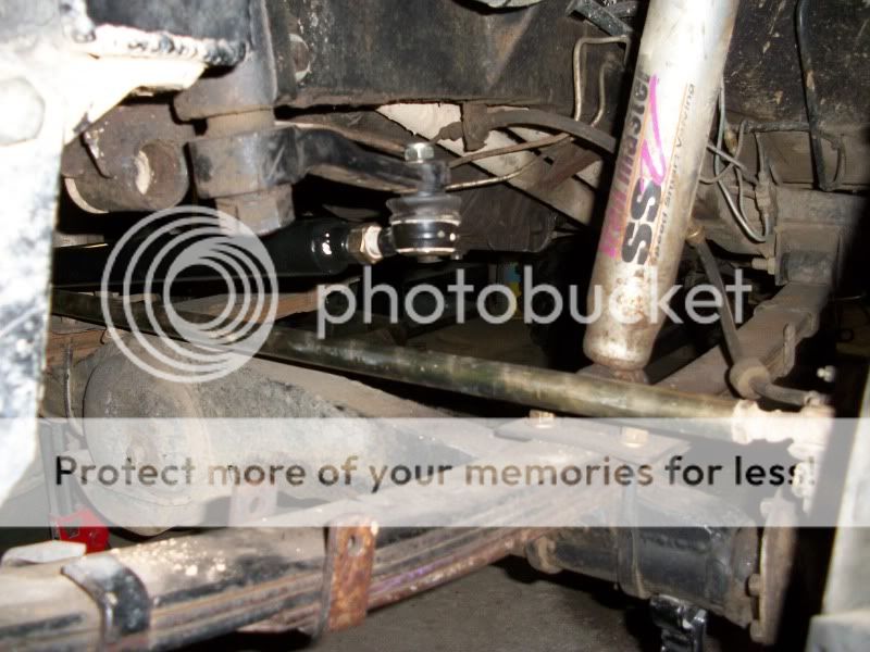

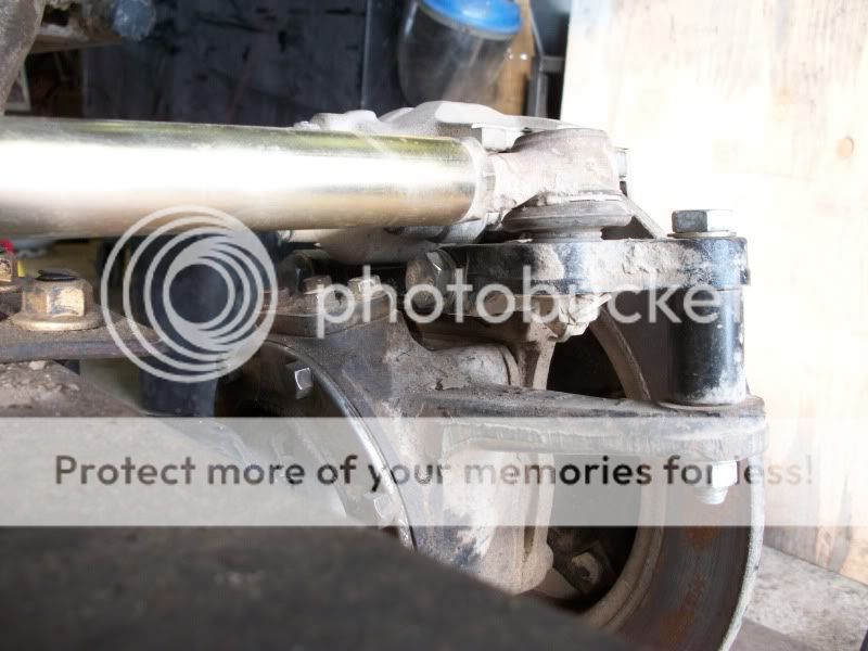

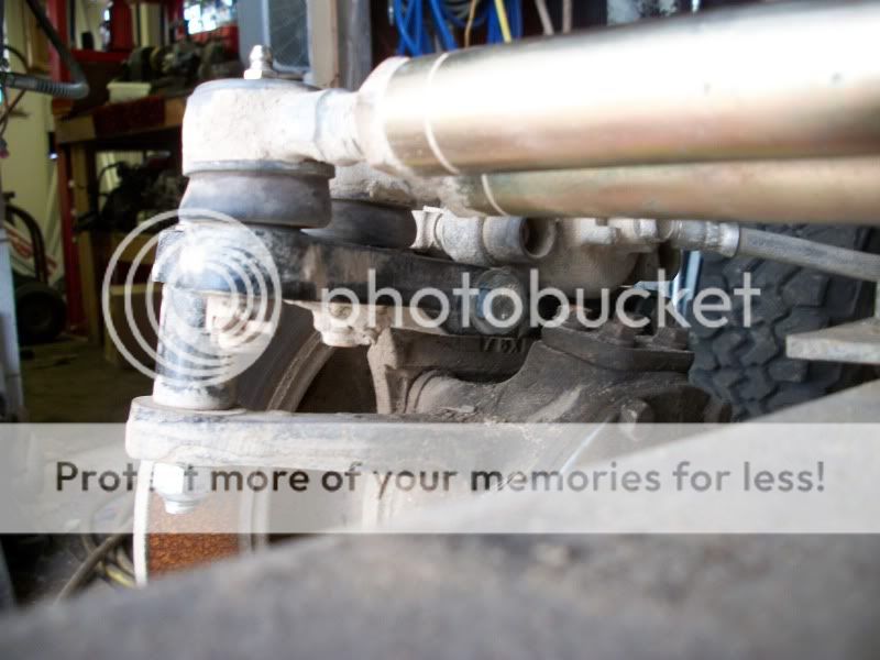

I found a sweet deal on a slightly used calmini steering setup, complete with arms, tierod, and draglink. I like the way these mount to the knuckle, and I finally decided, without a mill, I wasn't going to be able to make my own arms that wouldn't bend in the same spot. SOOO...
Only thing I need to do is get a longer draglink made up, this setup was for a stock sami with box inside the framerail, and mine is the ifs box outside the rail. So this draglink comes up about 3" short. That and I'm hoping I don't have to make a new pitman arm to compensate for the shorter length of the calmini arms, which sets the tierod closer to the knuckle than stock.

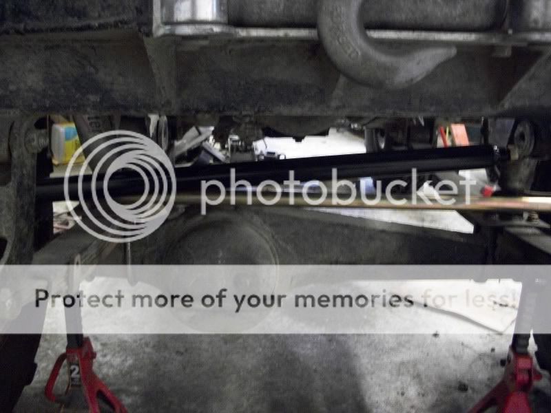

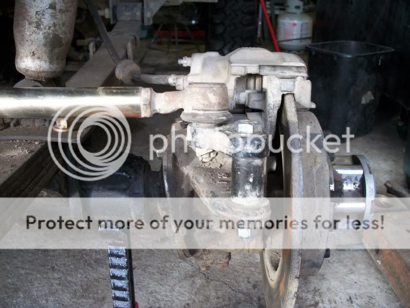

I got the draglink done. I was looking at options, trying to get it done for the least amount of money, but make something that was going to hold up. This oughta do it. :D

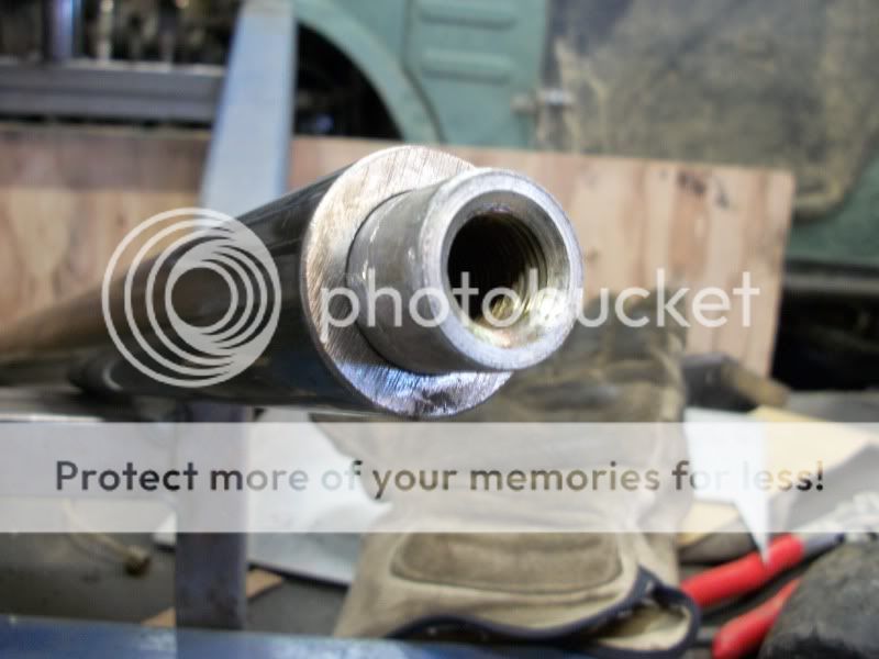

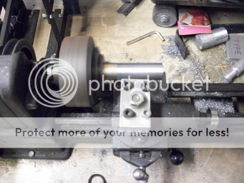

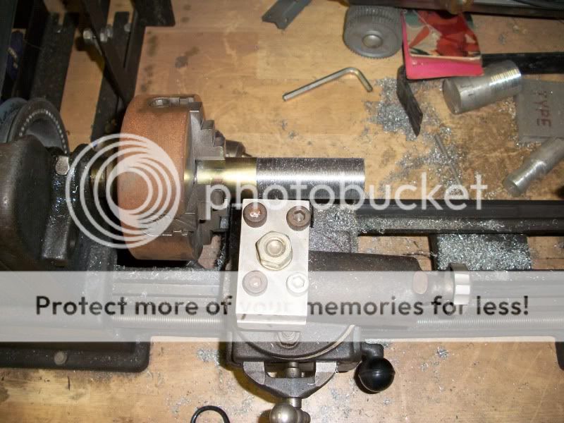

I ran up and got some 1.5" .250" wall DOM, and cut the old draglink ends off at 4". This gave me all of the threaded section, plus an inch. Well the calmini draglink was made from 1" .250 wall DOM, so 1.5" .250" wall should slide right over, right? :icon_rofl:
So I took the ends and chucked them up in my old craftsman lathe, passed down from my grandfather, and knocked them down a couple thousandths.
And there it is. I've got more of the DOM, so I'll likely do the tierod the same way eventually.
I also swapped out the power steering cooler for a smaller late model ranger one, I think the large plate style trans cooler was causing bleeding and cavitation problems. While I had the front end up, and the draglink unhooked, I bled the system out, and it made quite a difference. I also found that if you hold it just back from full lock and let the res drain back, then go to the other lock and repeat, it bleeds more air than just going back and forth from lock to lock. :icon_cheers:
