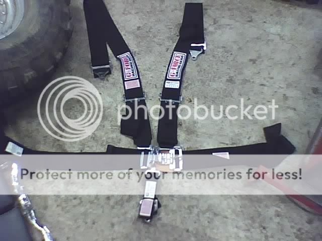

Not much going on lately, been real busy with family, and working on my Dads ranger. I did however just pick up some harnesses tonight from a buddy, he got them awhile back to put in one of his trucks and never got around to it, needed some cash, so I picked them up for a deal.
G-force black 5 point harnesses. 2 of them :icon_hornsup:

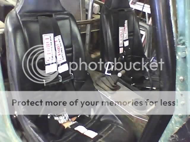

Thanks stumpy, here they are installed.

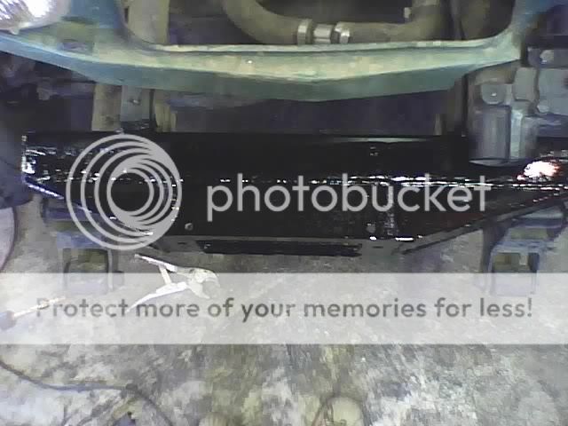

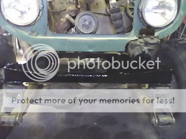

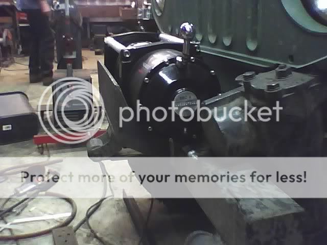

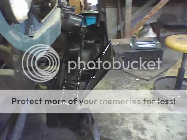

Got me a winch! Me and my dad each got a new xrc8, and been mounting them up last night and tonight. I built the cradle for his first, and after finishing his up tonight, I started in on mine. Got the majority of the cradle made, I just want to add a few pieces from the cradle to the outer edges of the bumper, to kindof tie everything together, and make it look a little better. Still have to drill the mounting holes, cut and drill the fairlead holes, and wire in the winch. Should be done tomorrow night, just in time to try them both out saturday. Here's a couple pics of tonights progress, I'll post up a couple finished product pics tomorrow night.
I had to offset it a bit to the passenger side to clear the steering box.

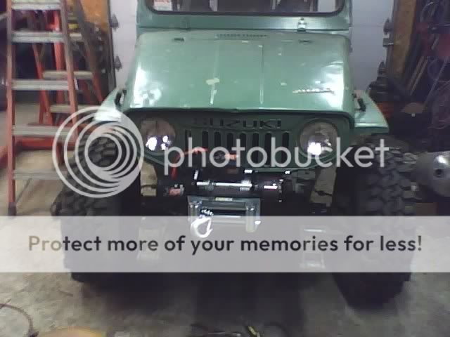

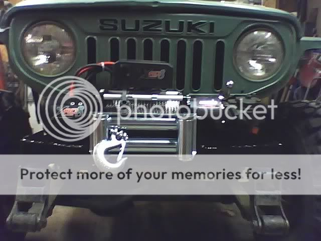

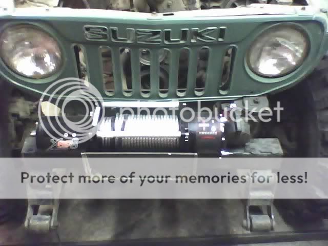

Got the winch bumper all done tonight, and the winch mounted and wired. Here's some pics.

Is a "xrc8" an 8000lbs. winch? I'm pretty my dad only had a 4500 winch on our old Samurai...

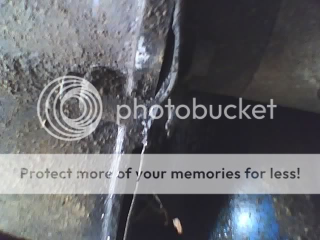

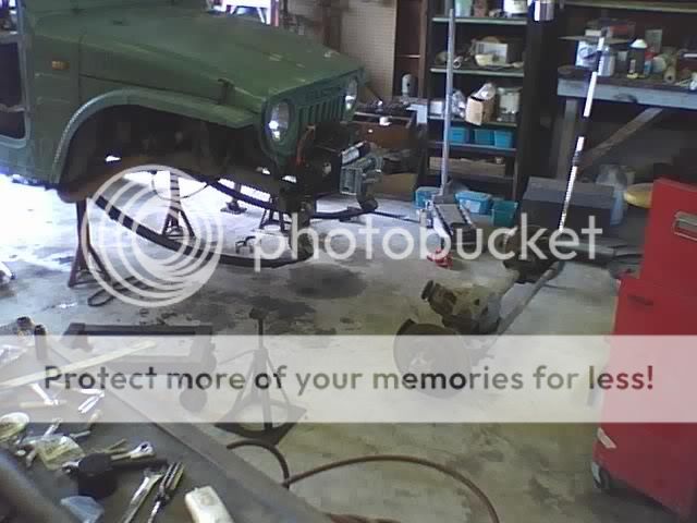

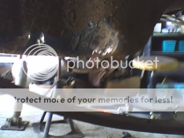

Ever since I extended the front shock towers, I have been having troubles with the front driveline rubbing things. First it was the trans crossmember, so I cut the hoop out, and extended it up a couple inches. Then it started rubbing the trans bellhousing, and the plate between the motor and bellhousing. Well, aparently I have way too much flex up there, because at some point yesterday it ended up hitting the oilpan, which is a good 4 inches away at ride height. So yesterday on the way home from Elbe, I stopped and picked up some more DOM tube, so I could retube the driveshaft, which got bent hitting a bump and coliding with the trans crossmember. It was just a slight wobble, but between that and the two spots it had rubbed, I decided to just retube it. First I had to take care of a few things to keep it from rubbing again, so I started this morning by taking out the old shaft, and removing the front axle. I wanted to roll my pinion back down from where I had set it when I first built the rig. So I cut the perches off, cleaned them up, and set them back on. Before rolling the axle back under, I added a leaf per side that I had taken out awhile back to get some added flex. This will actually level it out a bit, cause the rig had a little rake towards the front, and with the added weight of the winch, it was looking like a shackled up GTO. So I got the leafs in, rolled the axle back under, and set my pinion angle to where I wanted it, and tacked the perches on. Rolled the axle back out, and welded the perched the rest of the way on, and back under the rig it went. I got the front end buttoned up, and moved on to rebuilding the driveshaft. I ground and knocked the ends out, cut the new piece of tube, and pressed the ends into the new tube, making sure both ends were perfectly in phase. The shaft is bolted in now, ready to balance out, tack, and pull back out to fully weld the ends on, which I will get to tomorrow night.
The bellhousing/plate where the driveshaft was rubbing. Luckily no break through.
Project Fordzuki
The oilpan where the pinion and ears of the driveshaft yoke collided

A shot of the front axle out.

And dogboy, yes the xrc8 is an 8000 lb winch, really shouldn't need that much, but for the price, I couldn't justify getting anything smaller.
