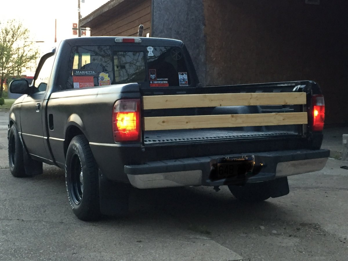

Closed up the truck bed by mounting 2x4s as the new tailgate. Finished it with boiled linseed oil.

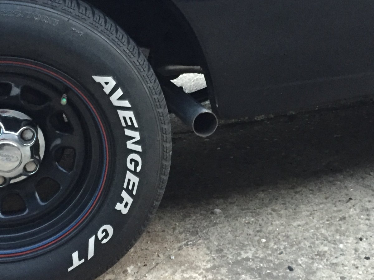

-Summit 2 chamber muffler with side exit

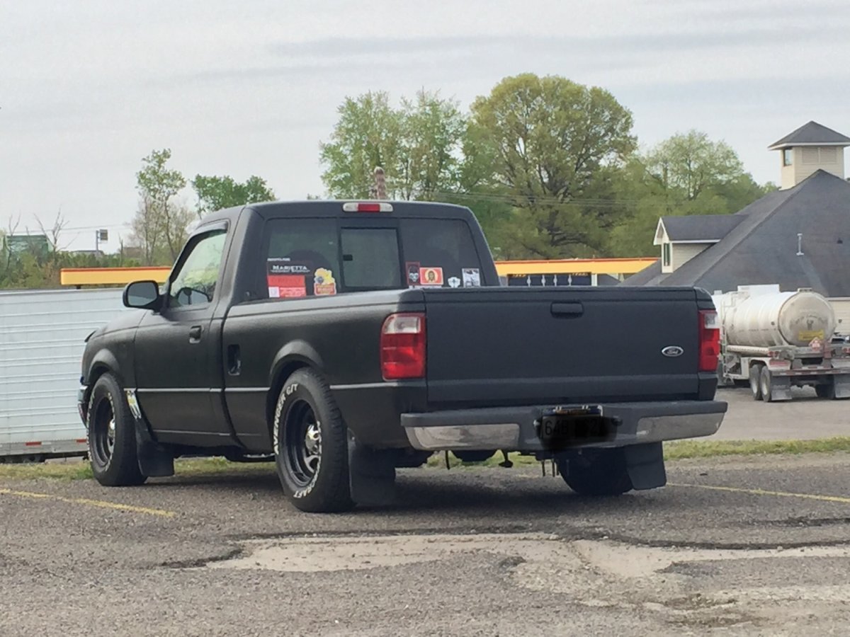

Need to lower the rear 2 inches with some lowering blocks.
The sway bar was easy to install. Would’ve been much easier if that darn fuel tank wasn’t in the way.

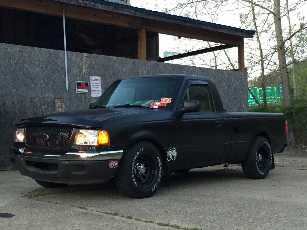

Got revved at by a lowered S10. It seems people are starting to notice the ‘02 Ford truck (as opposed to the classic ‘32 Ford truck).
I don’t like those mirrors. Not very hot rod. Very modern and gay. I like the 80s Bronco or Ranger mirrors more. The junk yard didn’t have any candidates, unfortunately.
I’ve gotten her stance just about the way I like it now with the 2” blocks added. I don’t think I need a notch kit, but it’s too early to tell. I also prefer the tailgate the way Ford intended it to be.
Driver side: F 27.5” / R 27.25”
Pass side: F 28” / R 28”
Measurements are a lot closer than what it started out as.
