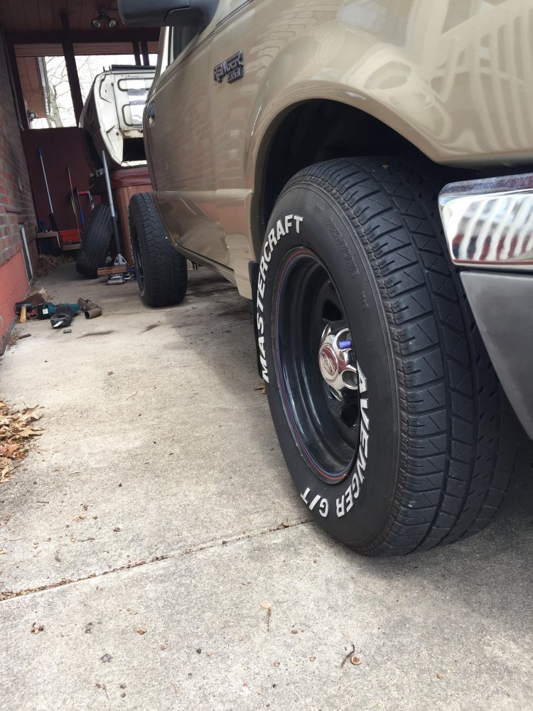

Labor day weekend with new wheels/tires.
Should have got the springs and flip kit installed, but was stalled by a lack of tie-rod fork...
What kind of wheels/tires did you get? They look good!

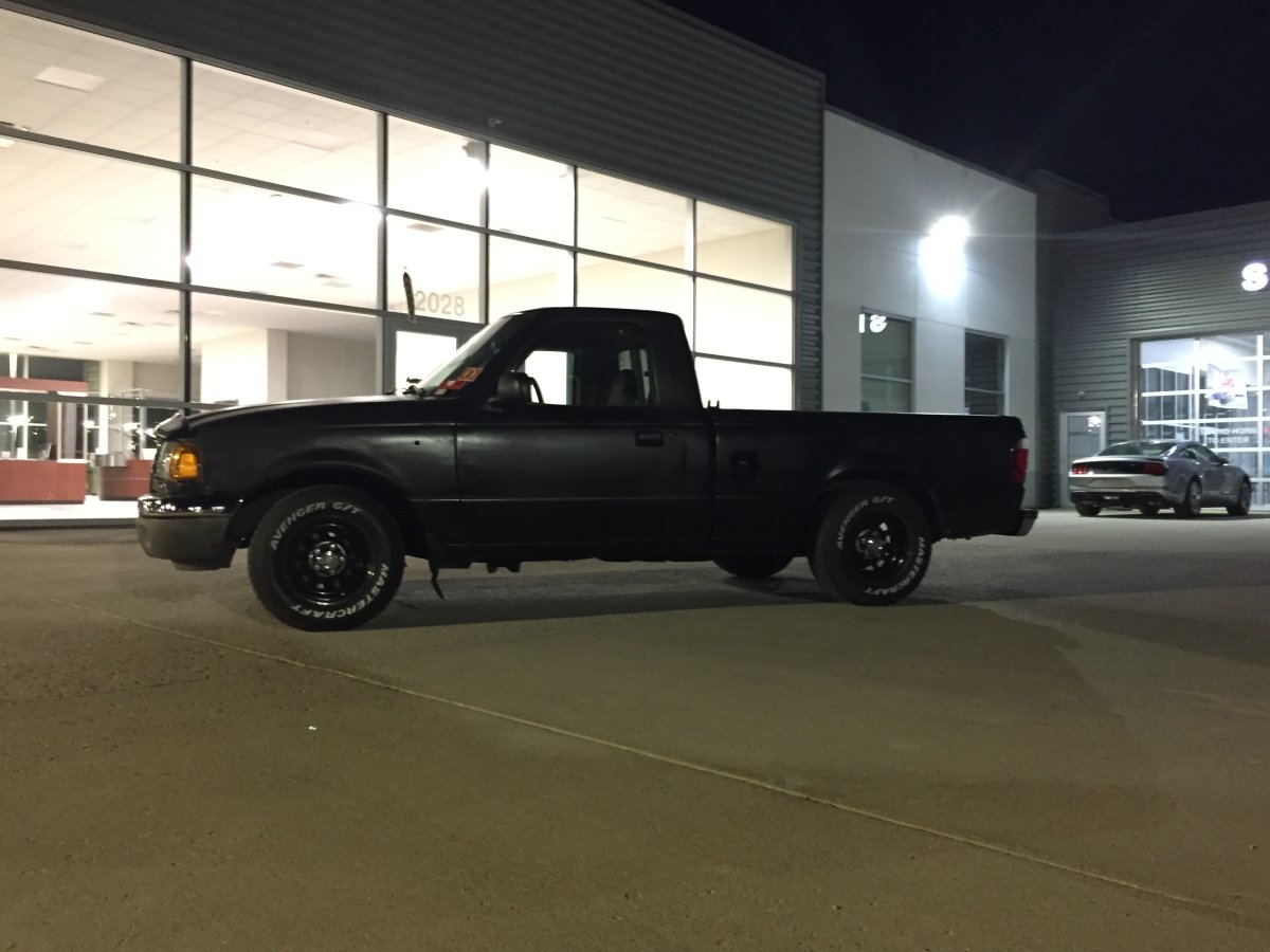

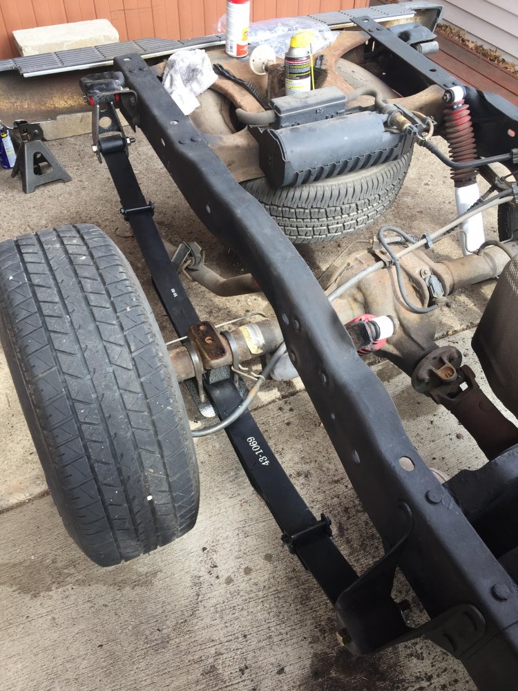

Here are the results of one months work by myself. Both front Belltech springs and shocks are in. Rear DJM on the passenger side is done. Still have one more corner to go. With the fuel tank being in the way, I suspect I'll need to cut off the front spring bolt, and possibly the rear as well. The driverside leaf also sags, so I'm thinking another new leaf will be needed. Reused the shock bellows from the old Rancho shocks since the DJM shocks didn't include new bellows.
The front springs were supposed to bring her down 3", but I'm not seeing it. Maybe I just need to drive it on the new set up for it to settle.

The frame was also in pretty decent shape. No perforations. All surface rust only. Scraped, sanded and sprayed with different kinds of rust products:
  • Rustoleum Reformer/paint
  • Harbor Freight rust reformer
  • Duplicolor Rust reformer/paint
  • Some generic rubberized undercoating from O'reilly's.
58238
I'm going to be removing the spare tire shelf. That's why I haven't touched it with the rust sprays.
Thank you. The wheels were the Jegs steelies and tires are Mastercraft Avengers.
The 3" front drop assumes you have a 4.0/auto... As your engine is about 100lbs lighter you will see proportionately less drop...
Interesting theory.
Here's the one on the truck: It's for 2002 Ford Ranger XLT 2.3l L4, RWD, Standard Cab Pickup
You will note that spring part number is same for all coil spring Rangers from '98 to '11, no differentiation for RC SB/RC LB/SC SB, engine size, transmission, or with/without a/c). While Ford had 5 different options.
The amount of lowering achieved for a 4.0 SC SB with A/C & auto will be a lot more than a 2.3 RB SB with manual/without A/C.
No need to get defensive. My reply to you was neutral.
I don't think he was being defensive... he is a really helpful fella.
Honestly... I don't believe it's a theory... it's simple physics.

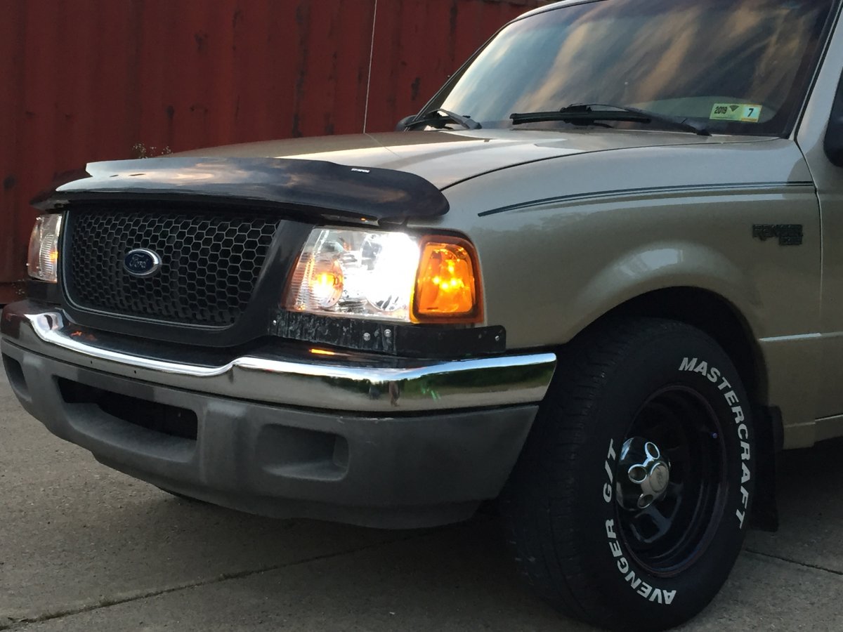

The driver-side is lower than the passenger side for some reason. The only thing I can think of is that maybe the passenger side LCA is tighter than the driver-side LCA. Just been too lazy to crawl underneath.

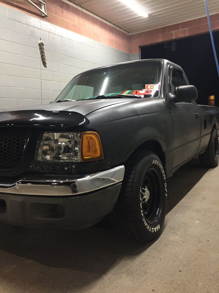

Broke the piece of the grill that slides underneath the headlight, so I patched it with an old license plate. It'll pass inspection now.

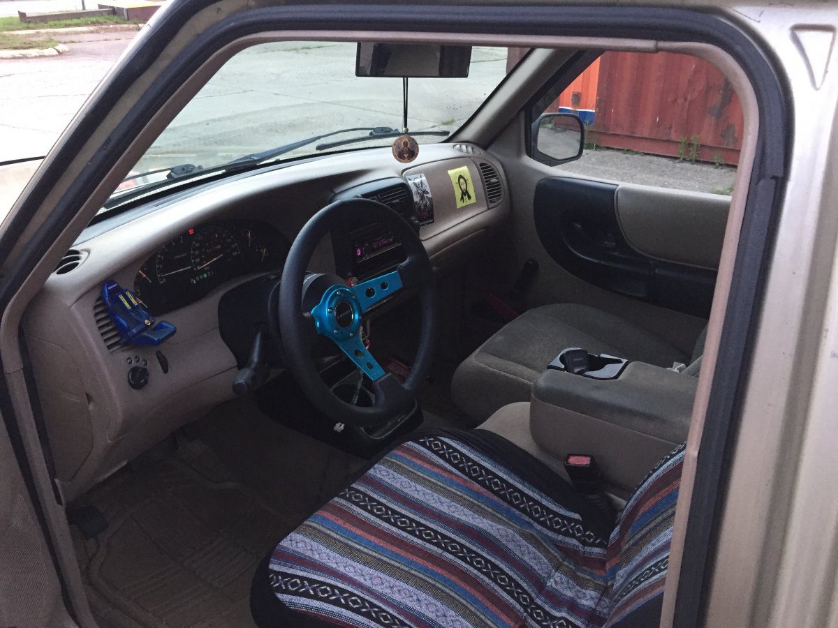

And replaced the steering wheel with something lighter.

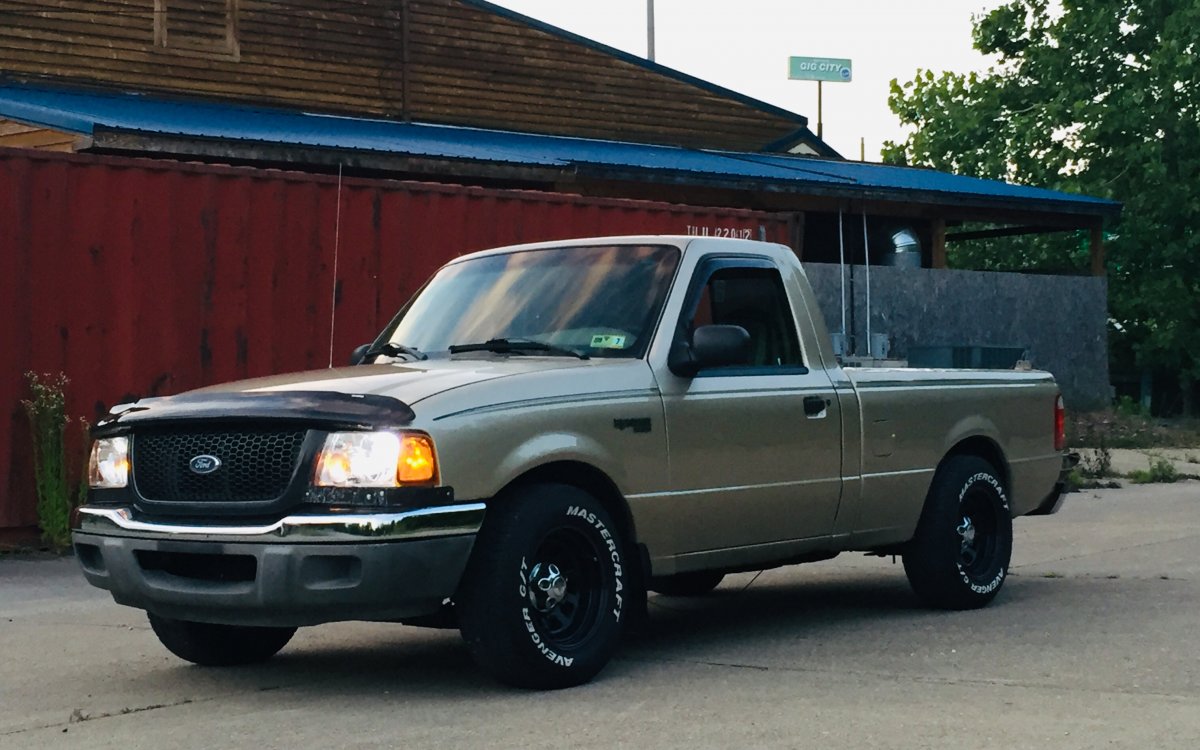

Replaced valve cover gasket, plugs, transmission filter, rear end gasket. She's purring pretty good now. Probably should change the brakes out soon. Need to reconnect the parking brake. And re-route the exhaust. Had to chop the exhaust when I flipped the springs, and I didn't quite chop it far enough so now it's hitting the pipe every time it compresses.

You shouldn't tighten lca while jacked up. So if you loosen then retighten while it's on the ground it should level out... its preloading the suspension sort of ish. Nice build keep it up!

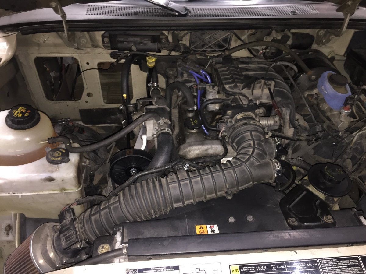

A lot done in the past couple of weeks. Rattle canned and removed the ac/heater.
73772
Still need to patch the hole in the firewall and finish building the wooden tailgate.
