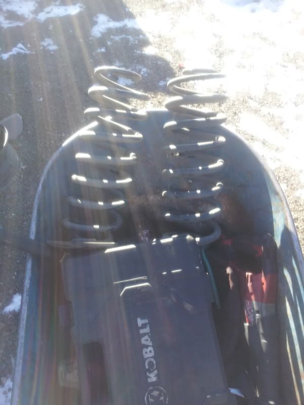

I snagged the coils for the 4 link rear. Expedition coils are nice and tall and should be firm enough I can still haul stuff on the bed.

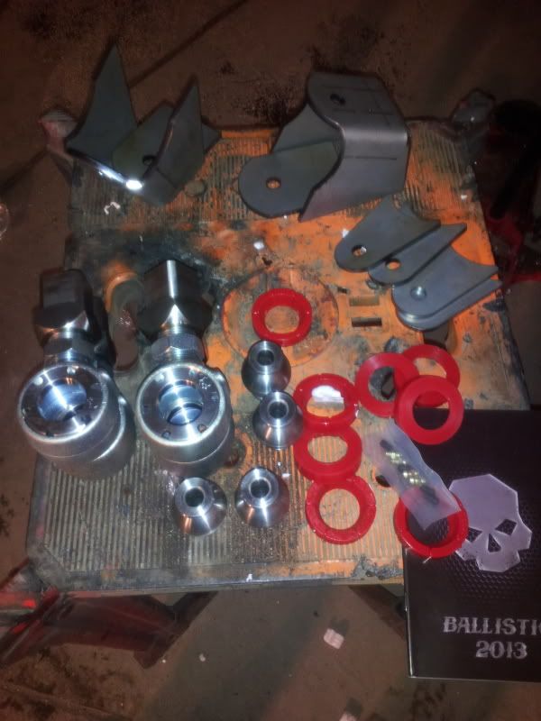

Got some more goodies for Double R!!!
Parts for the 4 link....
