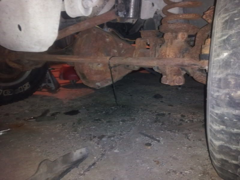

Started another SAS swap on 92 Ranger 2wd 2.3 5 speed. My buddies truck. He plans on swapping 5.0 5 speed and 205 into it next. Here are some pics we started Monday afternoon after junk yard run to grab some chevy leafs.
The axles use are early 70s Bronco 44/9 combo. This swap is super easy and fast. Only thing left is the trans crossmember and building a drag link. Then little stuff like brake lines and shocks which he is going finish up when he gets back to Iowa. We used the factory radius arms, track bar, and most of the factory steering.
He plans on getting some larger coils for the front and getting some long shackles for the rear and adding another leaf to the rear. The Chevy leafs came off a 3/4 ton and were 5 leaf we broke them down he wanted to go 3 and I wanted to go 4 leafs like RR. But we did what he wanted afterwards he is like we should have done 4. LOL
Ik it's been awhile since uve done it but how far up did u move the coil spring perches on the Dana 30 Im also doin the swap just wondering if moving the perches would make any difference or to get the axle centered better.
center them directly over the axle tube
Yeah you have to move them or you will have a bunch of issues if you want to use stock location on the frame side of thing.
