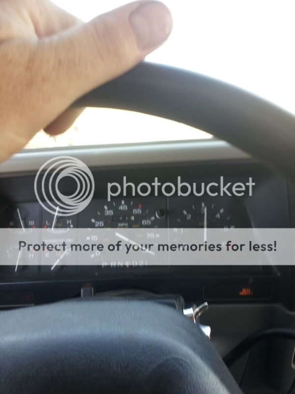

In this pic I was testing out the hydro assist at 85 mph. Works great!

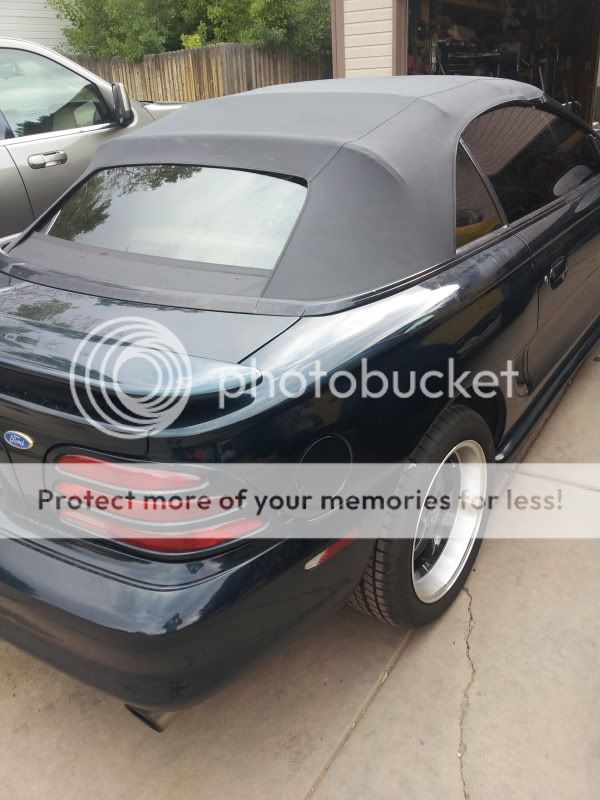

Spent a good portion of the weekend putting a new convertible top on the wife's 95 GT. Plus it was my oldest son's bday and my nephews came over to stay the night so I didn't even get any time to work on it.
Top turned out nice but I never wanna do one again it took forever...

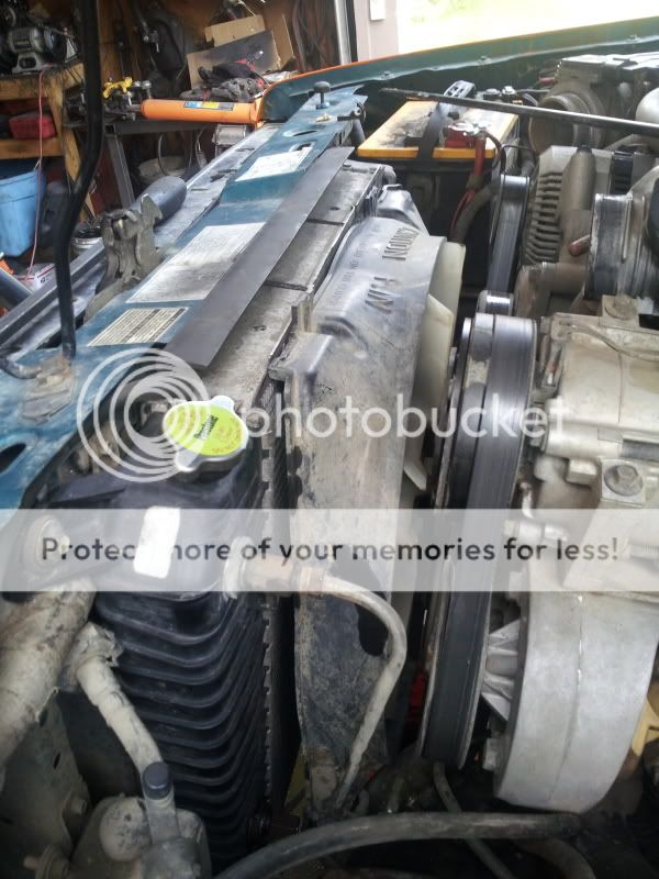

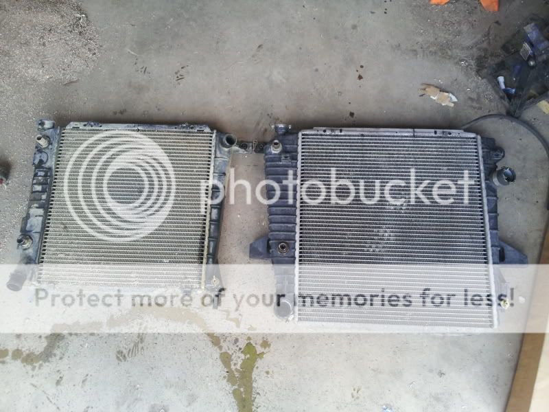

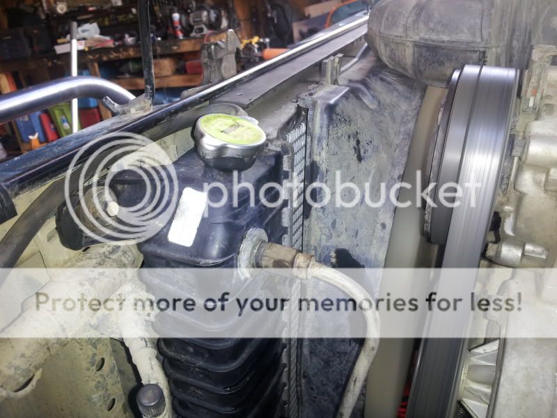

Got the 2nd Gen in took one from 98 4.0 4 door auto with AC. Works like a charm and needle stays on the M of normal with AC on idling in 99 degree weather in my driveway. LOVE IT!!!!! Here are some pics.
Here is the stock Ranger(two row biggest stock one you can get) radiator next to the 2nd gen Explorer radiator...

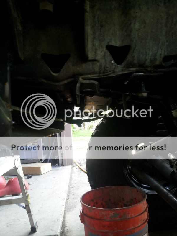

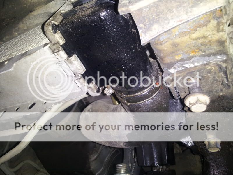

Lower hose reaches just fine. You have to cut out that retarded steering skid thing to make this fit.
Project Double R...
As you can see the Radiator sits well above my bumper skid so I don't even have to change anything with the skid.
Project Double R...
And the engine running all the lines fit like a glove. Just had to move a wire harness out of the way nothing major just unbolt the hangers and push it over enough to bolt up the radiator. You will have to drill a couple new holes over inch since the new radiator is wider. Also if you look at the pic above you will have to cut some of those plastic wings off the new radiator since they stick out too far. Right now I have just the uppers holding it seems to be strong enough but I am going back to the JY and getting the rubber isolators and will use those to support the new radiator on the frame more pics when I get that done.

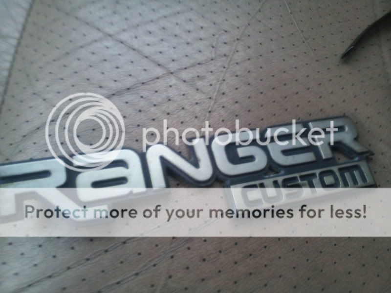

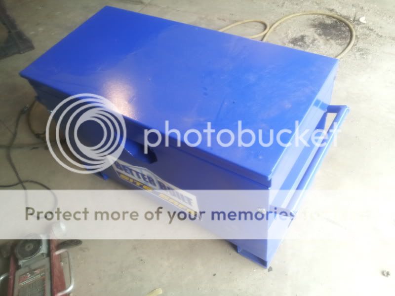

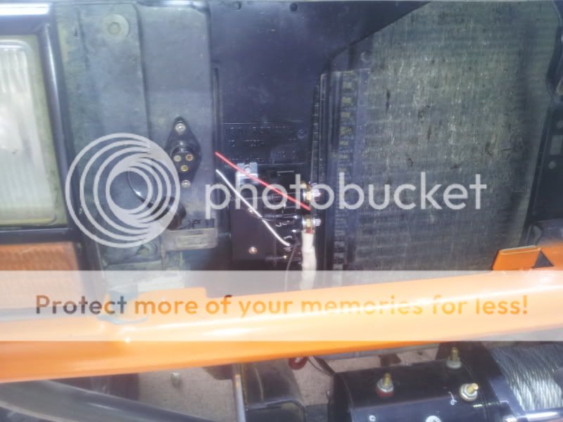

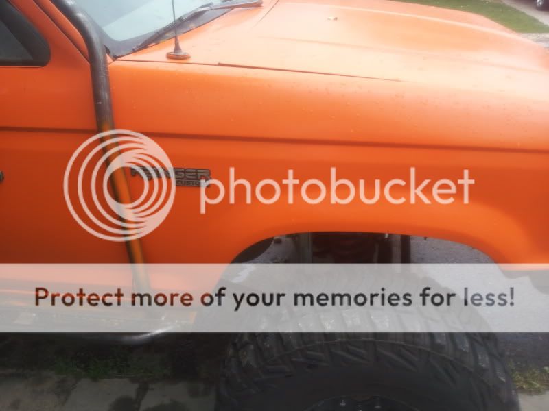

Worked on the truck a little today getting it ready for Holy Cross. Found a Ranger emblem at the JY and got the winch hooked up. Picked up a tool box for the back too.
