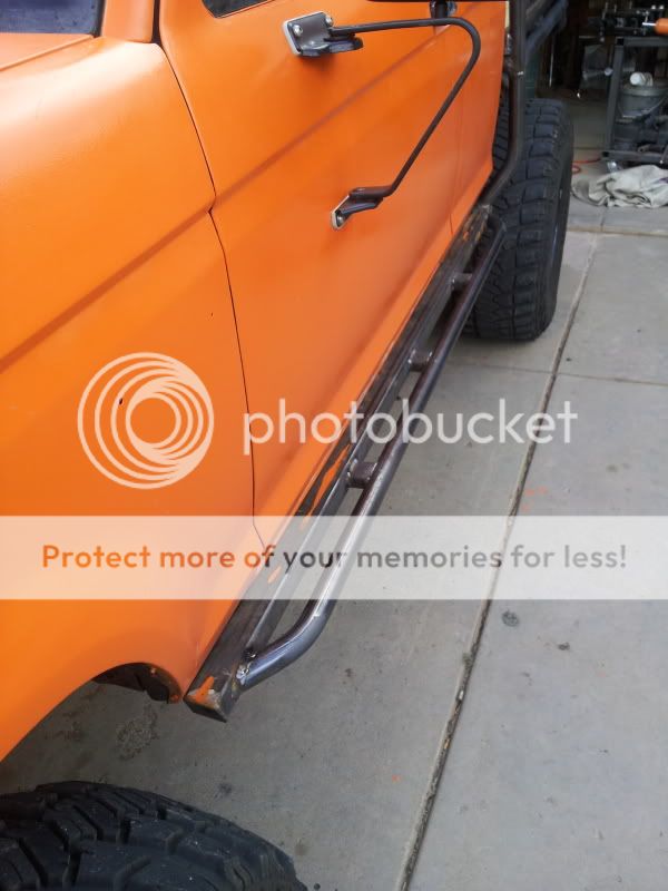

Got the steps on the sliders today...

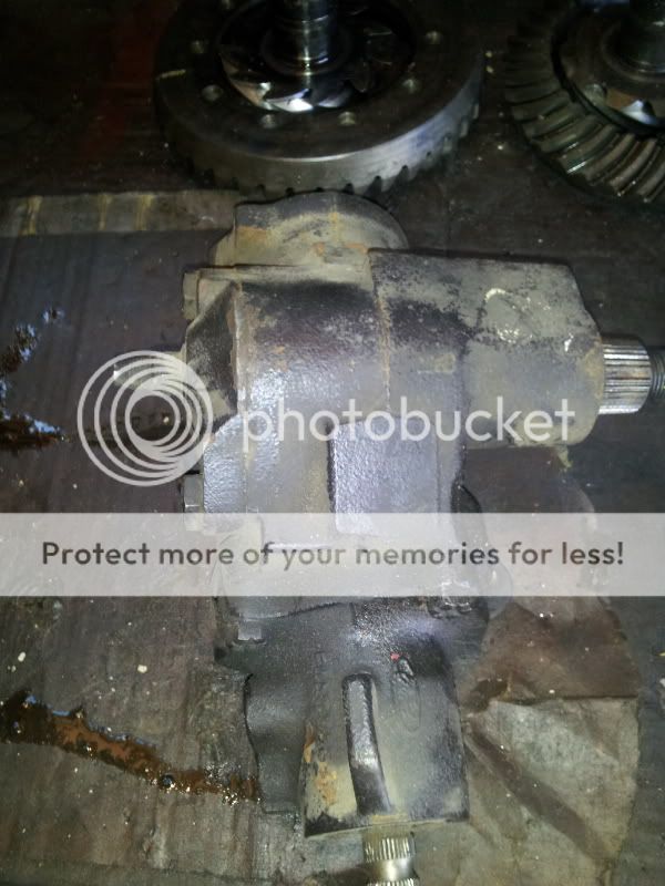

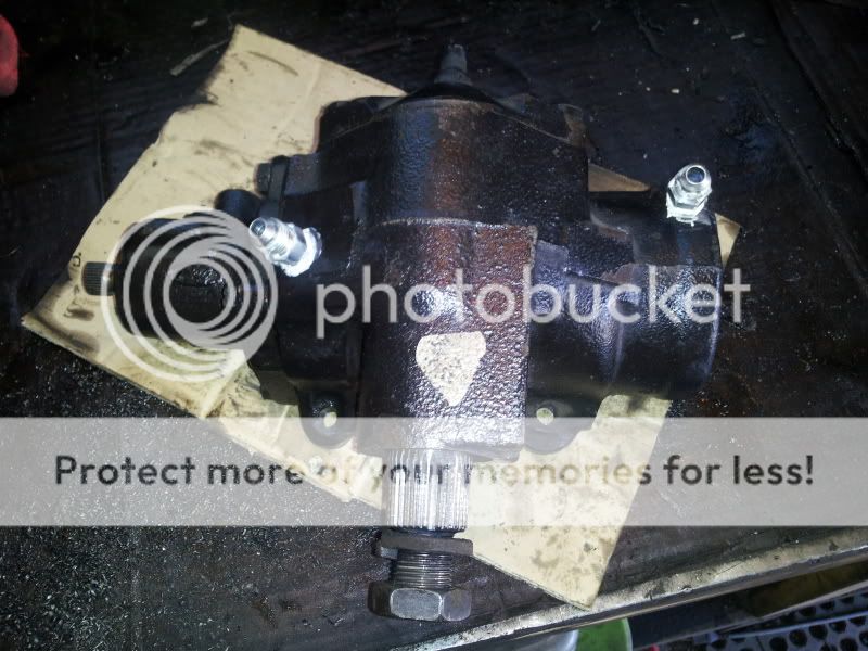

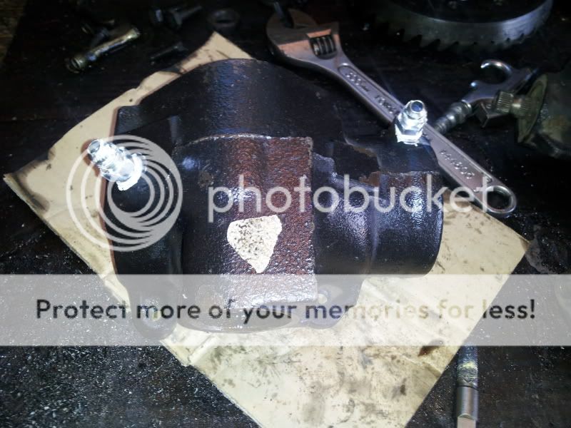

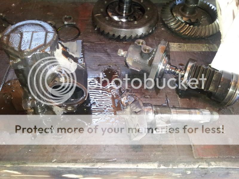

Had a little time this afternoon decided to tap my new F150 box for Double R.

JIC #6 / 1/4" NPT fittings installed...

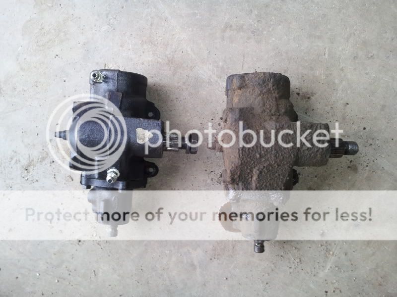

Ready for install when I have time next couple days. :D

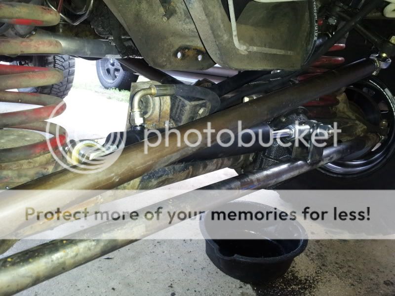

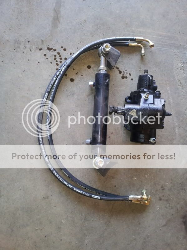

Hydro in!
Old box was looking pretty rough and leaked pretty bad.

Works like a champ!!! Still using the stock pump and no whine!

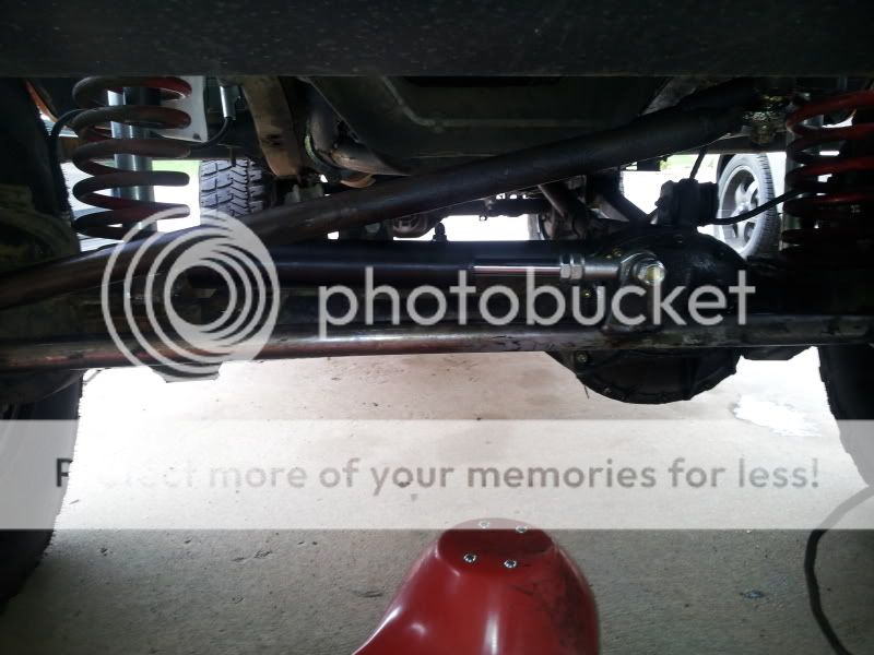

couldnt tell, but where did you connect on the axle? looks like the stock location for the steering damper but the drag link is in the way. the f150 box looks to be the same as the stock ranger pump. everything looks good, like those sliders
Yeah pretty much the same place as the shimmy shock goes. There is more room there since I moved the coil perch back. Drove the truck 40 miles this morning everything works great. I might see if I can turn the pressure up on the stock pump rather then buy the upgraded pump. I will post up if it works.
Yeah the F150 box is the same even feels like the same ratio inside the box. All Ford boxes are pretty much the same just some came with different ratios inside.
