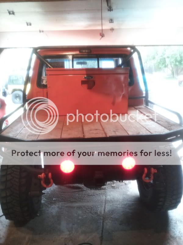

Plans for today D tabs, mounting the toolbox, and few other things(maybe more cage work). I will post pics tonight.
What I got done today...
Mounted the tool box and got the rear D tabs on...

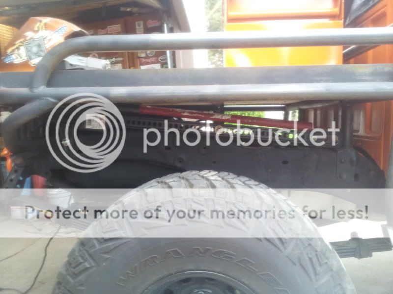

Mounted the Hi-Lift...

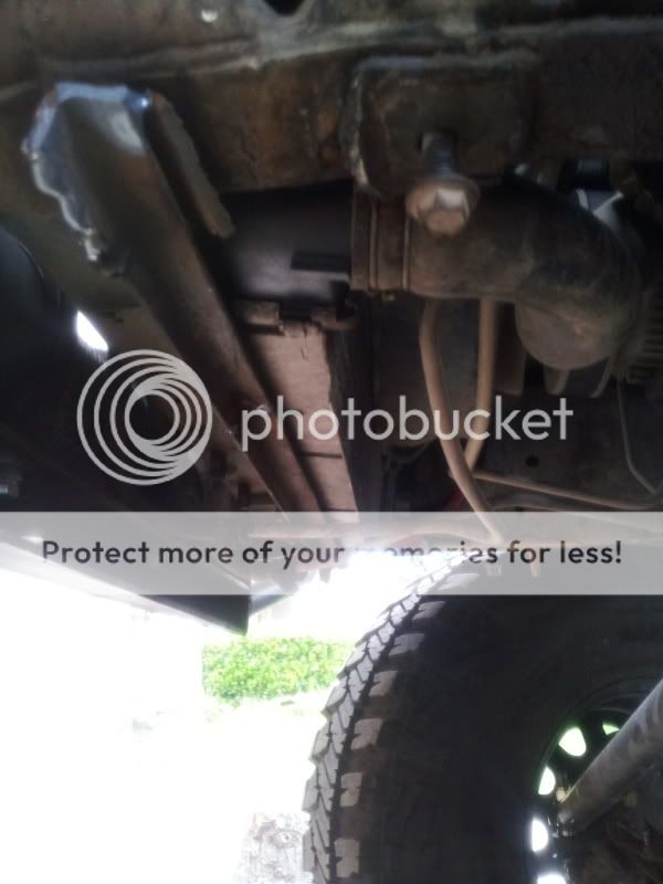

Supported the bottom of the new radiator...

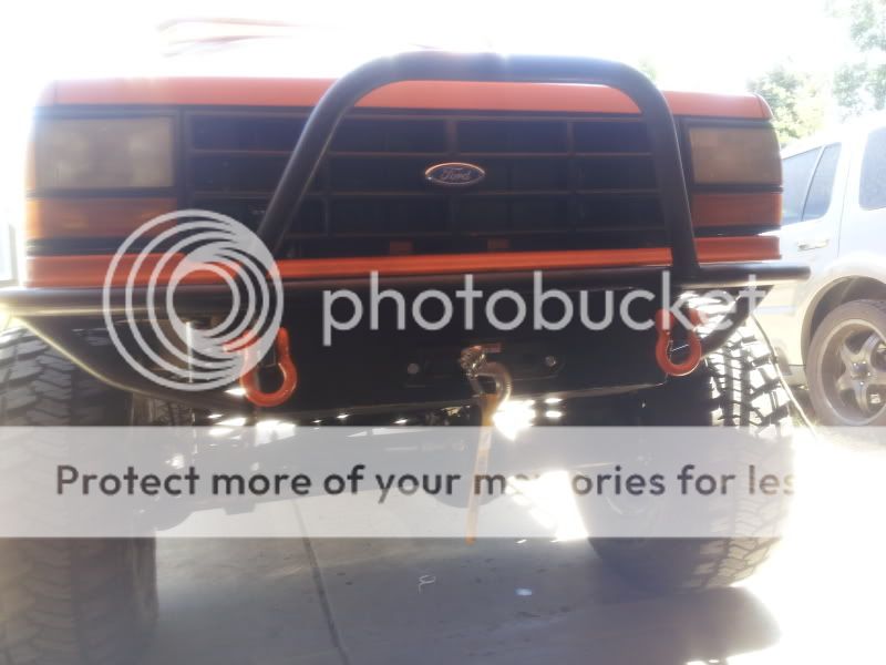

And the front D tabs...
