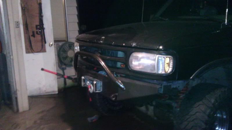

great job so far. that winch looks good in there. can't wait to see some stuck pics with the winch in use..

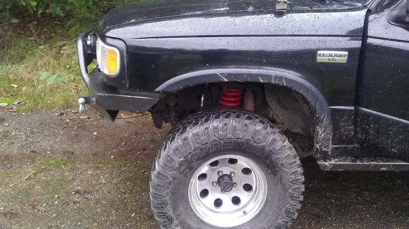

bumper is one step closer to being done, all that is left is to cap the ends, then strip the paint off and bedline it. oh and i need a new fairlead this one is 11"long i want one thats 10"
on to the pictures. in some spots it doent look square and level in the pictures but believe me everything is square and equal. just crappy cell pictures.

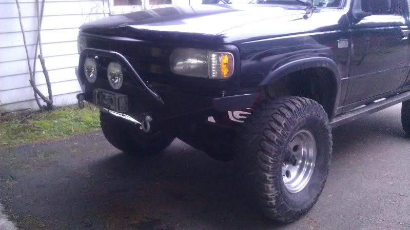

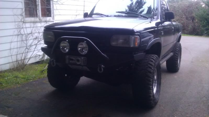

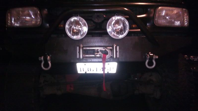

finally got it almost done, ends are capped! :fing26:

Looks real good man nice work, Them cut wheels are very dangerous cheap ones anyway
i like your truck man......that bumper is sweet too, i'm not gonna copy yours, but it's gonna look like i did

i'm liking that bumper.. that hoop really set it off. nice work.

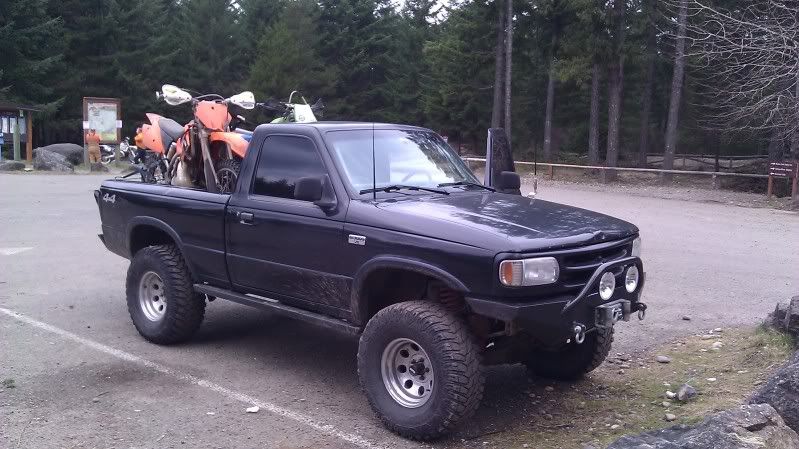

here are some better shots of the bumper.

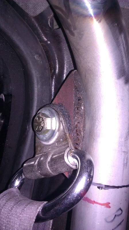

up next is a 6point DOM cage
the cage isnt 100% done yet but its getting there. dash will be built in the next month or so.

the bikes fit around the cage!
