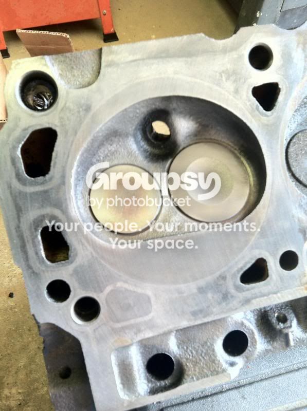

Hey guys. I made some serious progress the past couple of days. First off it was impossible to even move in my garage. That's now been taken care of after a couple trips to the landfill and scrap yard.
I picked up my heads today for $90. Turns out they are E7's with the valves still in them and springs/rocker arms. Still need to pick up the pushrods but that'll come soon enough.
I got as much clean today as I could and should get them to the machinist soon.
When I got them home.
Project: Baja or Bust Build Thread
Before I touched them.
Nicely caked.
After a little love.
Intake Before
After
All of them before.
After
The heads look great!
How did you clean them?
Just alot of patience and a drill with brass wheels. You can see it on the floor in the second to last picture. If you use the same method be sure to use brass wheels not steel as brass wont harm any of the metal.
