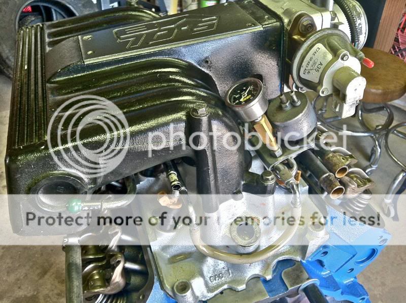

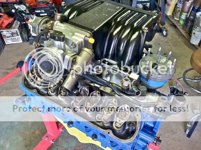

While I'm sorting out the roller rockers to buy (pretty set on the 1.7 kit) I picked up a craigslist bargain today.

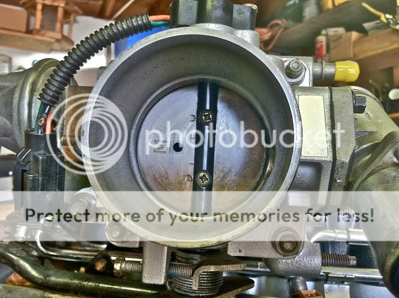

GT40P upper/lower, Kurban reg, fuel rails, 19lbs injectors, 65mm Explorer TB from a 12.69sec mustang. Barely been used. Also has been what looks like at least a polish on the inside. Jeg's fuel pressure gauge, thermostat, water lines. All for $180!

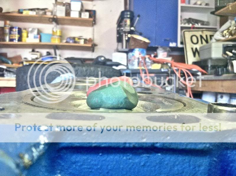

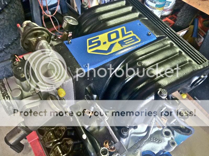

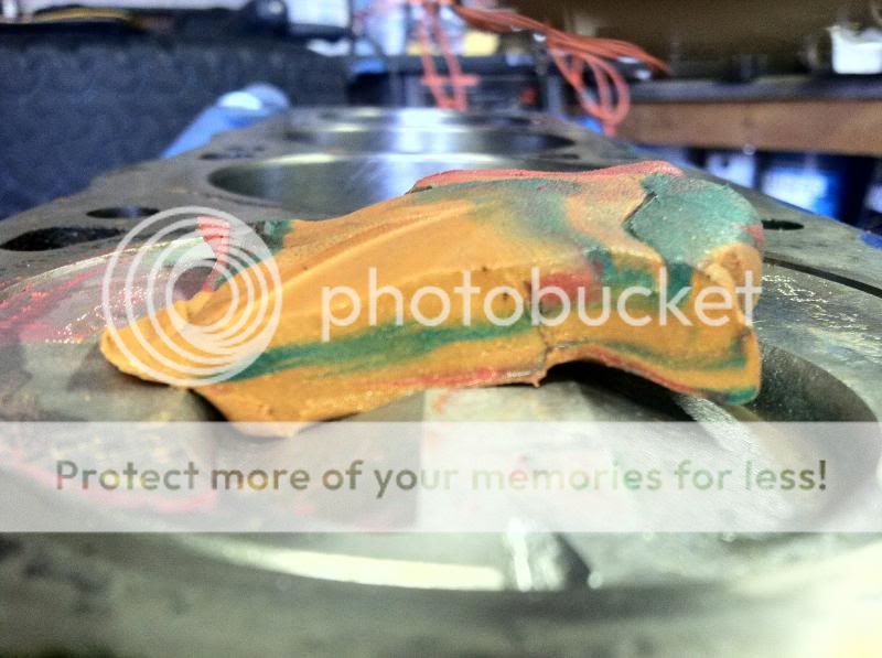

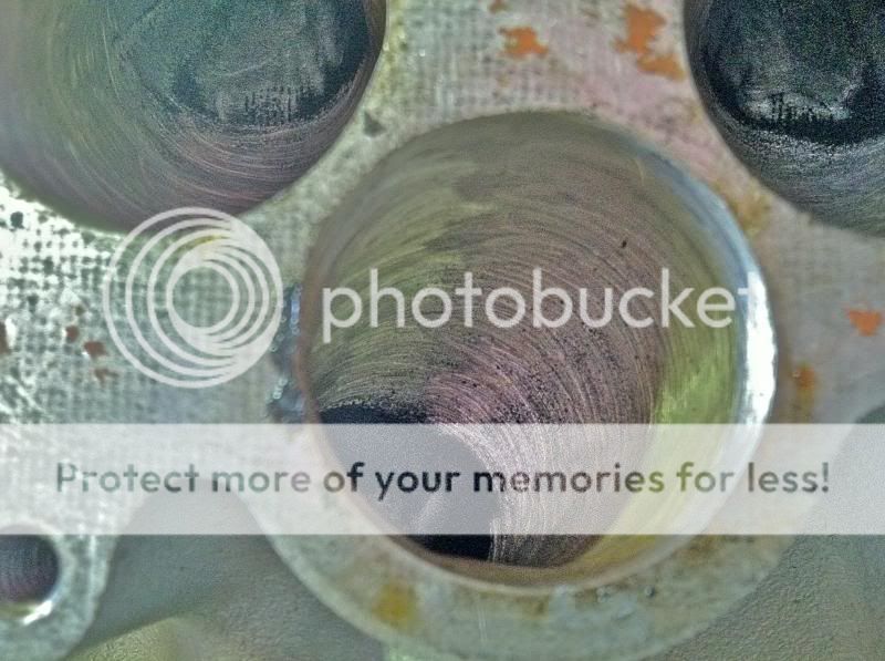

I had some time today to try the modeling clay inside the combustion chamber. I didn't have my micrometer on hand but really didn't need it. The gap is HUGE. Looks like I'll be ordering the 1.7 Rollers soon. Also had some time to put the Intake plate on that I painted to match.
The Valve Indents in the clay at TDC

Thanks for the advice man. I did it!

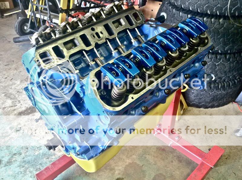

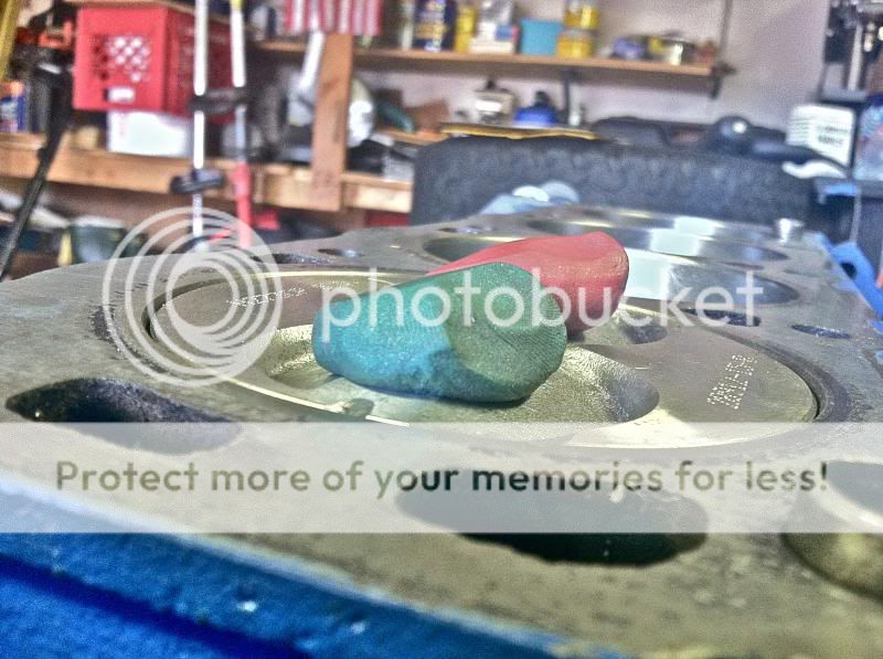

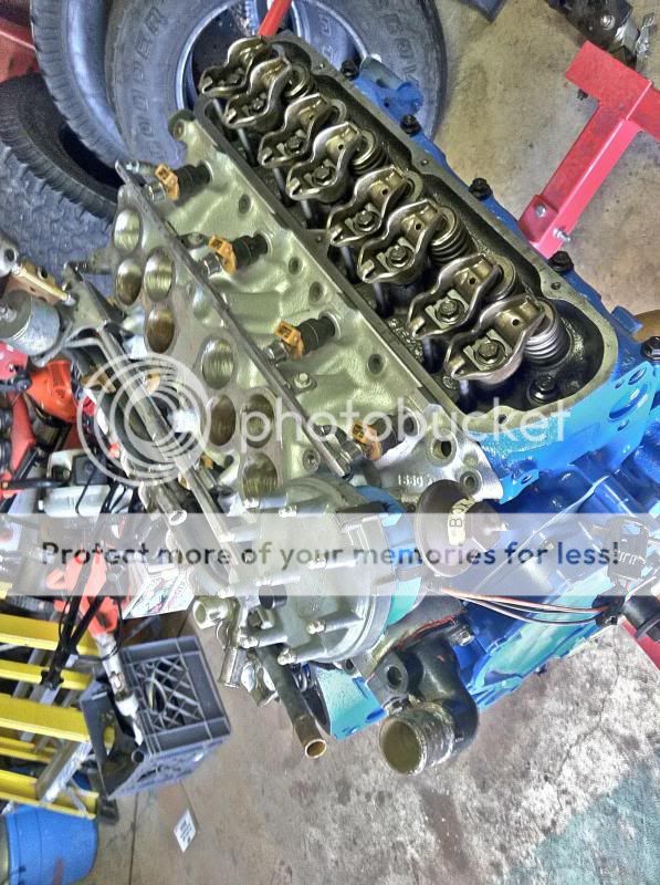

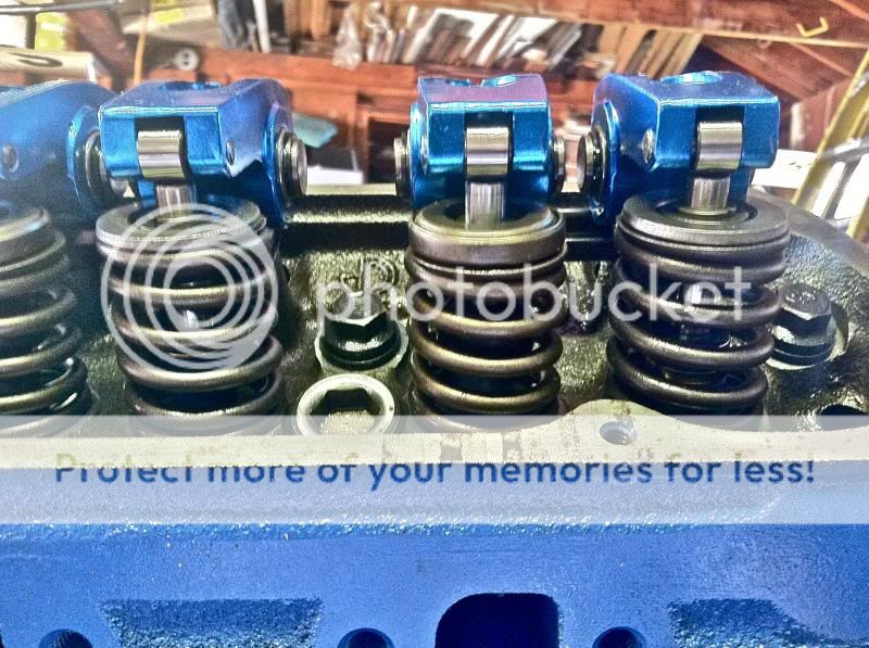

I picked up some craigslist-find 1.7 pedestal roller rockers yesterday and slapped em on today. The guy threw in sets of free channels and pushrods. Can't hurt to have extra. I ran another clay test to check piston-valve clearance and it's as close as I can get and feel safe from any valve float issues. They look awesome on there even though they'll be hidden soon.

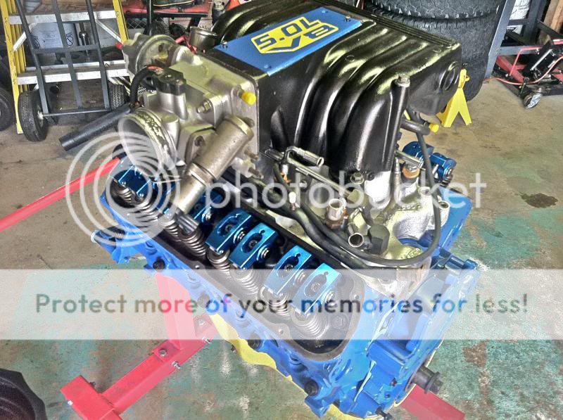

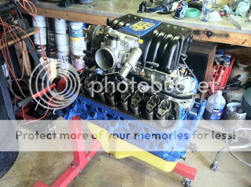

Here's some updated shots.
Out with the 1.6's, in with the 1.7's.

Like i said, close!

With the GT40P on.

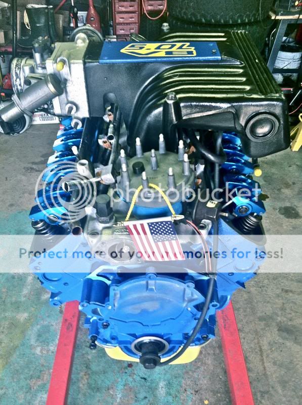

And the obligatory America pic. I have tons of these little flags.

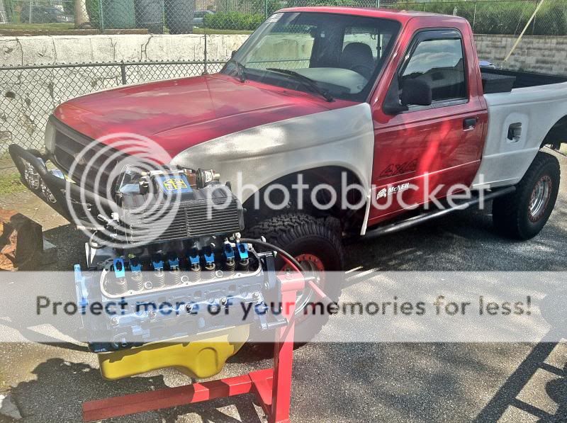

Hey guys. Work on this thing will be picking up again soon. I've been busy trying to procure my second car for when we strip the ranger down. Had my eye out all summer for an early 90's Miata in nice shape. I may have just found the one about 20 miles away from me. Meeting with the guy this week to give it a test drive. 1990 Miata 180k miles, good top, new brakes/tires, only one small easy to fix dent.
I also have been working on cleaning up the intake for the 5.0 and finally aimed my headlights on the ranger. I keep you guys posted. Here's a link to the car. http://delaware.craigslist.org/cto/4141294992.html
