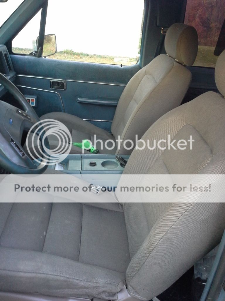

New seats, center console "installed". It's sitting in there, not bolted down, wires for the info center are run under the carpet, but not plugged into the dash yet. I want to fix the fuel gauge before I plug it in anyway.
These are, bar none, the most comfortable seats I have ever had in a car. These might need to go in the Ranger instead.
Project: Amazing Grace
They look like newer seats? Maybe even GM? They look like the seats out of our Saturn Vue. They aren't comfy though so I doubt it, lol.

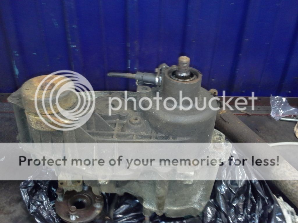

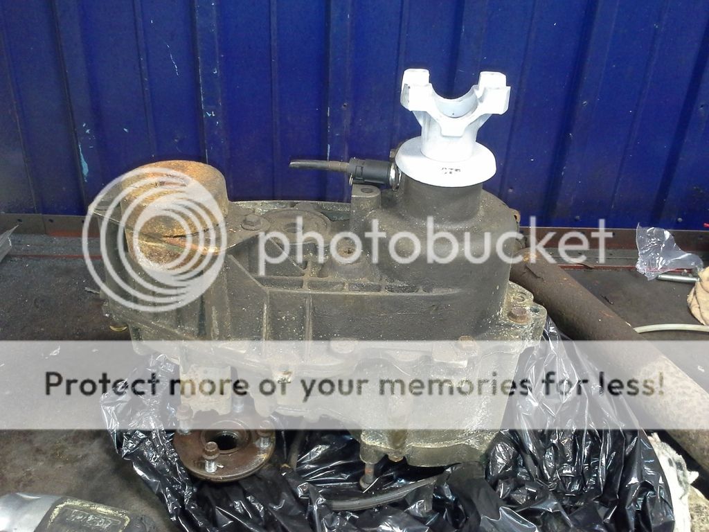

I am also modding the T-case because I want that stupid CV drive shaft GONE.
T-case and a second front yoke from Cobra Trans:
Output flange gone:

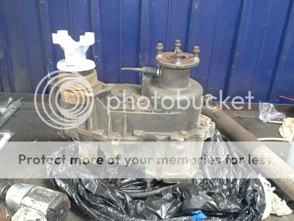

Double cardan yoke on the back:
Then I robbed a companion flange off an Explorer shaft I had laying around and put it on the axle end of a front drive shaft. I think it's the right length (I know it's close). If not I can throw the old yoke on and put the CV shaft back in to drive while I get it fixed.

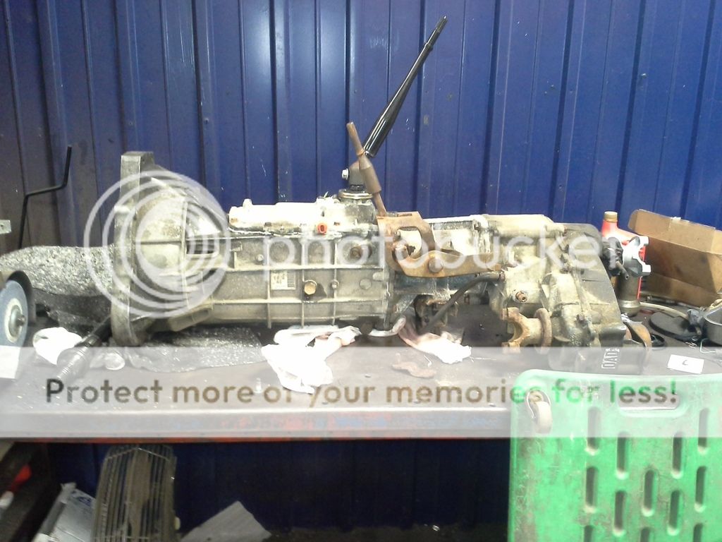

I present Franken-tranny.
2.9L M5OD 4x4 with BW1354 equipped for double-cardan rear output. Should go in Saturday.

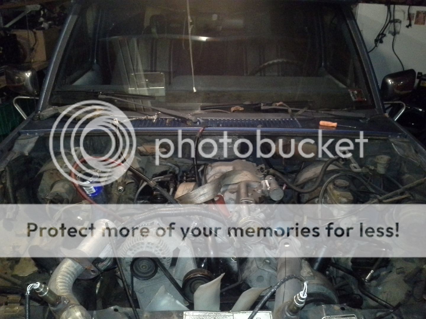

Alright, so 9 weeks after I had hoped to have it running I got it started tonight.
I had the usual issues you run into with an engine job, minor leaks and adjustments to make, the wiring is a butt-ugly MESS.
My original harnesses didn't work the way I wanted, and I have so far been unable to source another set. Well when you don't have what you need you just gotta work with what you have. I cut up the 2.9 harness, wired the stuff I took off into the already patch-worked harness that came out of the donor, and crammed it all into the engine bay. If fit poorly in the red truck with the evap box not there, it fits even worse on my BII with the evap box installed. I had to tuck the PCM in next to the blower because I can't get the plug to reach the hole in the firewall. Since the bundle of crap that's in the wrong spot on the 93 harness i'm using right now was taking the space the evap core is in now I have it all tucked into corners and wrapped around the air box and battery, but she runs.
All that's left is to put the hood on and go drive.

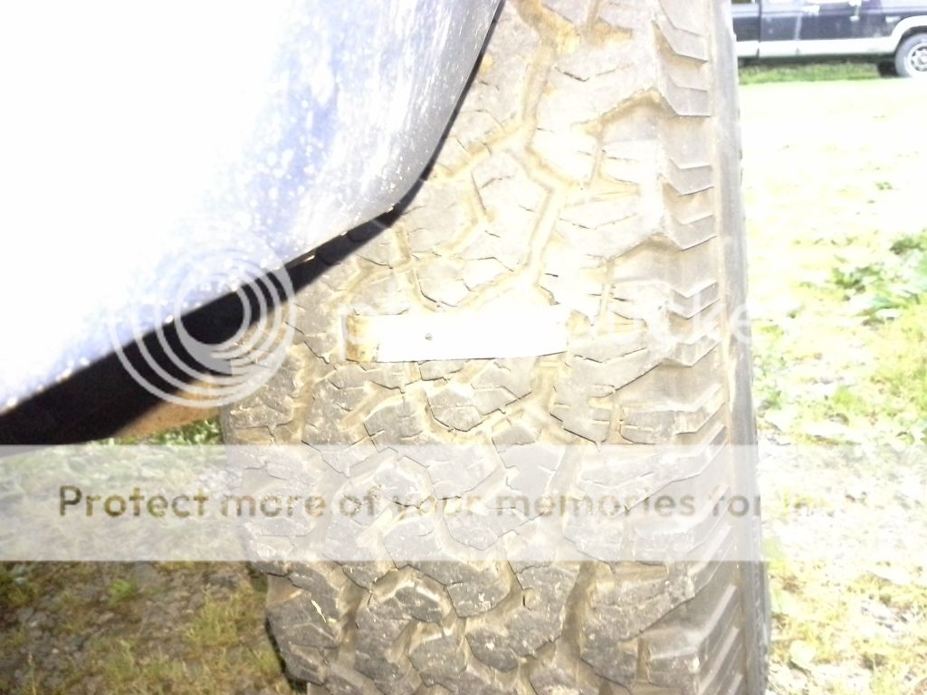

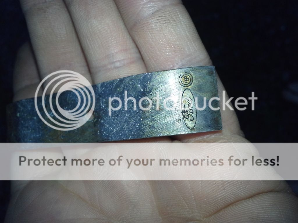

Then after I turned the radio off I noticed a really odd tick tick tick noise, it was def rotational. I was afraid that it might have been something wrong with the one CV joint in the drive shaft since I put enough stress on it to tear the boot before I broke down and took the trans out.
Got home and peeked under just to look for new drips and saw this:
One of the old main bearings from my 4.0 rebuild was flattened out and wedged in the tire treads. I haven't driven it again since I took the bearing out, but I'll bet that was my ticking noise.
