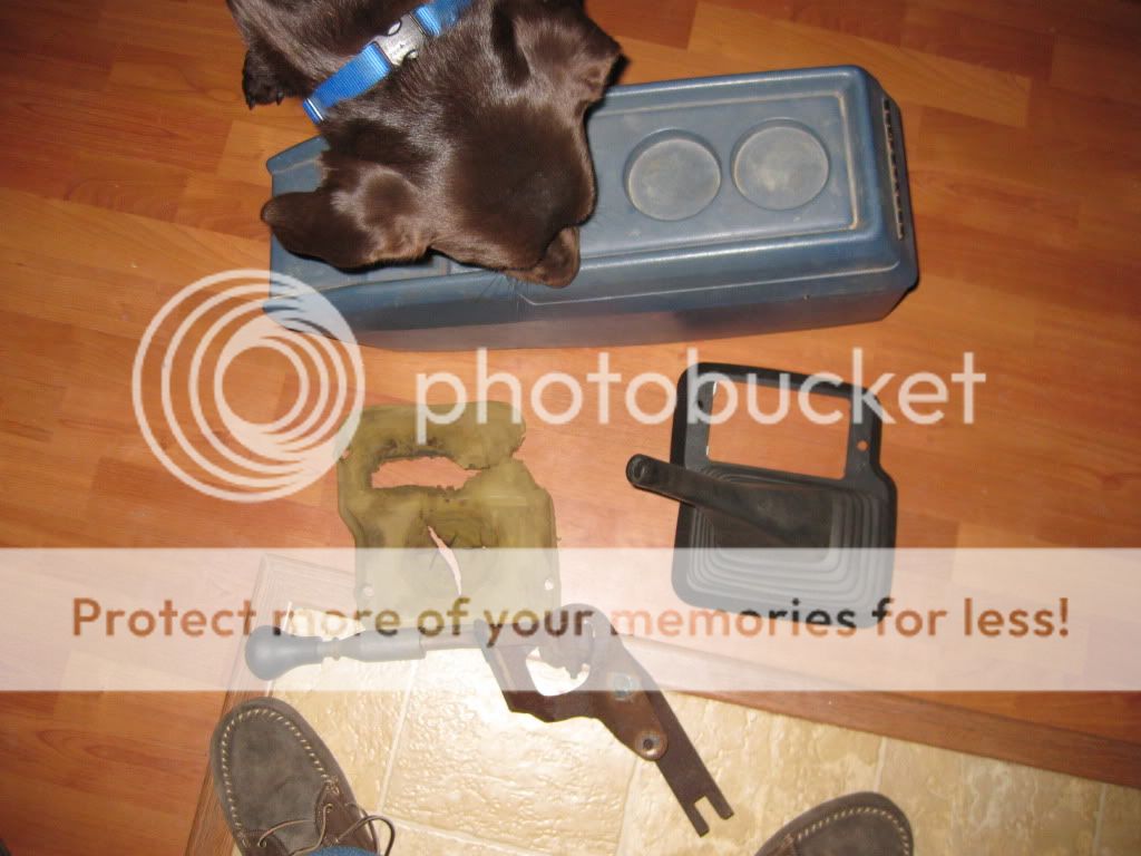

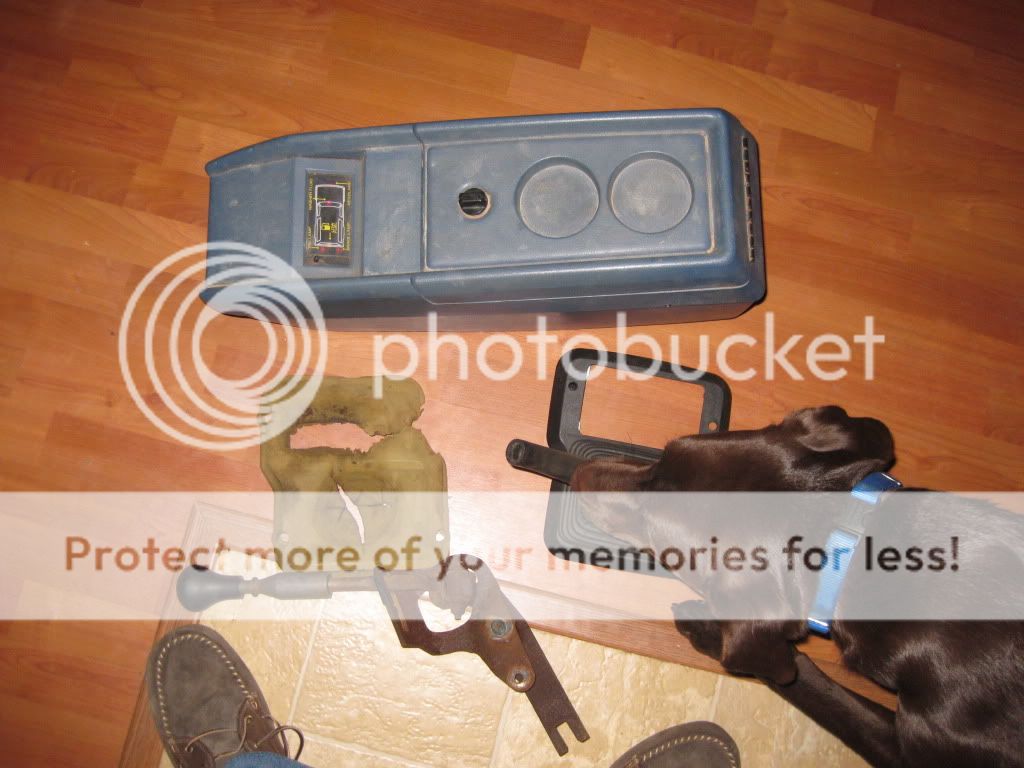

I bought the 4x4 shifter being told that the big bolt for the side of the trans was missing. Got it out and looked a bit closer...
Project: Amazing Grace
Nope, she is very much there. The electric transfer case will not being going back in. The roof console will be staying since I like the map lights and the buttons will be adapted to work seat heaters.
I think I'm gonna put heaters all around in the B2. This will be a luxury vehicle before I'm done.

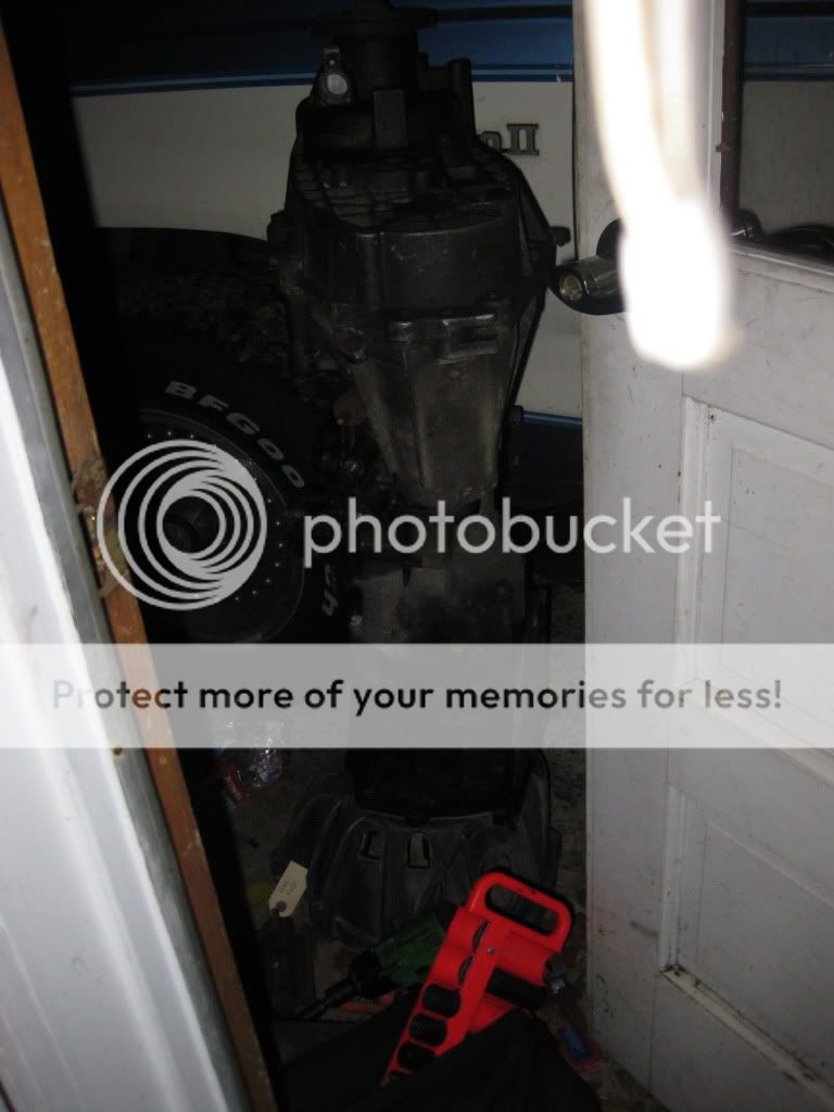

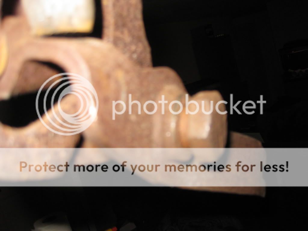

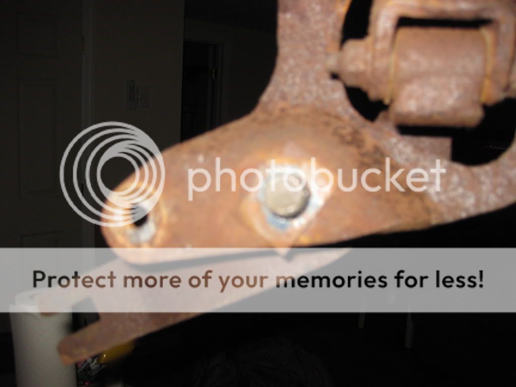

Last time on this build:
The clutch slave gave out, a Y-pipe bolt snapped off in the manifold, the exahust broke into 3 pieces when I sneezed at it, and it was friggin cold outside.
Now:
I got the bolt drilled. It's not out out, but there is a hole in it big enough to put a different bolt in.
I found out that Ford still makes those little discs that go on manual transfer case shifters and attach the lever to the case.
I replaced both boots on the drive shaft. Still hunting for a proper drive shaft. I will find one soon.
But now the big news.....
After 2 hours of fussing, cussing, and searching, a little creative engineering, and a lot of skeeter bites my B2 has, what I consider, the single most desirable factory option available in 1988.

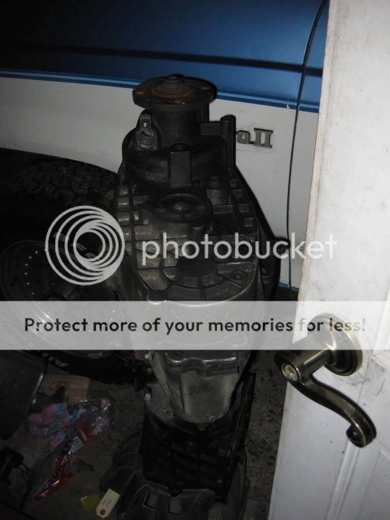

After years of faithful and unfailing service in my Ranger, a few more years of sitting in garages, being traded off to someone else who decided he didn't want it, and then sitting in my garage some more my trust rusty old 1350M is about to go back into service.
That's right, my B2 finally has a manual T-case. Now if only it had a transmission.
