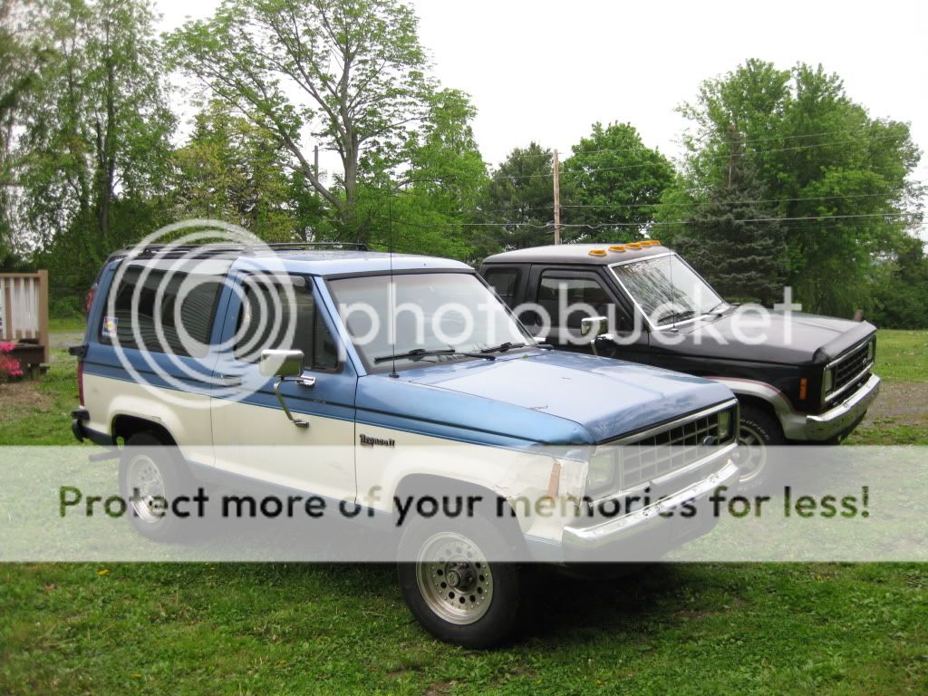

Well, here she is boys:
Project: Amazing Grace
Project Amazing Grace.
This will mostly be body restoration and fixing up. Kinda want to change the color scheme a bit. Maybe black and blue. Maybe go green and tan like the Eddies were. Not sure yet.
Already have an 8.8 for it. It probably won't get a D-35, unless I come across a complete one for cheap.

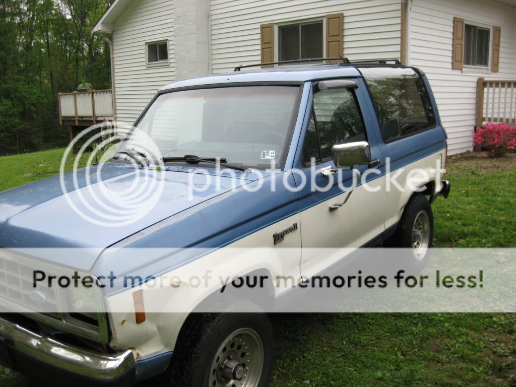

So the roof is now a different color. When I went to work this morning there was a lot of red on it. Now it is mostly primer gray.
