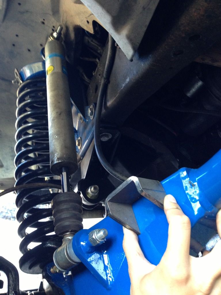

Anybody remember when I was building the 31 spline 8.8 and I used RuffStuff leaf spring perches? And I cut one end of them off? I found a use for that end I cut off.....perfect for bumpstop strike pads!

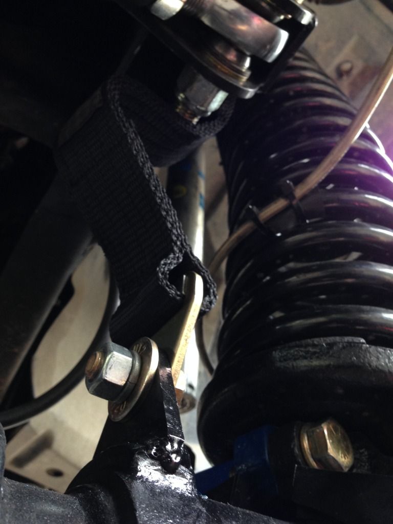

Tractor flex! Measuring for limit strap mounts

But very true and good point. I strapped it pretty conservative and will bump it the same or maybe even more for Rubicon. Will be easy to change later with the pinch bolts on the bumpstop cans. Hopefully that will keep the tires mostly out of the fenders. It may not be that bad now with the straps on, I need to go find a place to test it out. If it is still pretty bad I may just rock no fenders or take my uncles jeep.
