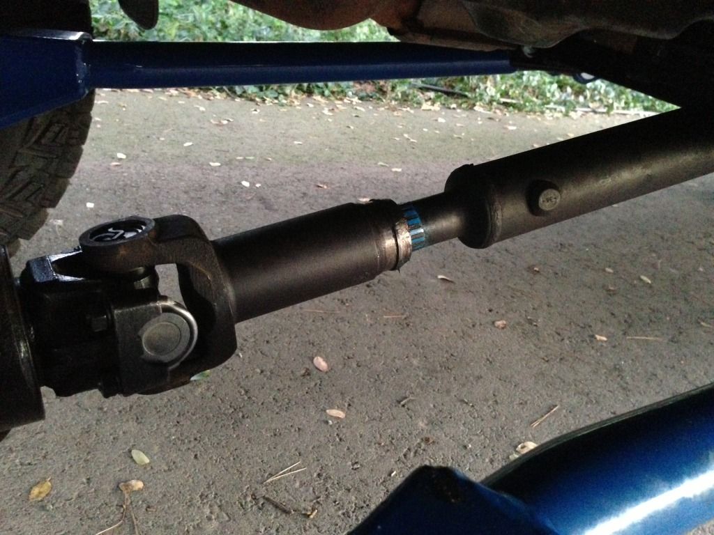

Have you tried installing your stock front shaft? The D44 has a longer pinion snout, and makes up for some of the lift.
I'm running my stock front shaft, my buckets are set @ 1" lift, running 6.5" EB Deaver coils. IIRC you have stock height buckets and 5.5" springs.
It's not my permanent solution, but it works till I can justify spending +$400 on one that will allow me full droop on the left side.

$400? Doubt mine will be over $120 from my local driveline shop. I can't get it in between the snout it's too long the splines are bottomed out

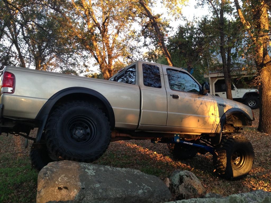

I had baby flex today:

My double-cardan binds only 4" lower than ride height, and I have 1" of spline exposed at ride height.
High angle DC joint, and longer slip yoke, might as well use new thicker tubing and have it built once. $400 shaft right there. Although I'm holding off to see if the small block swap falls through this winter.

Maybe mines too and I just don't know it yet :/ it's a double carden as well.

I lucked out. My front driveshaft doesnt have to be modified! I still have to check it at full droop on drivers side but seems to work perfect. Threw a new u-joint in and some new straps and tested 4wd today (so $23 bucks instead of $400) :
Also cut and welded in some c-channel to the tranny cross member to make room for the double carden. Seems strong enough but Im thinking I will weld some plate on the bottom and or gusset for strength.

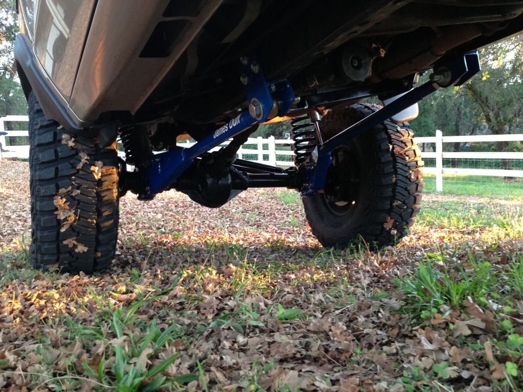

Since 4wd was working I went for a flex test and I am amazed! I also found what I need to address next in terms of getting this pig wheelable:
Need limiting straps, the shocks are about out of extention and the coils come un-seated.
Brake lines are plenty long but I need to run them behind the coil not in front of. With a spring to keep tension on them.
Fenders. Tires want to eat the fenders at anything other than dead straight ahead. Thinking I will either shave and plate the very corner or switch to non flare fenders and trim trim trim, weld, grind smooth and cover with Monsta-Liner. Maybe rock no fenders at all if I get the urge to go wheeling before I can do all of that.
And the Aussie works very well. Noisier than my D35 Lock-right but it actually un-locks and I can steer when Im not on the throttle.
Steering is very livable with the Aussie, and my box/pump actually seem less strained than when they were hooked to the TTB centerlink stuff.
And lastly, bumpstops. Everything clears fine but I need insurance that if Im going fast or come off a ledge abruptly that I dont KO my shocks or let coils do something beyond design. Iv'e seen on Broncos they weld a leaf spring perch that has been cut in half, to the back side of the James Duff arms, then have a polyurethane or hydraulic bumpstop mounted to the frame just above that.
I would like hydraulic stops but probably gonna settle for poly ones once I come up with a way to mount them.
The more I drive it, the more I am satisfied with the ride quality; the "soft" 170/60 valved Bilsteins are a perfect match IMHO to the super flexy BC Bronco front coils. They ride great yet do not allow excessive body roll, in fact it is less than with my TTB setup even though it is taller and more top heavy, it handles better.
Could benefit from a steering stabilizer, but that is a low priority item that will get taken care of in time.
Rear needs longer u-bolts so I can put the stock 2.5" block back in, instead of the 1.5" block. Still will sit about 1/4" to 3/8" low in the back but hey, this is CA and a little bro lean never hurt nobody :) Also low priority (but Ruffstuff is right around the corner, hmmmm)
