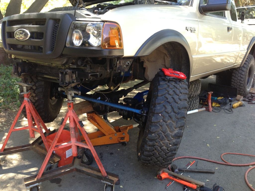

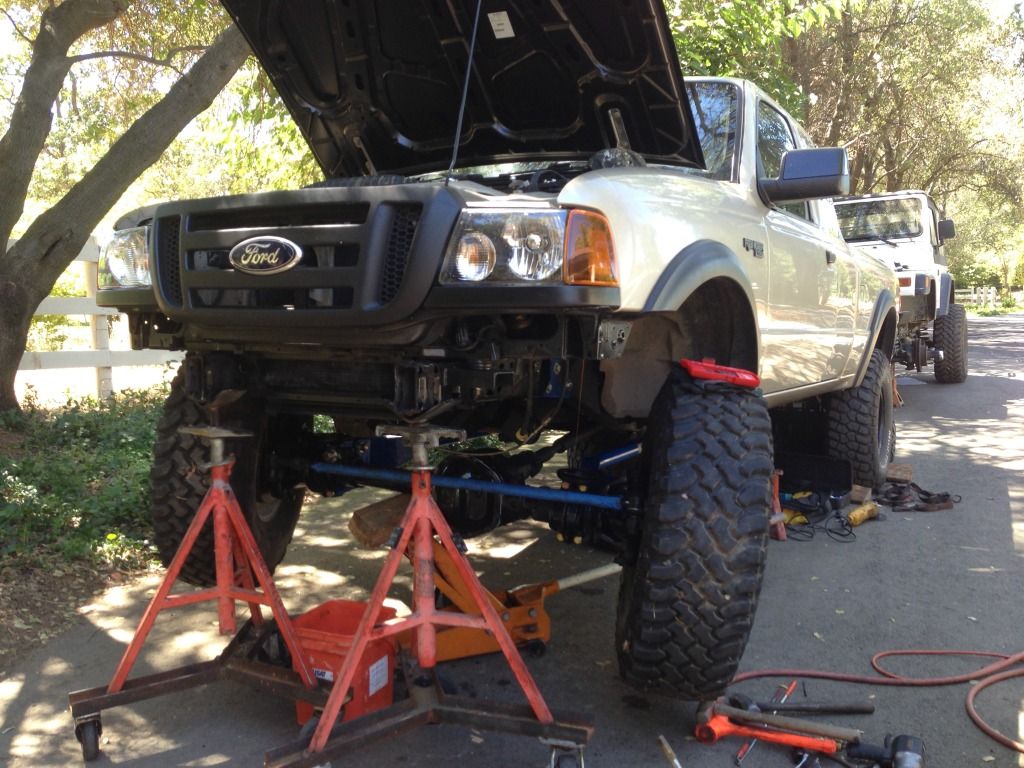

Got the axle underneath today. Coils will be here Monday. Rear rotors should be ready Monday too. Just need to buy some tube for the drag link and track bar and I should be driving it by mid week.

Man I'm so glad I had access to a lift! I bet that was a pain on the ground! Looks like it's moving along though.
Looking good man, where did you end up locating the axle? Stockish or forward/aft? Are you going to use the duff shock mounts?
Forward a bit. Not much like 3/8" or so. If I need to push it more i can via un-screwing the heim joints. Gonna run one shock on the coil bucket/arm mounts. If its not enough dampening ill throw another pair of 170/60 Bilsteins to calm it down with the dual shock bracket that comes with the buckets
