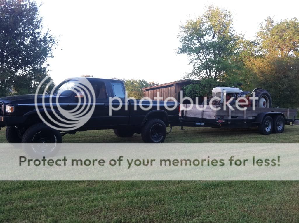

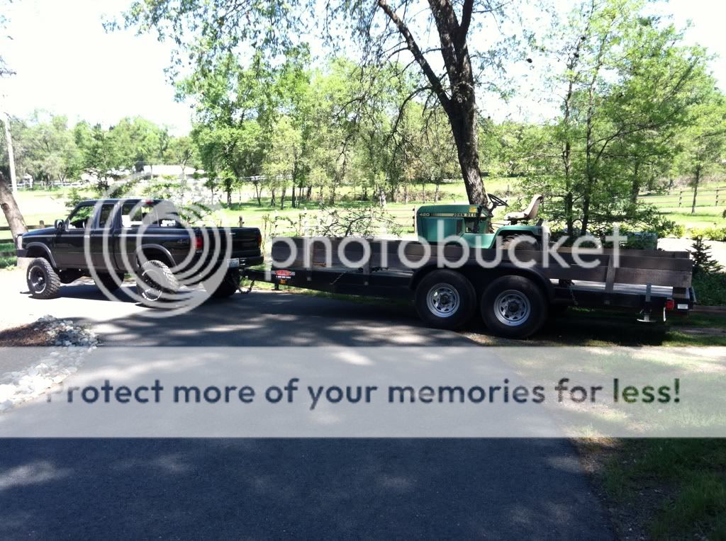

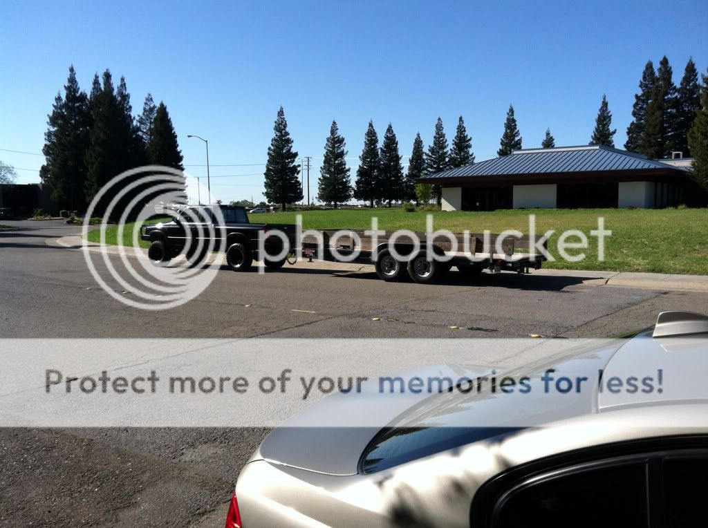

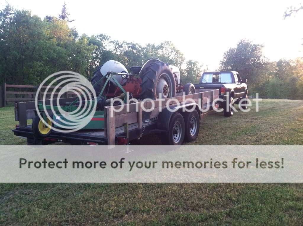

Did some towing this weekend, that's a 10,000# capcity trailer, it weighs 3500# empty. John Deere mower is right at 1000#, and the Ford is just shy of 3000# with the brush hog on it.

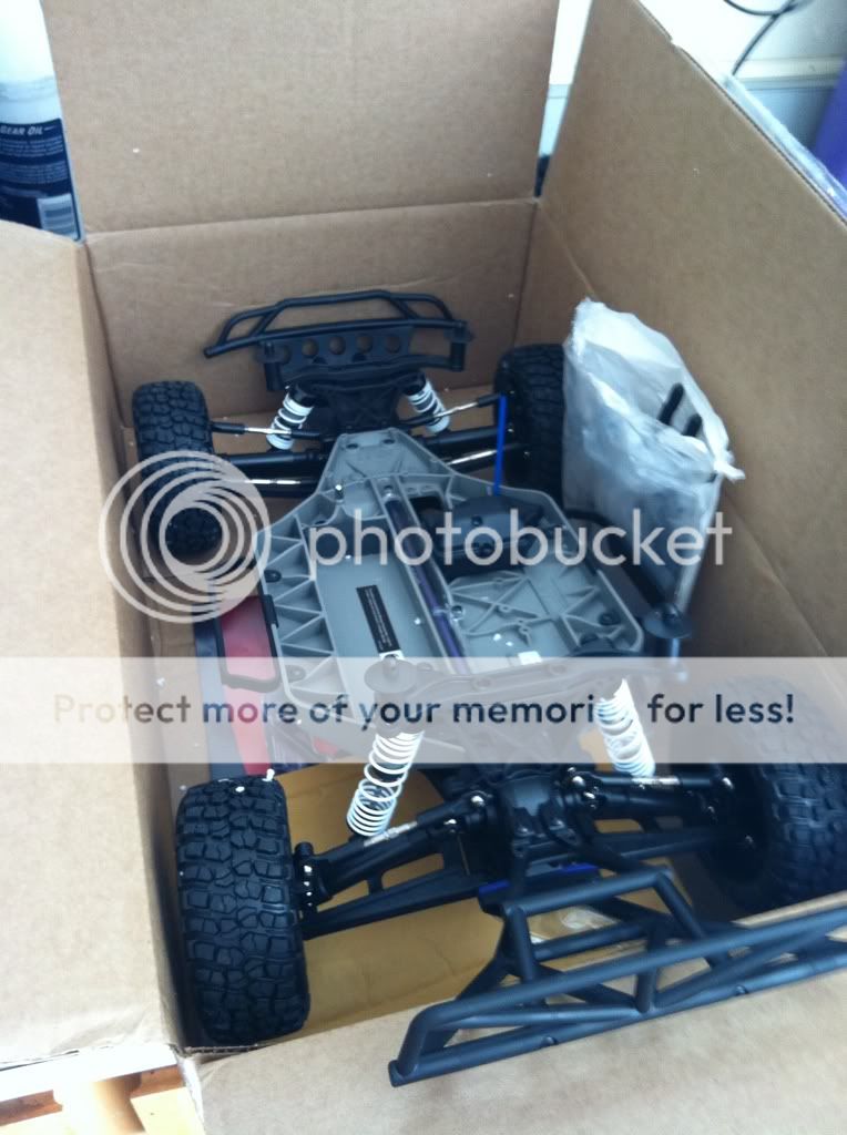

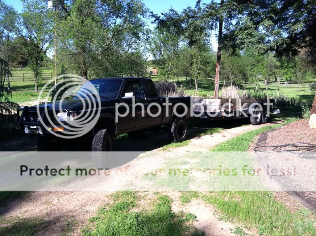

New Slash 4x4:

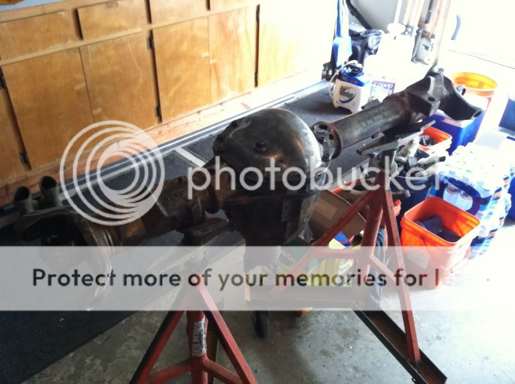

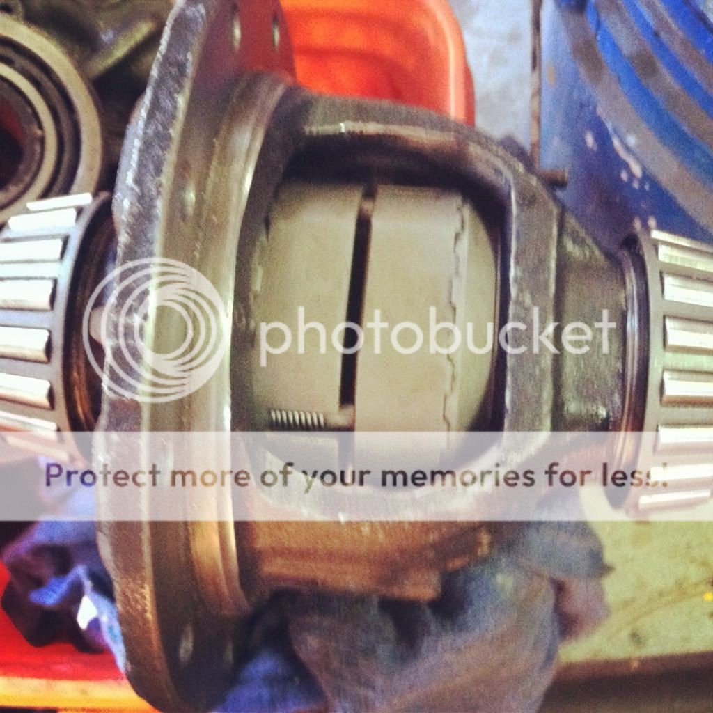

Got the Aussie in, along with a hardened cross pin.
Also scored a barely used Sierra gear & Axle HP 4.88 gear set for $80 from CL.
Taking axle to get gears installed tomorrow:
Axle is back:
I know not much to look at, but they guys sealed the stock diff cover on so I'm not gonna peel it off. I was gonna run a RuffStuff cover, but I'll rock the stocker in the beginning to save some money.
take my advice, while you can keep it rotated like that to save the gear lube...get the cover of your choice and install it now....
I thought I would "save some money" and run the stock cover and hit up against a rock and dented the cover in against the ring gear....needless to say it just about ate through it...
luckily I didn't go much further that day and didn't lose all the fluid or ruin my ring gear....way cheaper for a new cover than a new gear/set-up:icon_thumby::icon_thumby:
l8r, John
You are right, I have the worst luck and knowing my I would put it up against a rock first time out. Before the maiden run I'll put a RuffStuff cover on it...gears/install aren't cheap! :icon_thumby:
not only that....Id run a pattern to see what it looks like...not saying not to trust whoever did the gear install, but you might as well....
