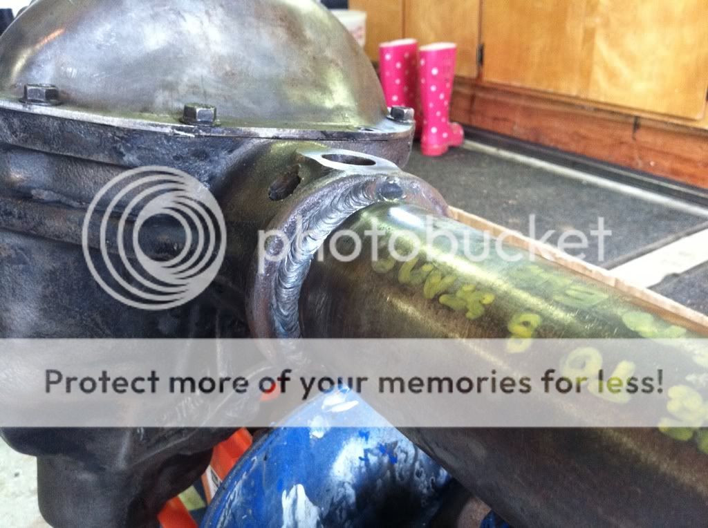

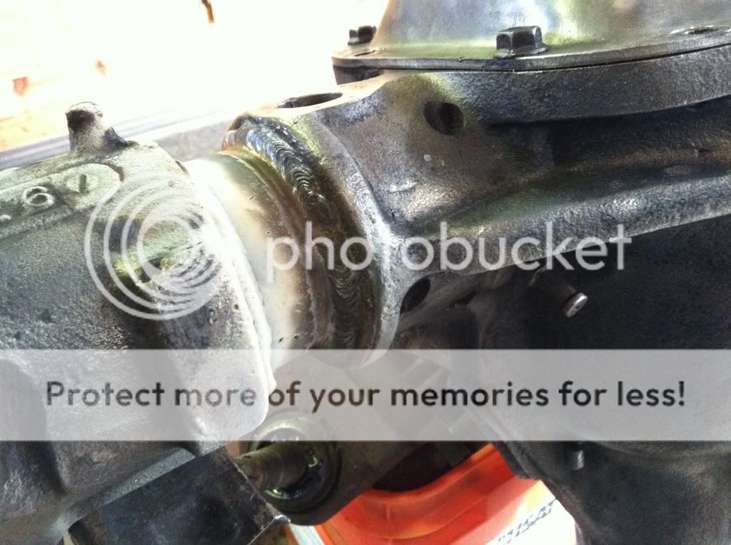

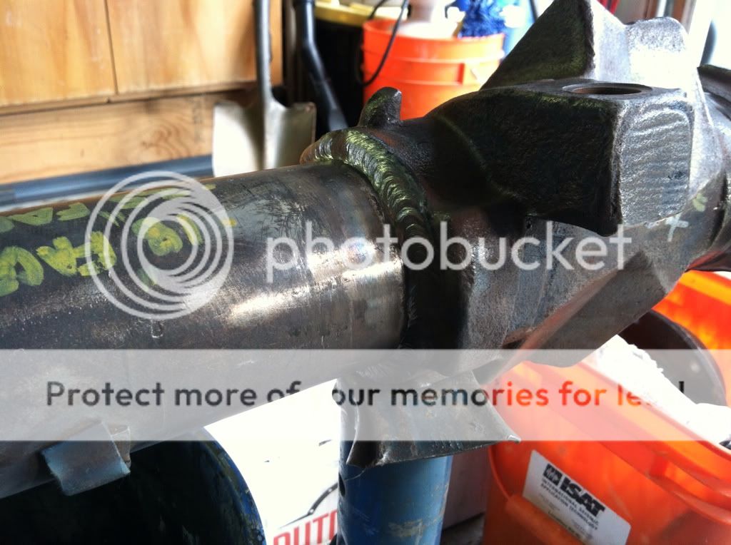

Welded up the axle today without incident:
Left tube:

Right tube:

Right wedge:
Project 4x4 Commuter Mazda
Will hit the housing with a grinder and steam cleaning this week and prep for paint :icon_thumby:
It is hungry for gears and knuckles out parts....prolly start with inner seals, then u-joints, then balljoints.

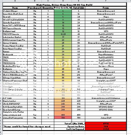

I like your parts chart. We are getting mostly the same parts. It looks like you are planning to get the inserts for the knuckles that you just drill out and press in for over the knuckle steering right?Do you know if those will work on the pitman arm also?
And have you talked to duff about using their trac bar mount? Also I wasn't sure a 15'' wheel would fit over the calipers on a d44, maybe I read something wrong somewhere?
Pitman arm is a no go for those inserts...not enough meat on the arm and the inserts are too tall to fit properly. Pitman arm needs to be reamed to accept larger TRE's.
