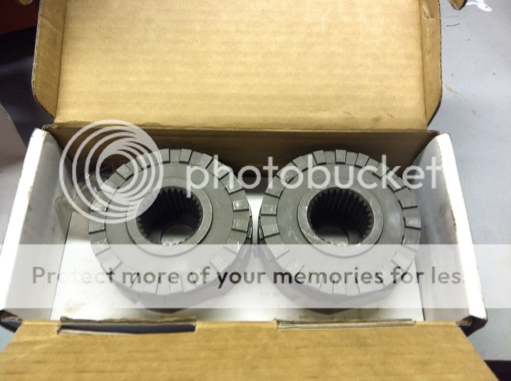

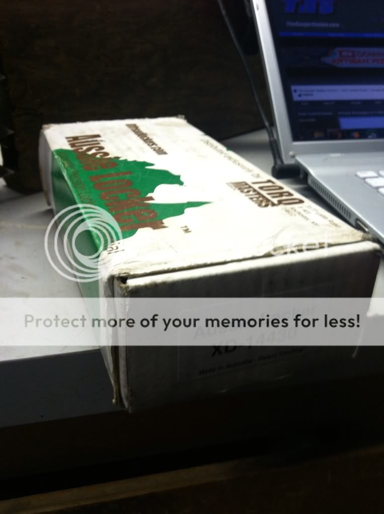

I may be picking up an Aussie Locker tomorrow in the morning off craigslist...
Scored a two year old, but never installed D44 Aussie locker off craigslist for $225 today :headbang: Blew my ball joint money, but hell this was a deal that doesn't com by very often so I had to act.
Got a quote for gears and install. Had a quote done with an ARB locker and just couldn't choke it down. So I found the Aussie instead (just on a whim, by accident really :icon_twisted: ) Pretty stoked about that.
Hopefully after taxes I can pick up some ball joints ($180), u-joints ($60) and maybe in a couple months gear it.
