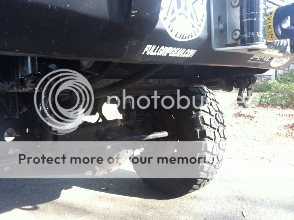

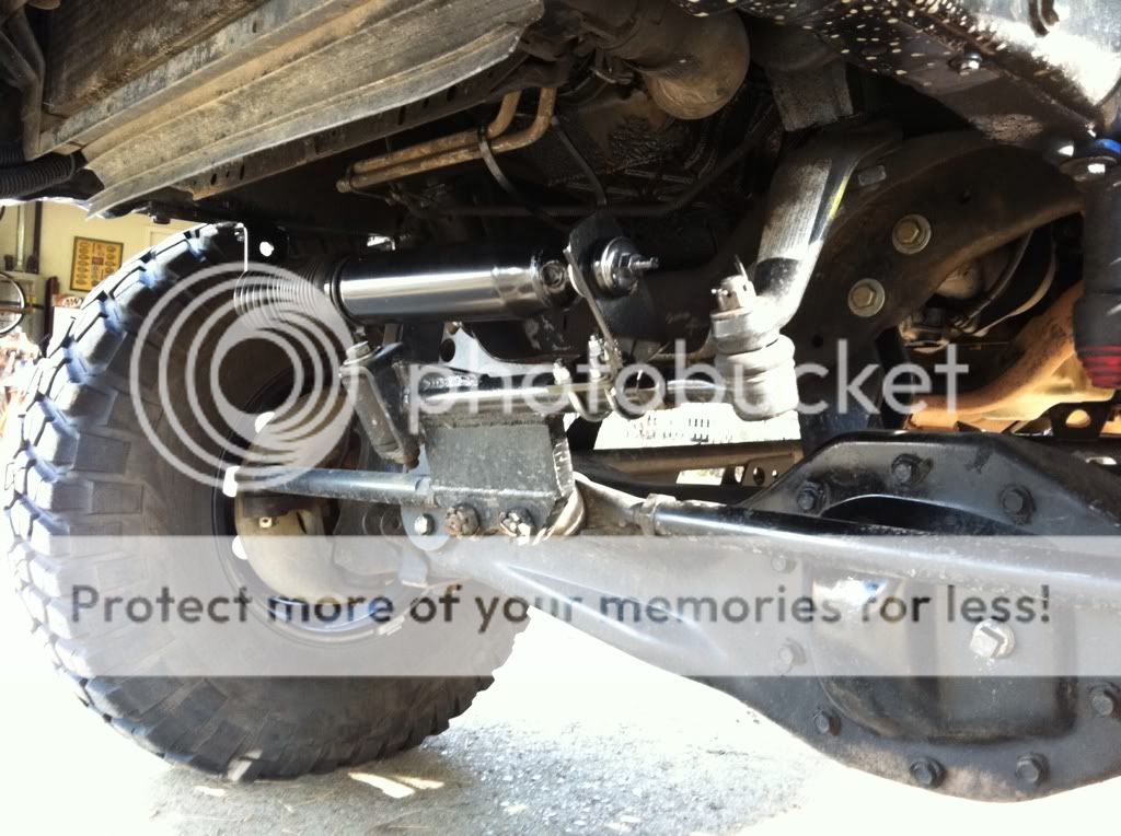

Put on the damper:
gave her two black d-loops and isolators:

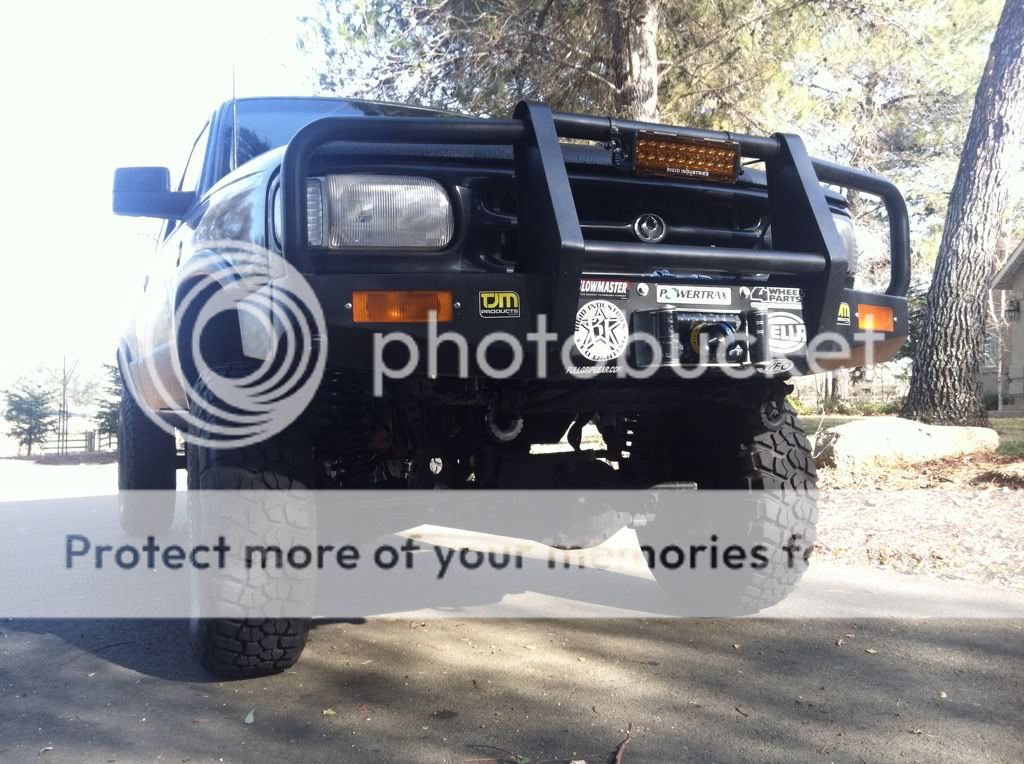

Once I finish out the front end with a hawse and D2's, it will be pretty clean I might add :D
Hawse on the way, D2's in a couple weeks.

My question, why a steering Damper? Did you have issues and need it? Curious bc I'm gonna have a similar front axle setup
I'm a light addict.
Three reasons for the damper.
1) steering box gears are getting loose a there is play in the steering wheel
2) Helps with tracking straight (due to above reason)
3) reduces what little bump steer I have offroad
In essence it is a bandaid for the steering geometry not being absolutely perfect and for a worn out steering gear box.
I intend to replace the box however with my eventual SAS.
You can't tighten up your steering box? Or will it not tighten up any more?
Haven't tried. Might look at it today.

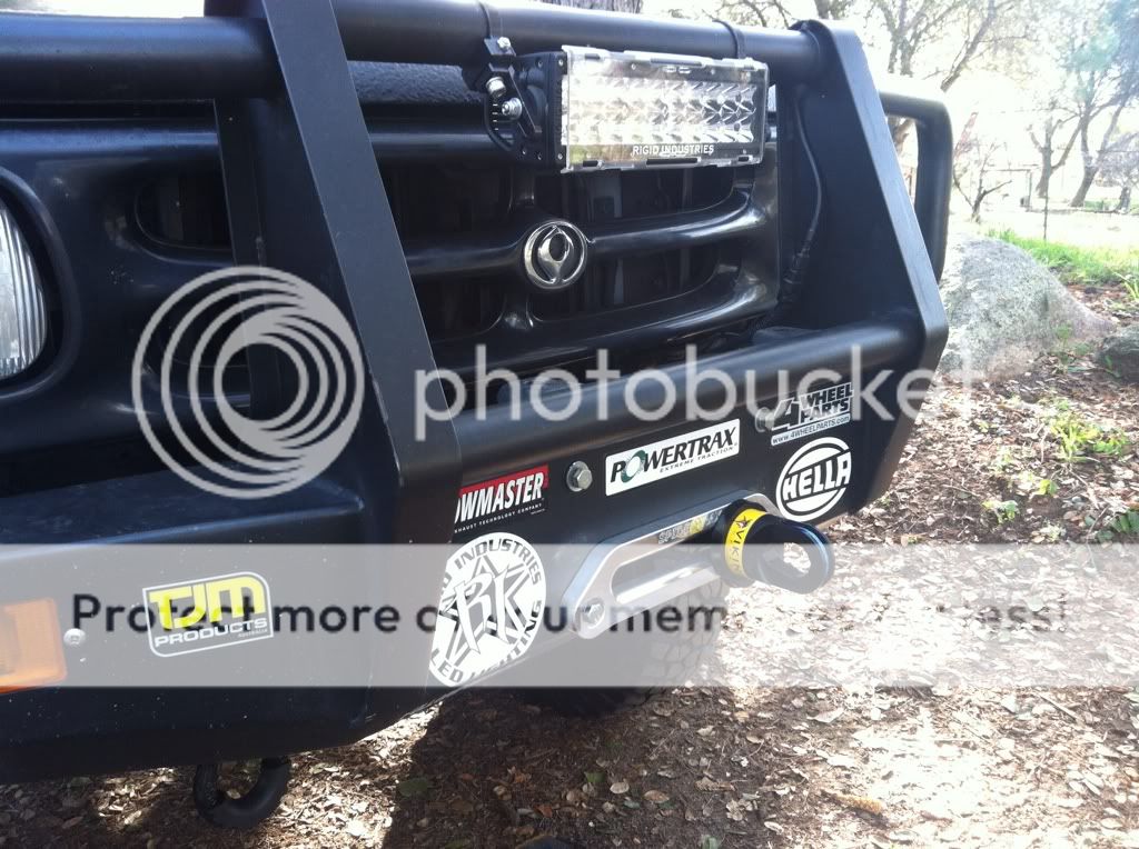

Hawse installed:
Spooled the line on nice and tight:

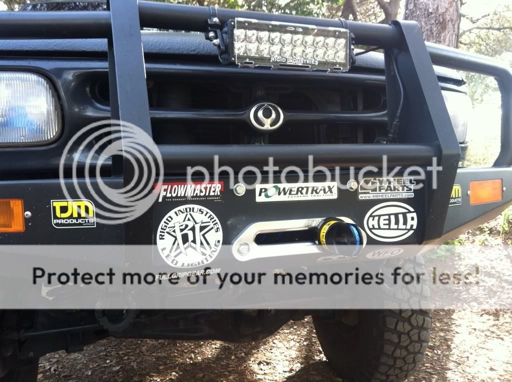

Also, I ordered a pair of D2 LED's, with tube clamp mounts, clear covers, and amber covers.
d2, the duallys? i have a pair of those lights, crazy bright.
Yep. They will more than double the light output of my 10" bar. The bar is 3950 lumens, and apparently the D2's are 2600 lumens each. Wow! I really look forward to getting them installed.
So would you say you are happy with yours?
oh yea. theyre amazing. i have them placed in my fog slots. theyre really bright and incredibly durable. youll love them. where are you gonna mount them?
