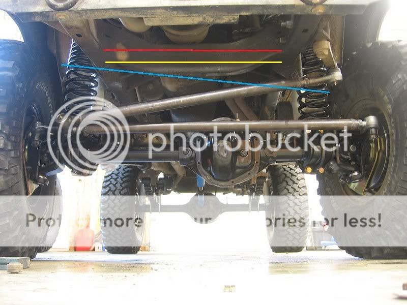

Mid steer (flip the tie rod the top of the knuckles)....no leafs to interfere with so no need for hi-steer right now. t-link steer

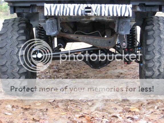

Want to end up like this but with 37's? :
http://www.cardomain.com/ride/787251/1993-ford-ranger-regular-cab/page-10

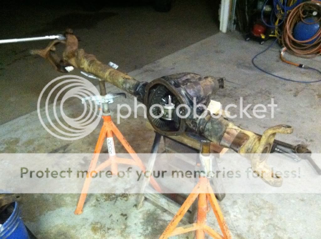

Gettin' clean with the pressure washer...Diamond in the rough...Spindles appear to be in excellent condition. Rotors and hubs seem fine too.

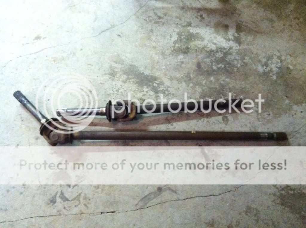

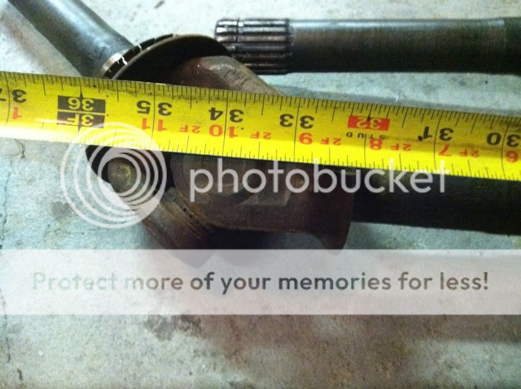

Shafts. Long side measures a hair under 34"....perfect. 34" - 6" = 28" = EB length.

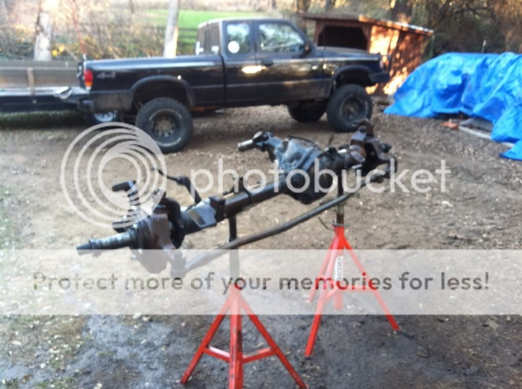

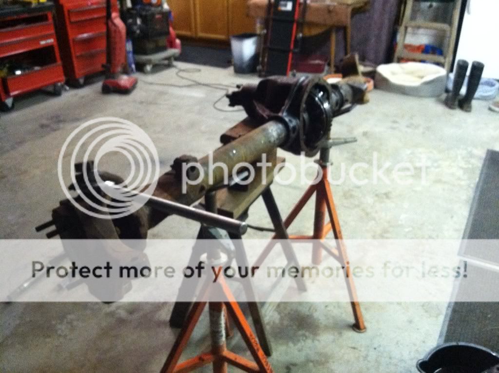

Plan for upcoming weeks while school starts is to make a complete list of dimensions...check the BOM, determine stock gears, wire wheel and clean every thing shiny, order up an EB passenger side 760 shaft and start grinding on the case wedge weld. I predict I will have it narrowed and the housing painted up perdy by end of Feburary depending on how busy school is. From there....its all downhill as I aquire u-joints, inner/outer bearings, stage 8 lock nuts, Warn hubs, JD arms, coils, gears, locker and then have a seriously fun hay day bolting all this shtuff together :D I'll have it geared and locked over the summer. Tires and wheels between summer and Winter. Sitting on stands waiting to be swapped by this time next year. Hopefully all goes according to plan.
