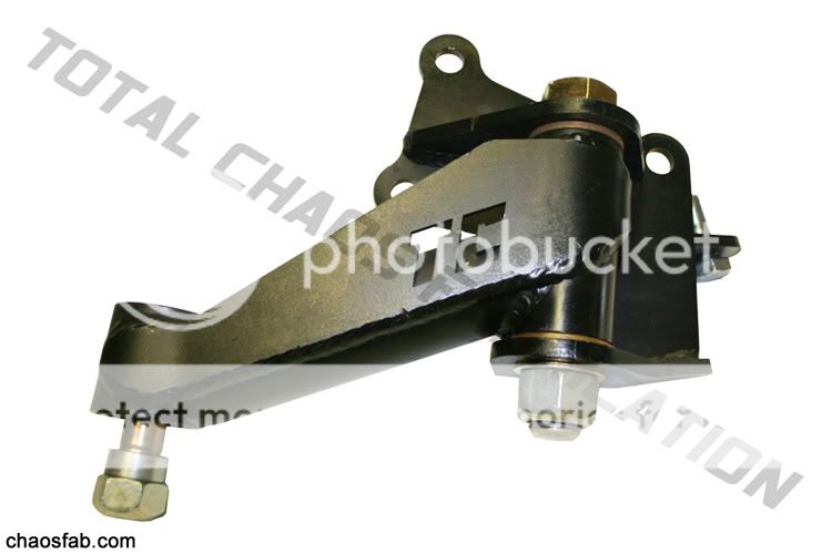

What do you suggest for an idler arm? Do you have a part number or model of application? A quick google search of GM dead lever yields nothing.
All the stuff that came up didn't seem to drop down enough, they were all basically a "straight" pitman arm when I searched GM/Chevy idler arm.
Check out this bad mo fo for Toyotas, it even runs at and all time low price of $370! Its made by Total Chaos

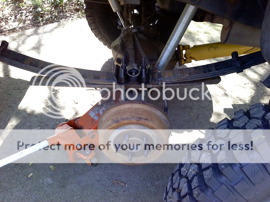

Changed out my curved Skyjacker overload leafs for my flat stockers.....test drive confirmed my assumption, rear axle rides a little better now that any up travel is not affect by the overloads.

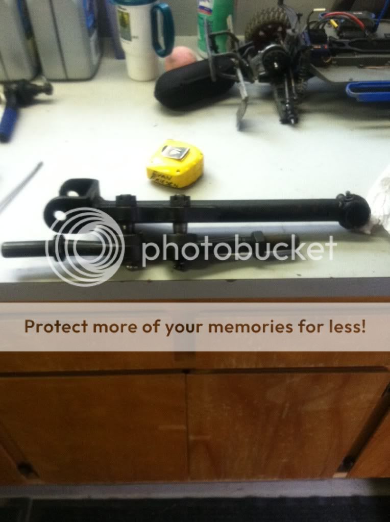

Got some superrunner parts today, that will serve for the basis of my 1-ton version.
Gonna try and track down a tap to tap the center-link so that the TRE is replaceable.
Project 4x4 Commuter Mazda
Left to buy: chevy 1-ton TRE (RH or LH), RBV TRE, metric tap, tubing (to be machined and tapped 7/8-18.
Gotta ream for the chevy taper, mod the center link down 2-2.5, beef the idler, and have WFO make some tie rods.

Over the weekend I went wheeling, and the stock overload keepers bent, allowing the overloads to get crooked. So I removed the overloads all together for now, just to see if it would ride better without them.
It does, but now my truck has massive "bro-lean" which is cali slang for prerunner stance and I don't like it.
This week or weekend I hope to have enough time to put the overloads back in the leaf pack (upside down this time, to squeeze any remaing flex that I can out of the rear axle) and thread some nuts down onto the u-bolts like the Tech-Library suggests doing. That way they can't get all cock-eyed after flexing out real hard.

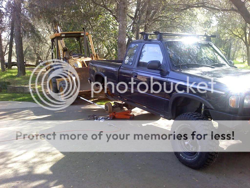

Wheeling trip really surprised me. Muddy slick rocks was the terrain, as well as 18" of thick nasty gooey mud. Only had to bust out the winch once after bulldozing about 24" of mud under the D35. Other than that the wheeling was very fun, and new tires more than proved their wieght in gold (well so did the winch :icon_twisted:).
No unfortunately not, it was night and I was primarily out there to help winch a buddy out of a hole.

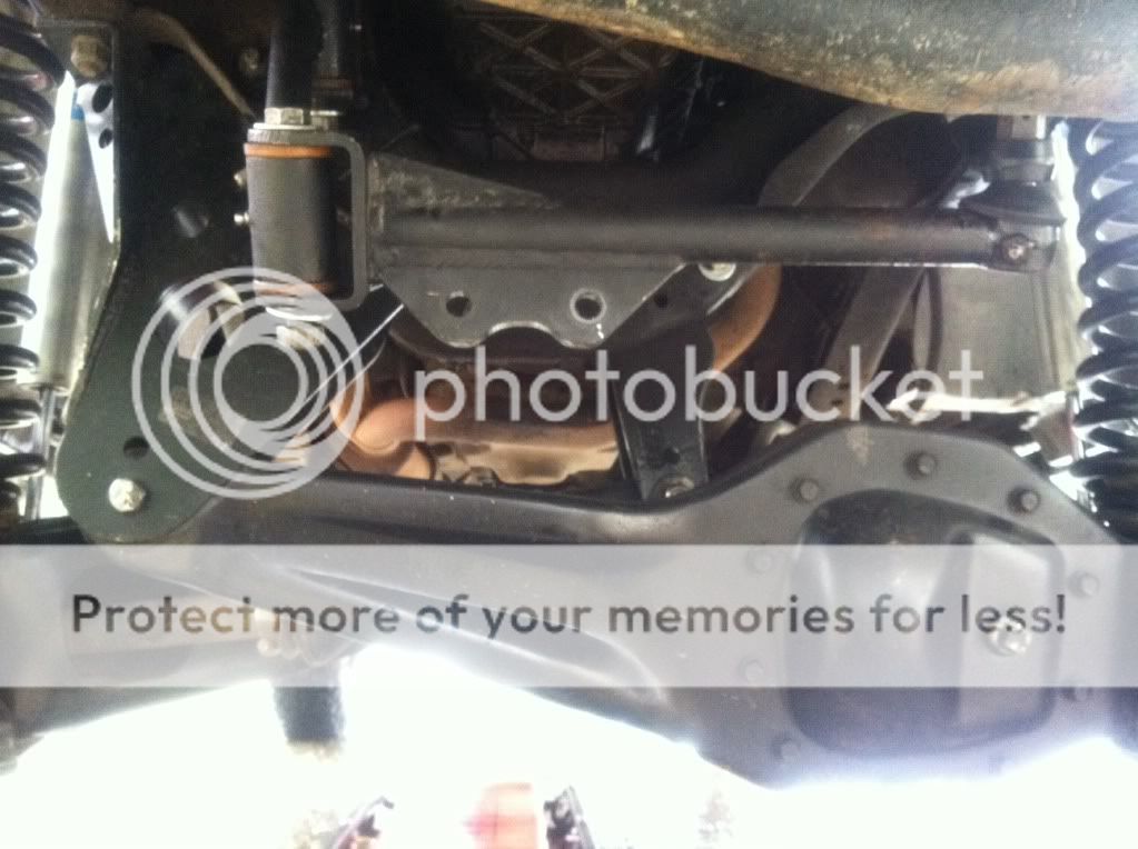

All ready for WFO to make tie rods on Monday, and when I'm there I need to buy a right-hand threaded regular chevy TRE.
Monday afternoon I hope to get the tie rods on and all the loose ends tied up, as well as make an appointment for an alignment Tuesday in the evening.
My tap didn't get here this week, so when it arrives I hope to take the centerlink off and tap it for the new RBV TRE I bought.
Not going to modify the centerlink down just yet, I want to see how it drives without the drop. Plus I don't have time, I only have Monday off from work and it has been raining all weekend, and I won't be able to work on it tomorrow. Maybe next weekend I will continue the centerlink mods...
