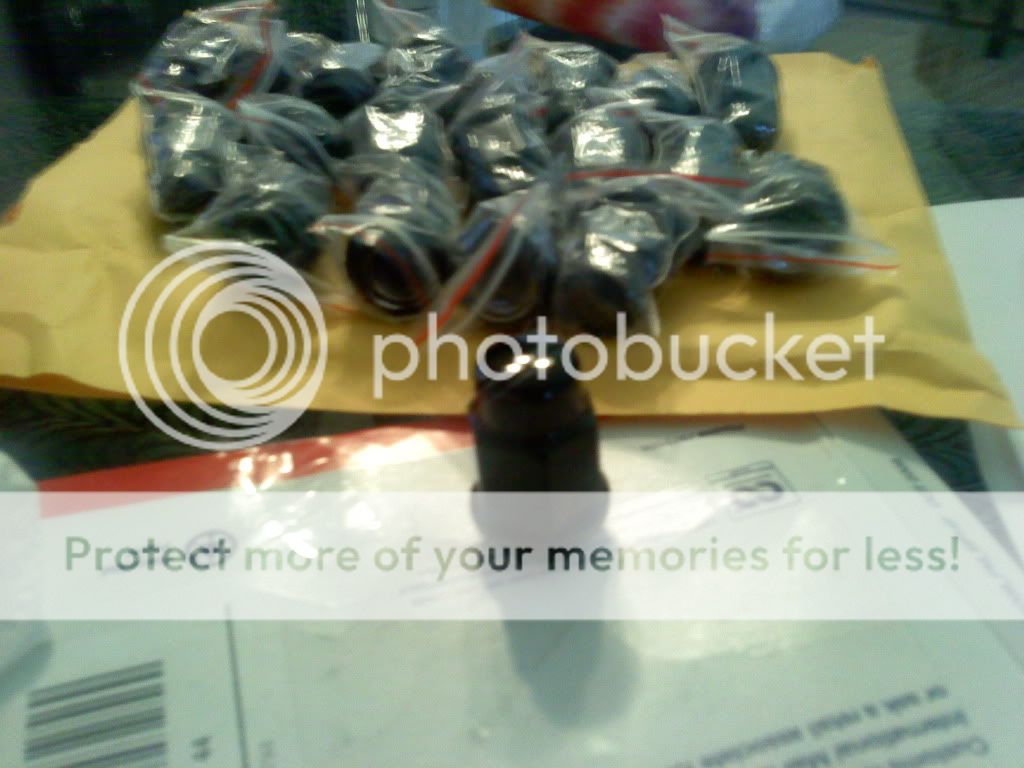

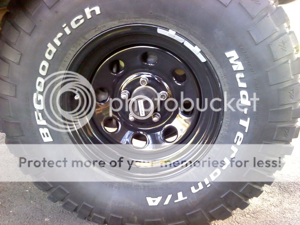

Got the lugs on today:
Now, what to do with that gawdawful chrome rear bumper....
Looks good! :icon_thumby:
I remember when I got my black lugs from 4 wheel parts and they were too short :annoyed: and the ends snapped off a couple of the lugs! Then they sent me the right ones for free :D
where did you end up getting them. I need new ones mine are rusty stockers.
Ebay, I can't find the listing now but search for 1/2-20 Black Lugs
