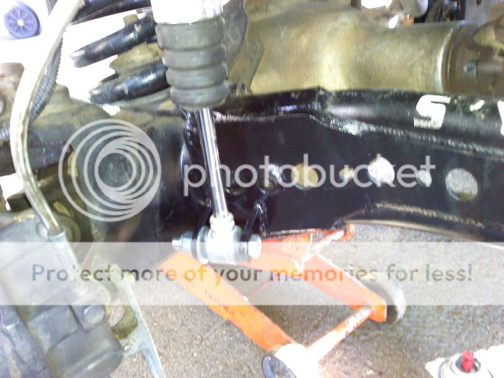

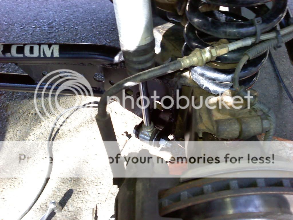

One of the lower shock bolts on my front Bilsteins rattled loose on a long stretch of road while at Moon-Rocks. Luckily the shock didn't get damaged and a friend of mine pointed it out before it did.
So I welded on new lower mounts :icon_welder. The new mounts put the shocks at a better angle in relation to the James Duff coil bucket top shock mounts, and puts them at perpendicular to the frame. Also, now the shocks have more up travel, and utilize more down travel for when the suspension is at full droop. Before the shock almost bottomed out at full compression, and had 3" of down travel at full droop. But now it has plenty of up travel, and comes to 1.5" left of down travel when the suspension is at full droop. Long story short a shock that was too long, is now just about perfectly suited for the situation. All with less binding angles at either extreme.

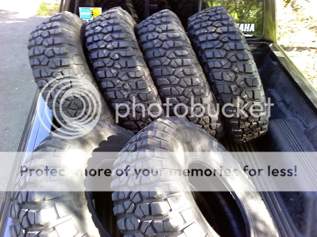

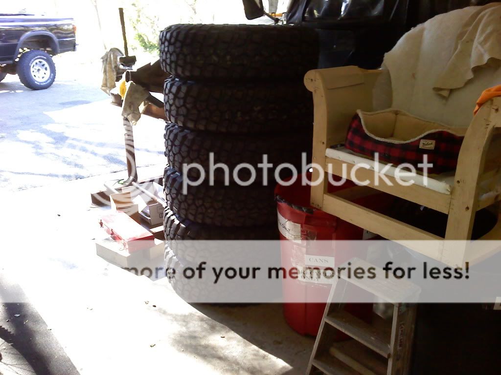

Also, gonna go look at, and hopefully pick up 6 almost new BFG KM2's tomorrow after school, meaning I'll be ordering wheels here pretty quick.

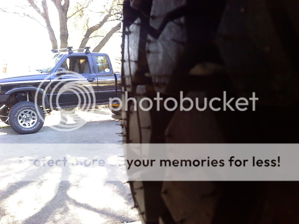

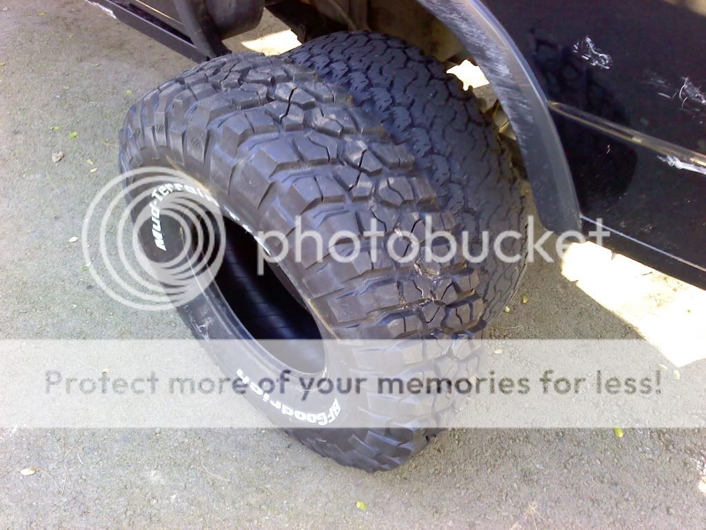

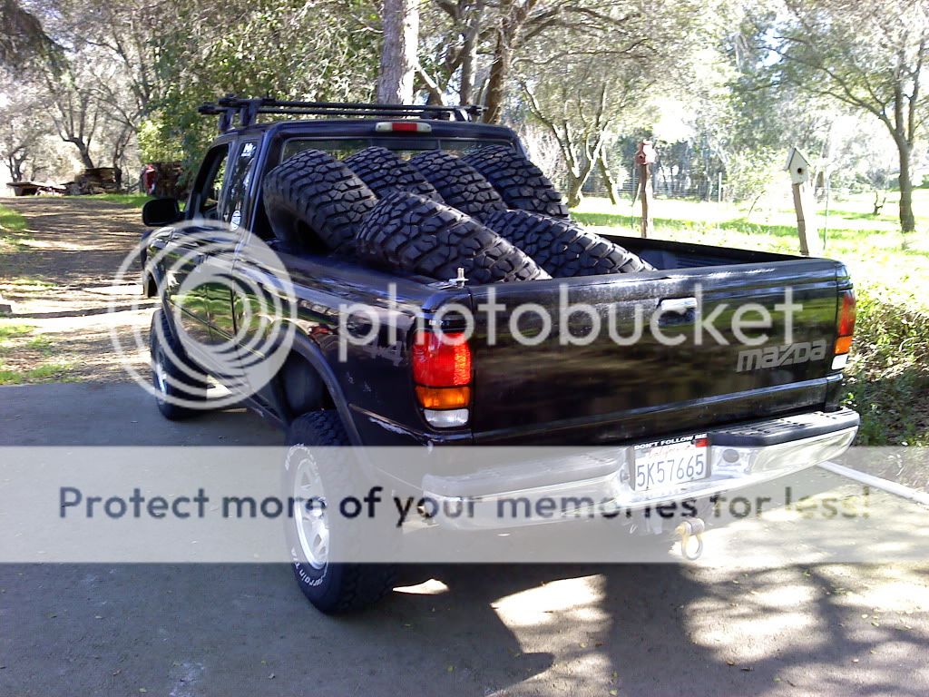

Two are literally brand new, never mounted and never seen road. The other four are basically new too, minus maybe 1% of tread. Notice the rack rash aquired at Moon-Rocks over the weekend in pic 1 & 3. Also notice the chevy D44 my dad is building for his CJ-5 (his goal is more beef and highsteer). 4wheel runs in the family....granpa even had a modded out jeep when my dad was my age.

nice, finally bigger tires......lol. i think it's gonna look a lot better (not that it doesnt look good now)
why 6? that just the deal you got?
are you mounting them before you get new wheels?
The guy I bought from had six from his prerunner, and didn't want to sell me just 4, so I ended up with a set plus two spares....I'll get alot of miles out of them this way :icon_thumby: I didn't go hunting for 6 tires, thats just what I ended up with...can't argue with that lol.
No, I'm waiting till i have some new wheels before mounting them...I'll order today or tomorrow. Maybe by next week it will all be on the truck.
