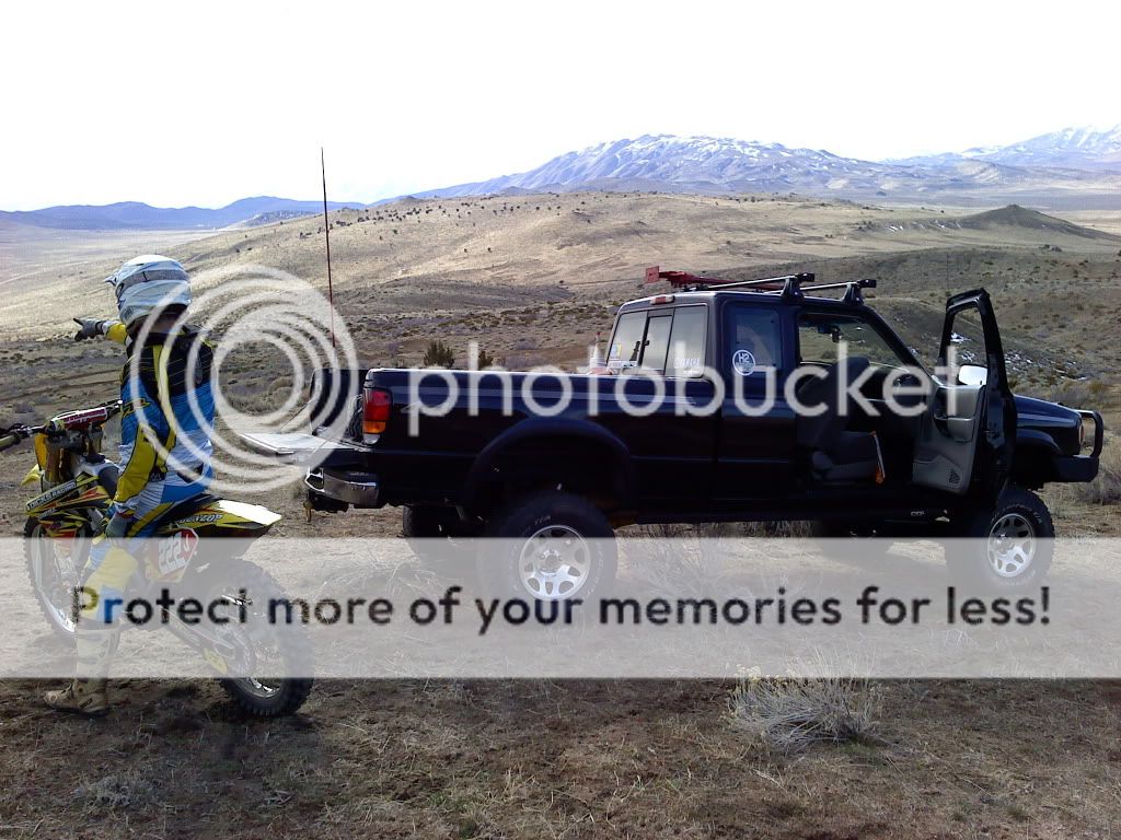

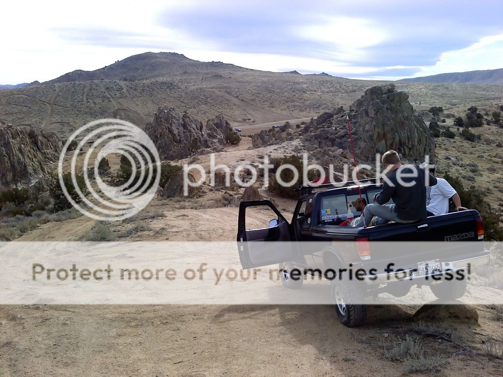

Few Moonrocks pictures (I'll have some more later):
Project 4x4 Commuter Mazda
that's a cool looking place.....i'd love to go out there and do some 1000 yard shooting
No body damage from that? Looks like some cool terrain
Wrong haha. I scraped the very rear of the bed, bumper, and tail light.
I made out very lucky considering the situation....nothin a little sanding & glossy krylon can't fix.
I worked the BFG's hard on the rocks too....let out to 15psi and just drove on all the surfaces of the tire lol. Since they won't be mine much longer i figured i'd get some good usage out of them. BFG A'Ts actually do very well on dry rocks. Different story thought if they are wet/slick.
