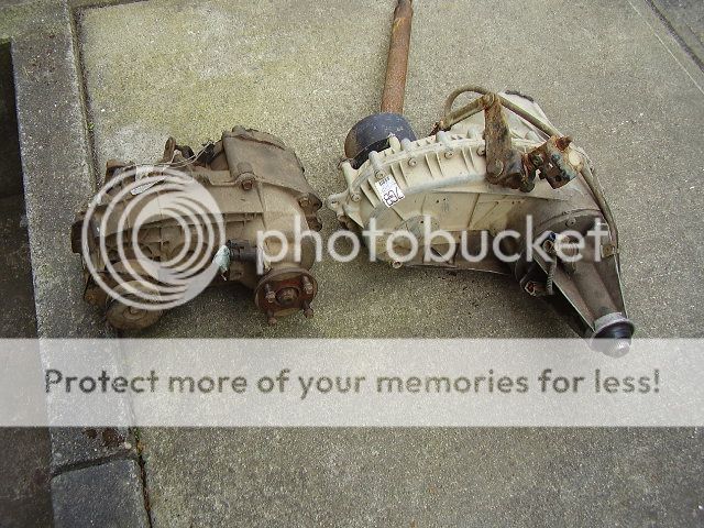

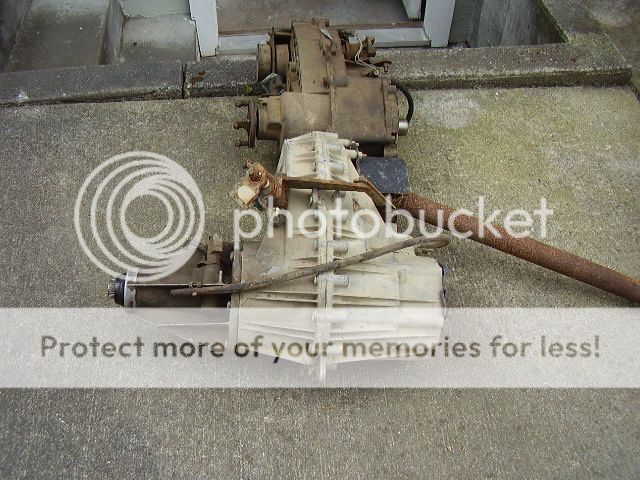

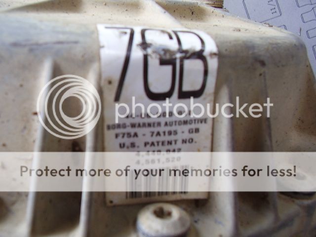

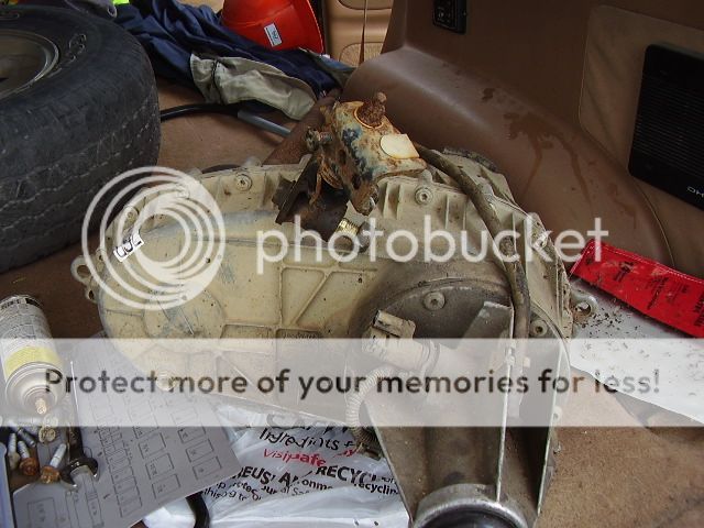

Picked up the 4406 T case tonight. Unbolting it from the trans in a downpour sucked but I got it complete with shifter mechanism (less the actual shifter) and the F-150 front driveshaft for $300. Compared to the 1354 I have for the Bronco II - this things huge. :icon_thumby:
I'll take a pic or two tomorrow.
Here ya go:
Another couple:
Thing hanging over the top is the shifter mechanism. I don't think the shifter itself will be hard to find (or fab, if necessary).

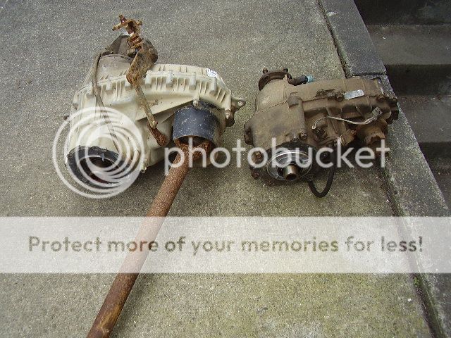

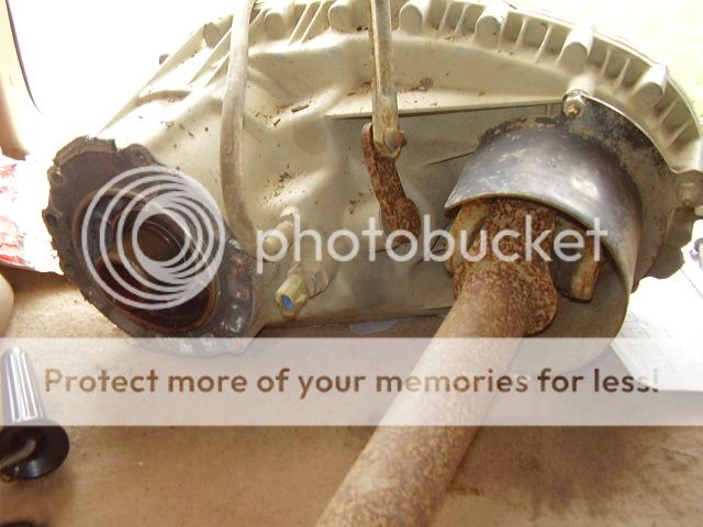

Think you could take a couple measurements for me? I want to see how much bigger the 4406 is than the 1356. Could you measure the from the center of the input shaft to the center of the front output shaft, and from front mounting surface to the end of the tail shaft, and the width of the case at the widest point?
Sure thing Dieseldane,
First off the 1356 full size truck transfer case is wider. My comparisons are with a 1354 '93 Ranger case. (Comment from Explorer forum: http://www.explorerforum.com/forums/showpost.php?p=2070439&postcount=230 )
These measurements are probably not perfectly accurate but will do for comparisons. front mating surface to end of tailshaft housing: 21 3/4".
Center of front input shaft to center of front driveshaft 10 1/4"
Overall width 22" (could be trimmed though, as there are cast lugs on either end.)
'97 BW4406 next to '93 BW1354.
