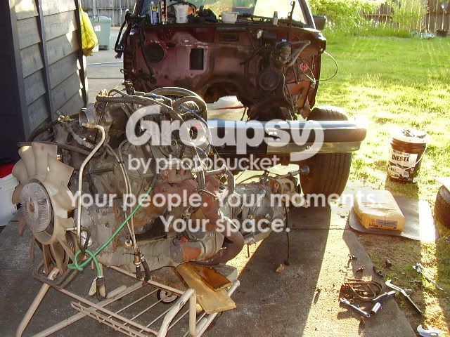

Things you can lol over: The bottom of a shopping cart I'm using as an engine stand. I also already have the exhaust, starter and T-case shifter installed. The bag of cement powder beside an already heavily stained concrete floor. :icon_rofl:
