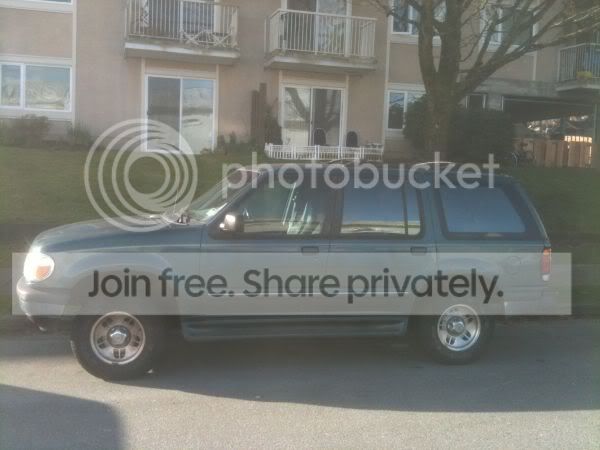

This thing has been built by Craigslist, btw. Yesterday I scored a '96 Exploder with 201,000 km on it for $500. Its triple green in ugly but runs well so the 4.0 will replace my current 2.9. The BII was a $500 bill come to think of it. Add that to some other collected parts and now: Its on. ;)

The "organ donor":
Prerunners B II under construction (finally!)

Too bad the Exploder has an even more attractive green interior. :bawling: I would like to swap the dash though...

Picked up the '96 Exploder tonight. Tranny is acting up, seems to go into neutral while upshifting. RPM's spike about a 1000 up, depending how hard I'm on it. Does anybody know what this problem is?
Thanks in advance. :)
Edit: Doing a little research on TRS and it kind of sounds like the infamous 'leaking valve body gasket' in the 4R55E. Can't say I'm looking forward to it, but not something I can't do.
