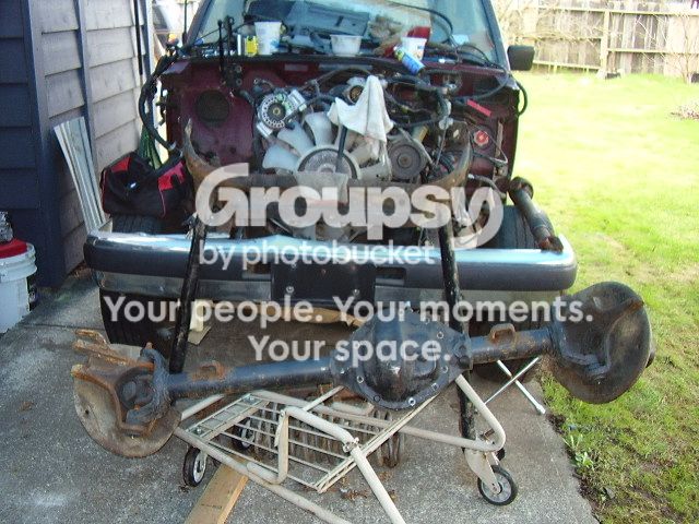

Edit: I think the radius arms are Skyjacker RA-135's. Crossmember is factory stock. The suspension brackets are stock (zero lift). The coils are longer, as are the brake lines. Wtf is this?
Edit Feb 9: A mix n match lift kit. Probably good for 2 - 3 inches of lift with messed up camber. The good part is the Radius arms. Still worth $150.

Now depending on your point of view, this is either a decent find for $140 or a total abortion. I haven't found the BOM # on the housing but seems like an early Bronco 44 with Chevy outers (even the flat top spindles that convert to high steer). Missing the short side inner & outer axles, calipers and tie rod. Oh, and the one spindle has a mess of welded crap on it. Hubs were disassembled but included.

Also has 4.10's with an open carrier inside. Looks to be a pretty good fit for the B-II. What would you guys recommend for leaf springs for this?

That looks to be a jeep wagoneer Dana 44 since it has a 6 bolt hub. I went with some rancho 44044 springs for my front, they give a pretty good ride and flex decent.
I hadn't considered that it might be a Wagoneer axle. I'm going to have to peel the paint off the axle tubes to find the BOM. I'll need the info to find or order missing axle shafts.
The spindles have the old style Chevy disc brake mount which makes me think they're Chevys. The guy I got it from said the axle was a "70's Ford" but he got it from a buddy who'd mocked it up under an S-10. So really, who knows?
Pretty cool Ranger by the way, Ford78 and yeah, it flexes pretty well.
Found the BOM #. 603368.7 . Referenced it at http://manuals.forever-ink.com/Dana_BOM.pdf (shows all Dana BOM codes from 1967 to 1978): 603368 - Ford - 44 - Front - 1973 U-100 Bronco
This is good news and bad news. Good, I know what it is now and it is upgradeable. Bad, its one of the weaker versions of the 44.
Decided to stay with Chevy spindles though I'll replace the right side one. Brakes, outer shafts and locking hubs are strong but cheap. I'll convert to F150 hubs and rotors to get back to a Ford 5 on 5 1/2 pattern. I have wheels for that.
