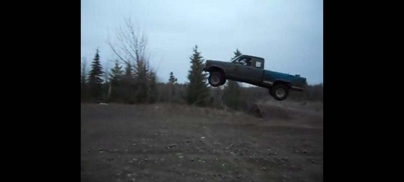

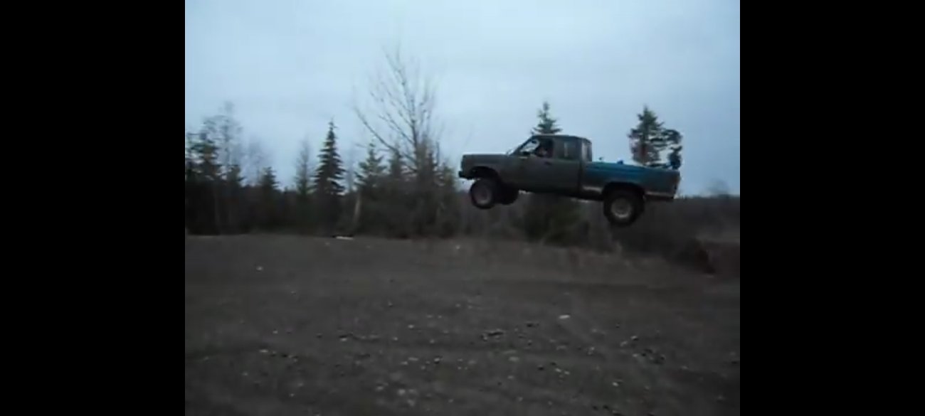

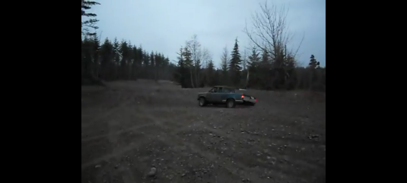

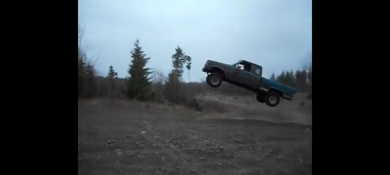

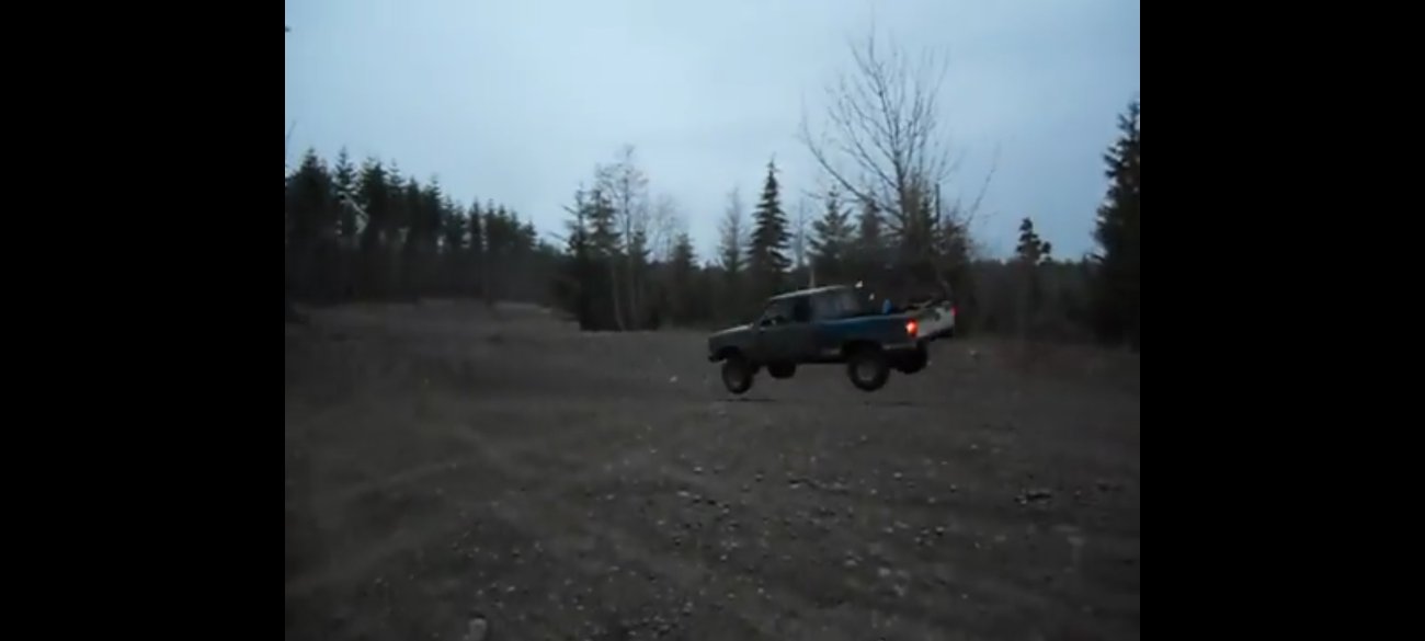

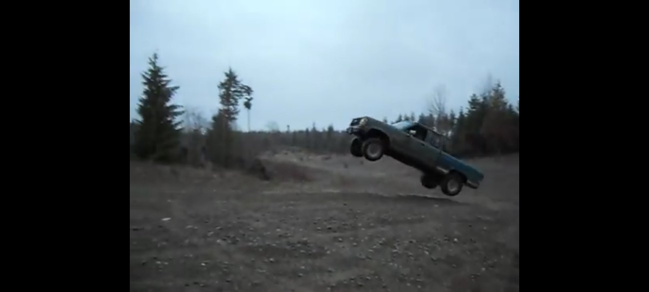

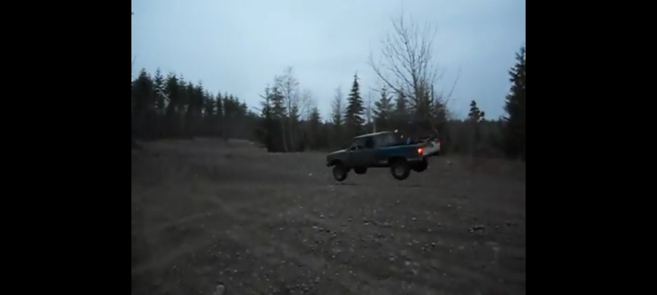

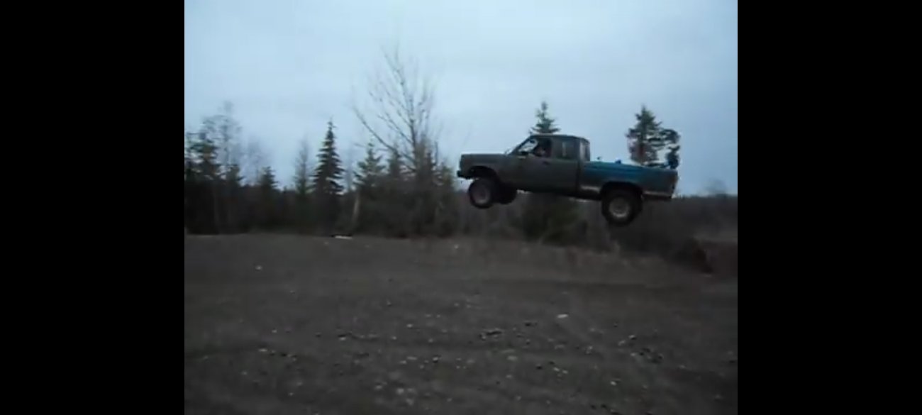

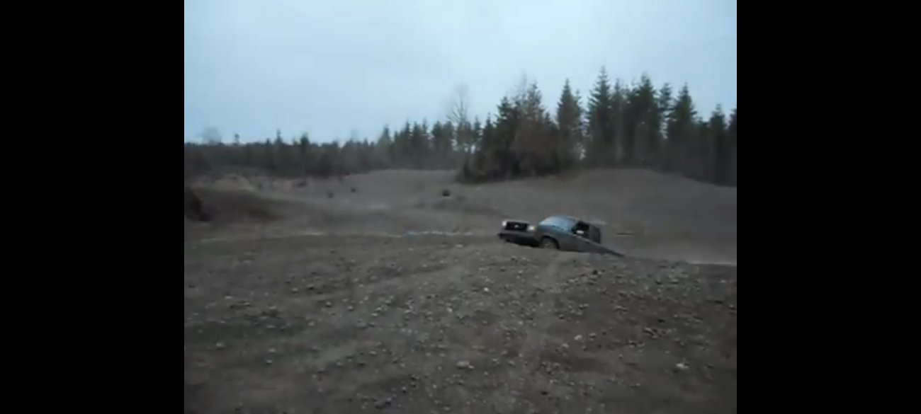

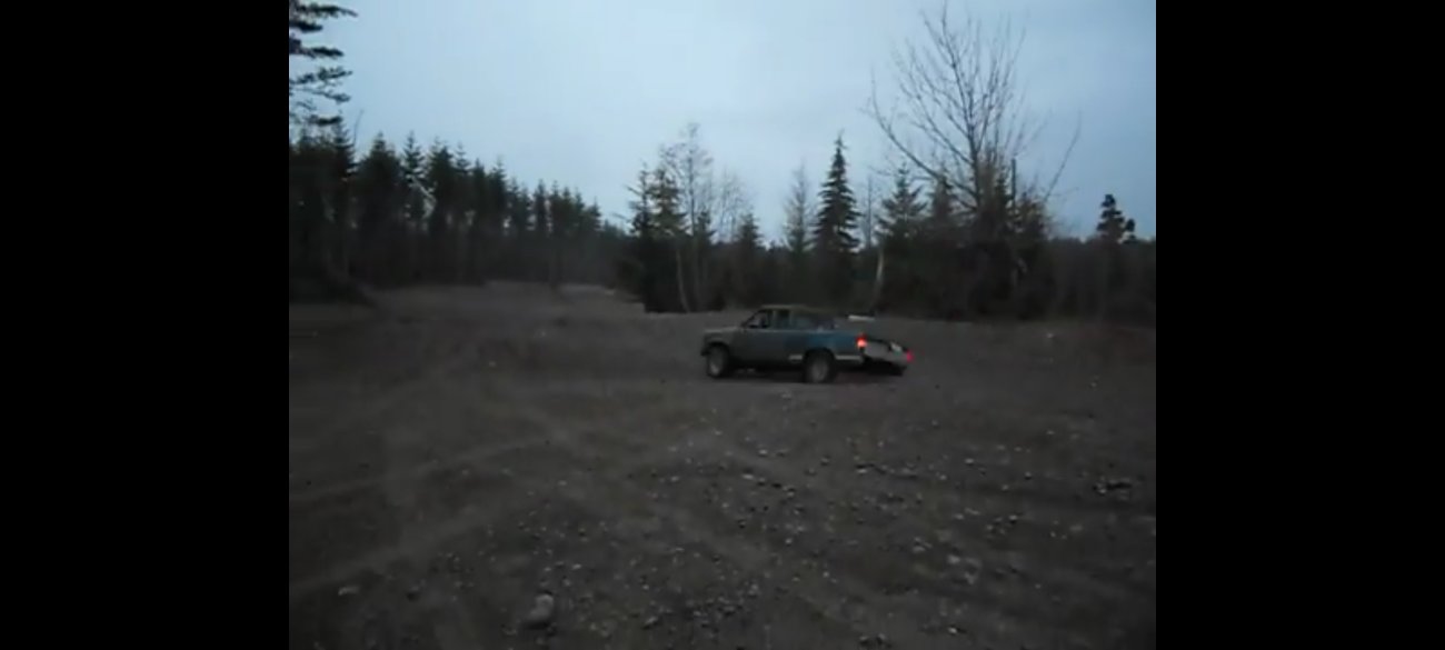

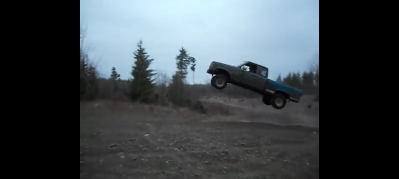

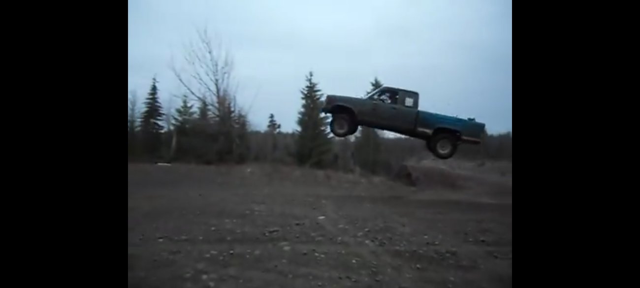

1992 Ford ranger 4.0 5 speed 4wd ext cab w/Dana 35 TBB (front drive line removed) with junk yard built pre runner under $500 for parts. Now Check out "Buckley Rangers" on YouTube 11 sec video. 1992 Ranger with 75-85 can't remember F250 coils, buckets, shock mounts x4 ,(remove the sway bar and install the 2nd shock there, frame has 3 of 4 holes already dilled for forward shock mounts) 32x10.5x15 tires. 8.8 disc brake open rear end, welded. Did not get to the spring over conversation yet. With explorer rear shocks.

Yeah boy...
Did the cooler fly outta the back?
