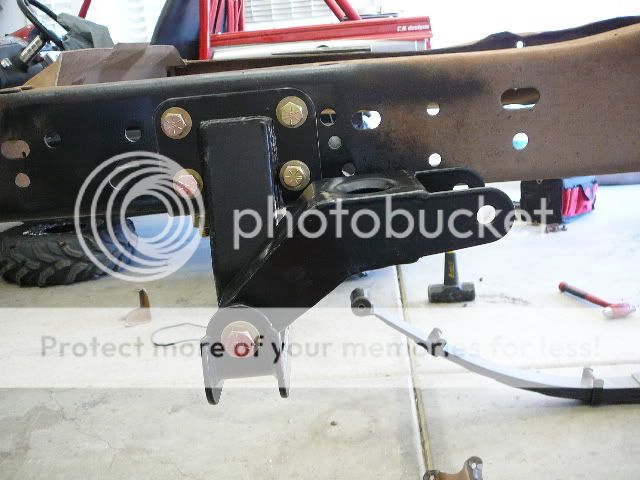

Got pics!

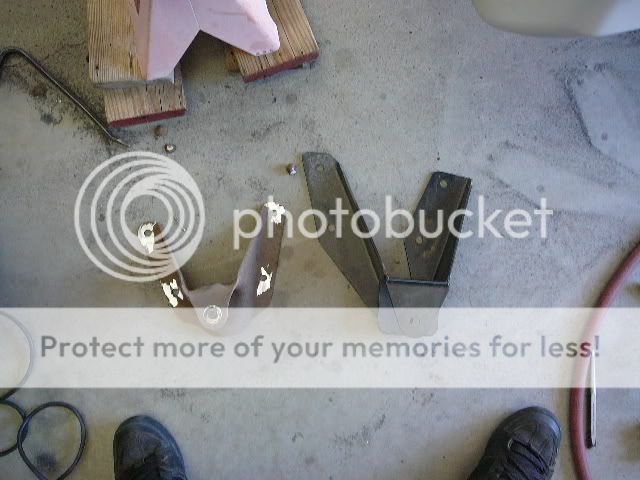

here is the difference between the stock hangers and Giants
Prerunner project: F.O.R.D.

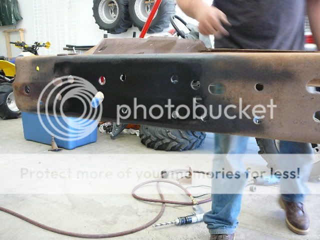

Took all the rivets out. acutally was very easy to do.

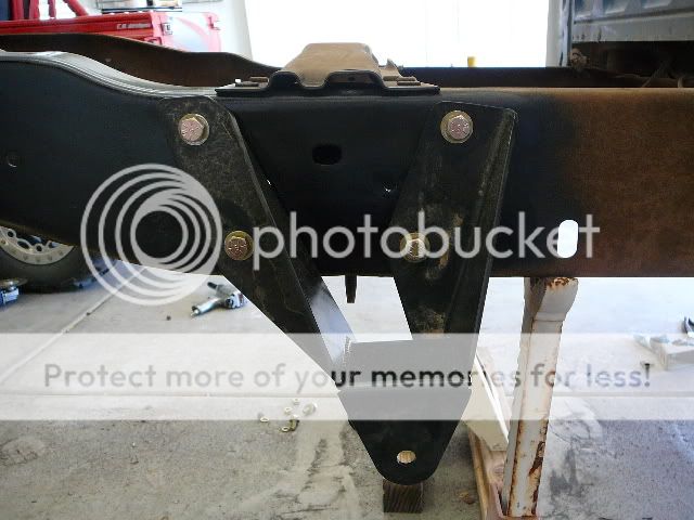

paint and hanger on

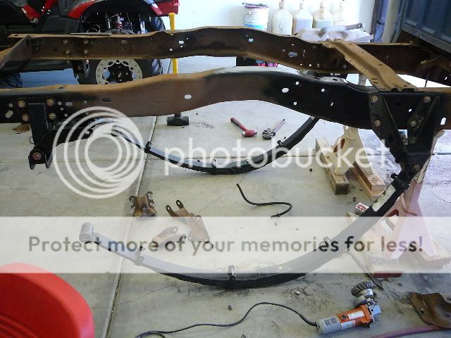

Shackle and shackle hanger on (drilled out all the holes so they accept 1/2" hardware)

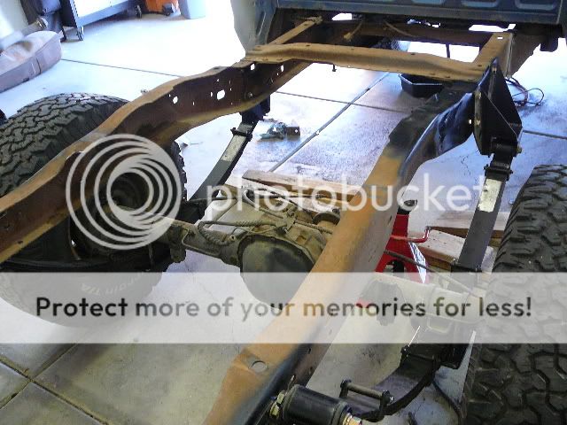

Springs on!

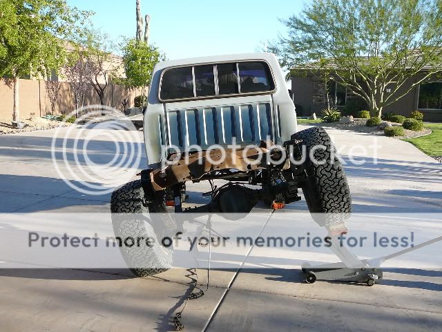

Rearend together

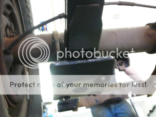

The spring plates giant sends, super trick to keep rocks from bending the U-bolts
Little flex, has alot more left but needs full race weight to do so :D
Overall the job was super easy. I just cut the heads of the rivets off with a cut-off wheel and hit the old parts off with a 10lbs sledge, then punded the rivets back though with the sledge :icon_welder:
