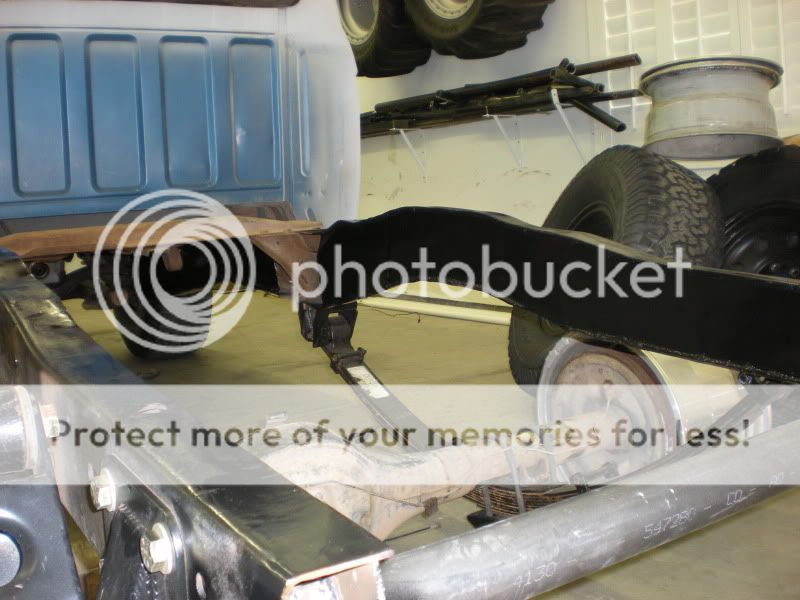

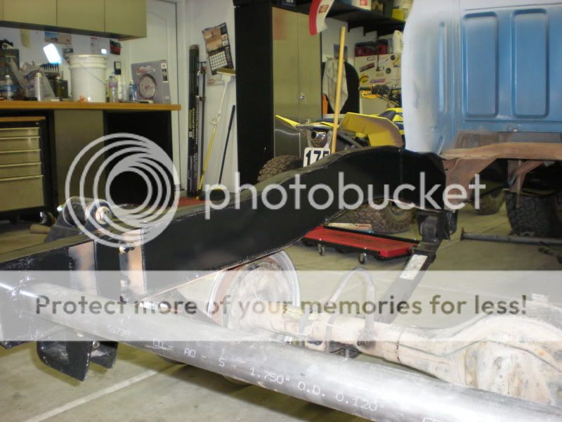

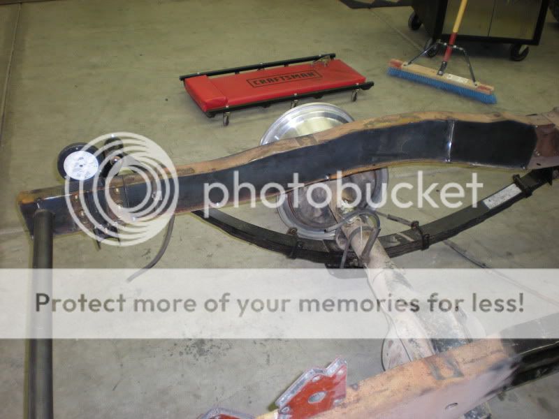

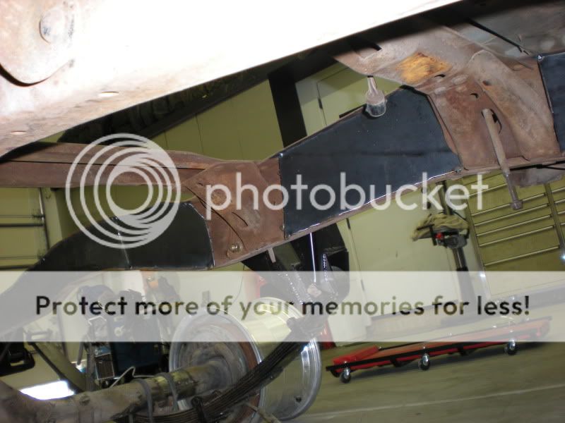

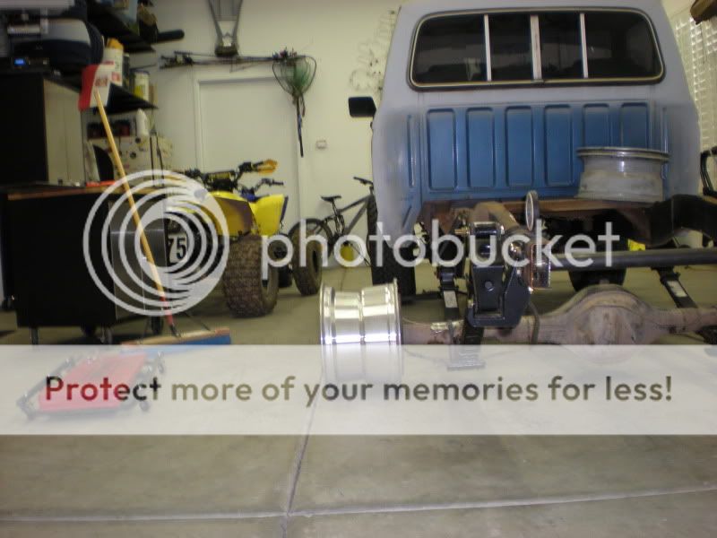

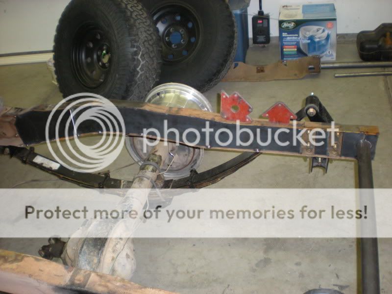

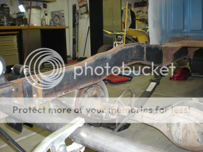

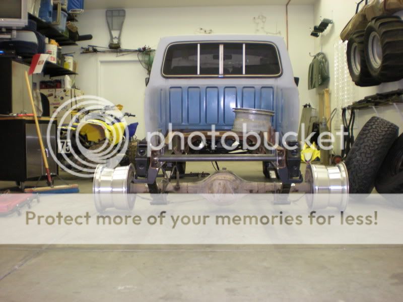

ok. took my week off work and got alot done on the ranger. Put the new 9" under (man, you talk about a huge difference from the 8.8 to the 9" lol) and aslo finished boxing in the frame front to back. I was gunna start puttin the front end kit on but i still need to get hiems for the beams. here are some pics of the progress. from here everything should start movin a bit faster. Keen eyes will notice i also straighten the rear part of the frame that was bent when i bought the truck

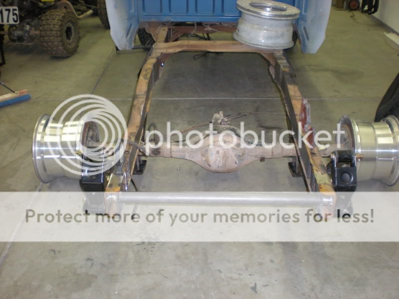

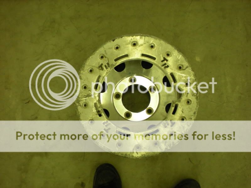

These are the beadlock wheels ill be runnin, from my dads rockcrawlin jeep. They were free so why not?? lol
The 9" baby, needs a rebuild, 5.30 + gears, and a spool :D

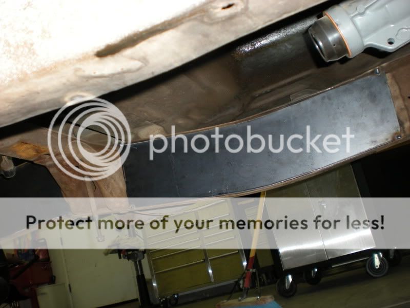

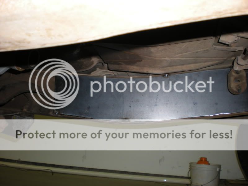

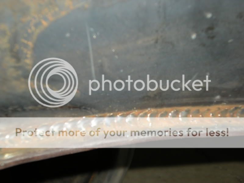

Got all the plate in and tacked in. Man im glad i got a plasma cutter :icon_welder:
all welded in and painted to keep from rustin outside.
Im now ready to get the front end in and start on the cage. Time to start the fun stuff now! :icon_bounceblue:
very Nice. I cant wait to get back over there and see this thing in person. O and there is no way you are getting your old tires to fit on the new rims.
And I'm glad you are able to use that 9' and the 44 kuckles. and if you need some help give me a call.

those wells look wicked wide. How wide are both sets of wheels. O and when we get a chance I would like to snag up those Wheels when we get a chance.
they are just a 10" wide wheel. the ones on the rear end in the pic are not the bead lock ones. the beadlocks are 8" wide. Those other ones will be used for my spares. Ok, i wont be back to phoenix till the 19th and ill only have two swaped by then. I should have all four for you at the end of the month if that works
so you are making the front equall wide as the back? i figured it would look silly. quick question, if other guys are running 4liter or bigger engine, how is your 2.8 gonna compete? especially with big tires and sand? that all just dont add up.
