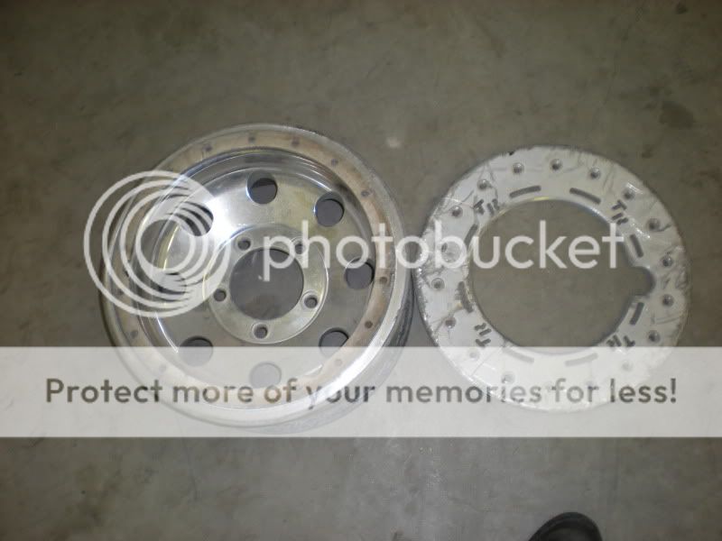

ok so im new at the bead locks thing. do u need to get special "beadlock" rims to put those plates on them?

As an update and recap to the build, 9" is under it waitin for a rebuild and some upgrades, tires and beadlocks are on the rear, Ordering all the heims next week for the threat kit i have as well as the ball joints to put the d44 ends on, Will be makin the stock steering work for the moment till i can buy the rest of the front swing set steering from dave, After that rear shocks will be ordered or bought used, then ill need to get a fuel cell and move onto the cage for the truck. when the cage is finished things should really start movin quick :icon_bounceblue:
